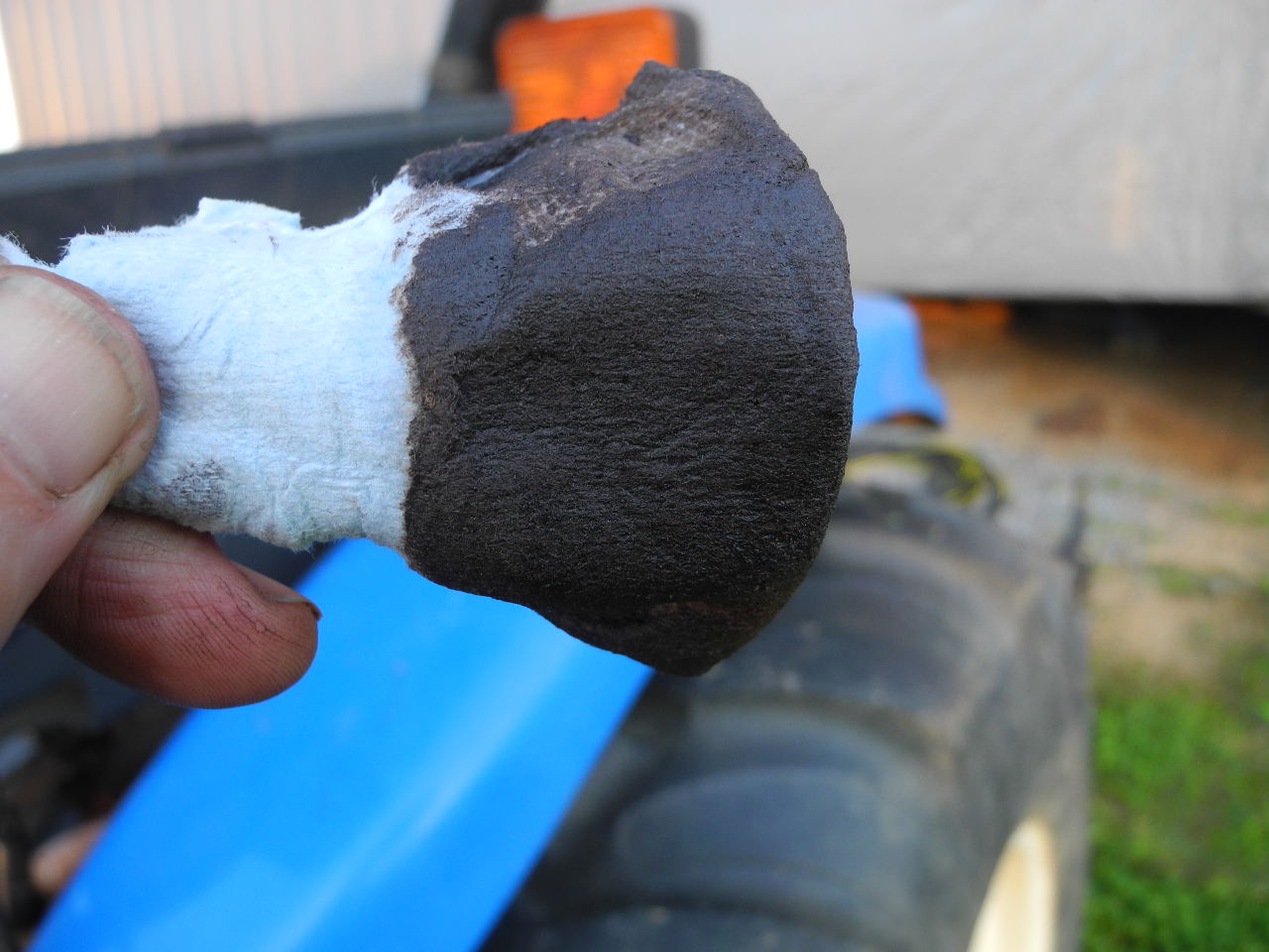

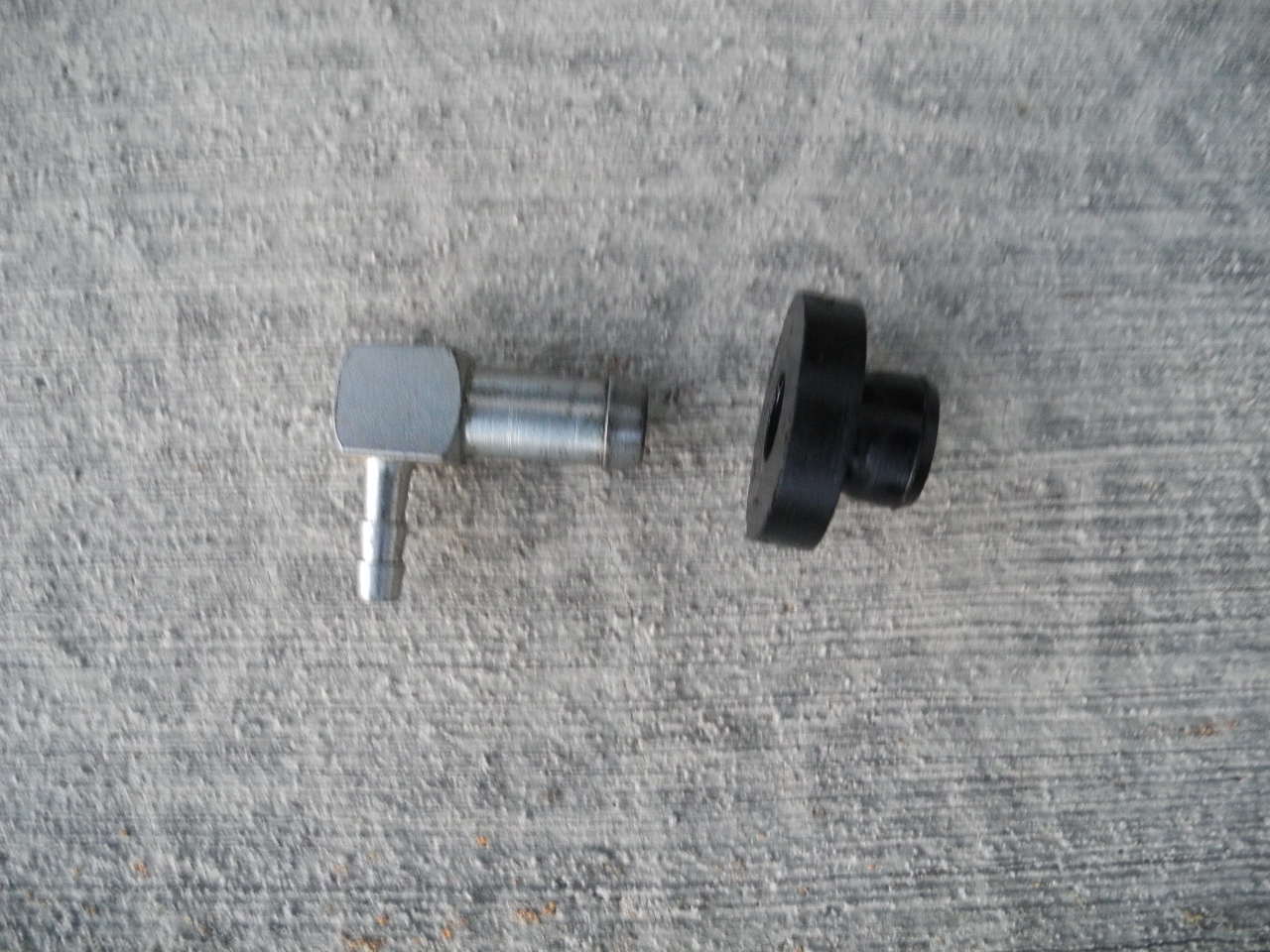

1. There is no filter or screen. You grasp the hose filling and pull it out. It fits inside a rubber grommet. Pull the hose fitting out and reinsert the grommet.

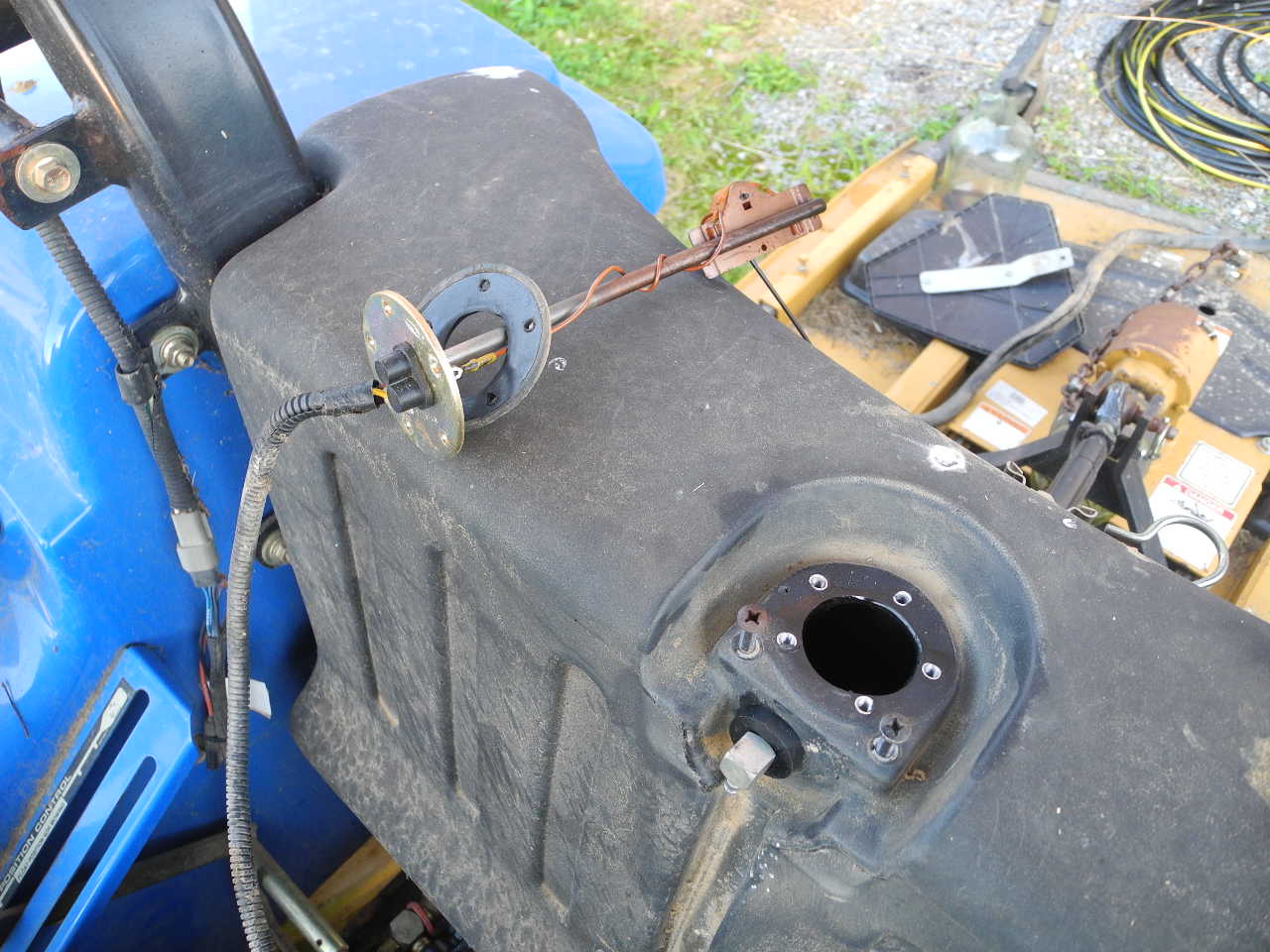

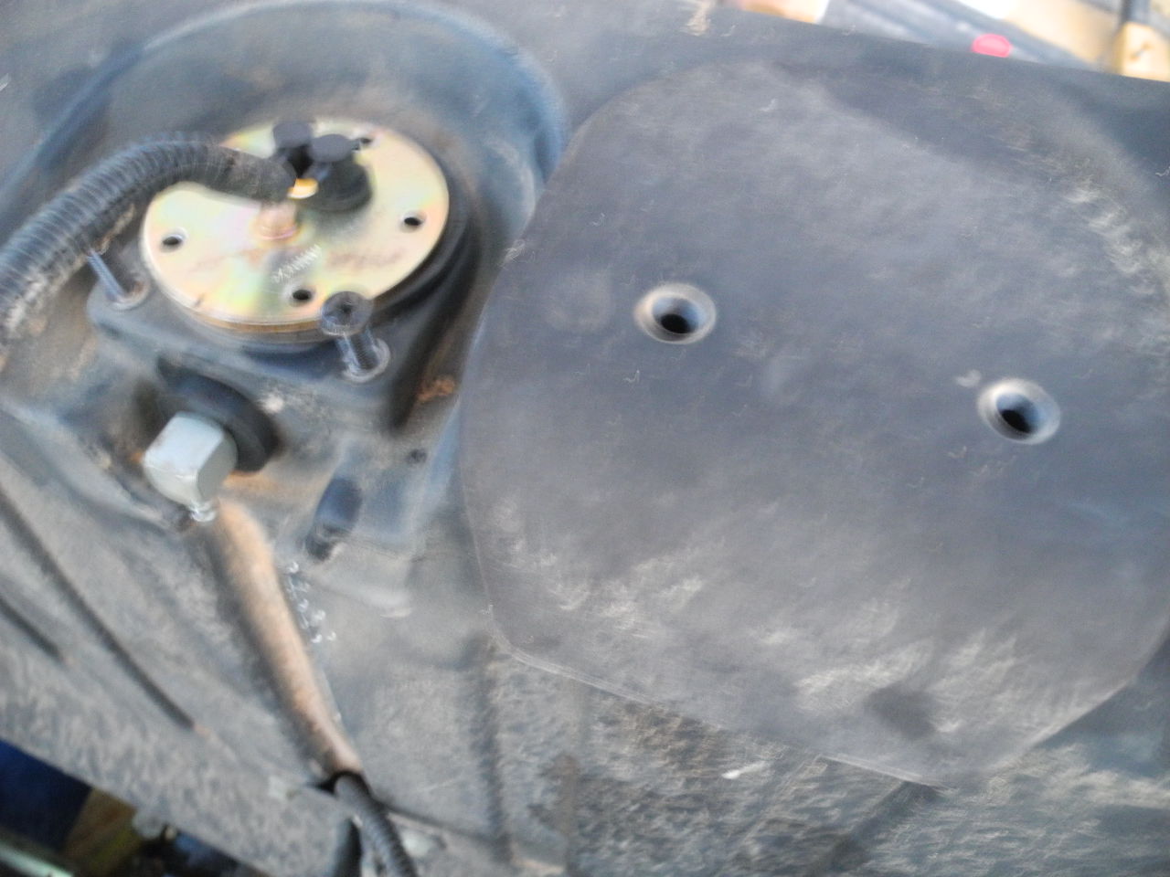

2. Remove the 2 phillips screws on the cover plate. Disconnect the fuel sender at its connector underneathe the seat, remove the 5 phillips screws that hold it in and remove carefully.

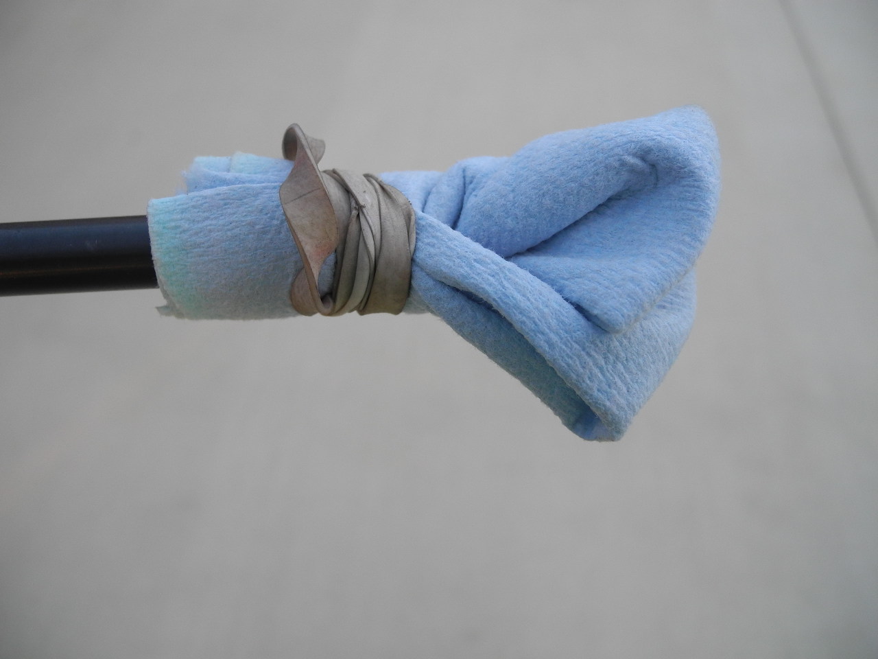

3. I don't think it is necessary to remove the tank. The fuel sender hose opening is large enough to inspect. I made a swabbing tool using a 24 inch drill bit and a shop towel attached to swab it out then flushed with a pint of clean fuel.
Hear are some pictures DSCN2532.JPGDSCN2533.JPGDSCN2534.JPGDSCN2539.JPGDSCN2540.JPG
Picture Quality could be better but its getting dark. Tank was pretty clean for an 11 year old tractor.

Thanks for the reply Jim. I agee with you, if it ain't broke, don't fix it! However when I removed the hose and drained it it dad a large amount of black residue that came out. I inspected the hose and it was cracking badly on the inner liner. When I swabed out the tank it was full of a black film.
I have since learned that hose rated for gasoline is not necessarly OK for diesel . So far NAPA is the only one that has it in stock. Oreilly, Auto Zone, and Advance have said no to diesel fuel. If anyone out there is using Bio-Fuel it is especially agressive.
