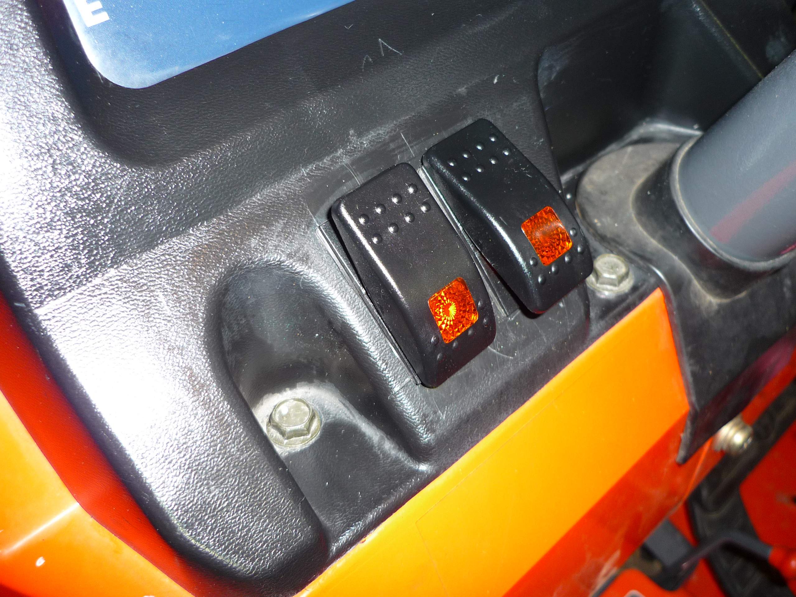

I want to remove dash to add switches for LED's. I can not figure out how to remove dash. I've removed two bolts that I can see one top center and one bottom center, can't find any other bolts to remove. I don't know if there are clips or what else is holding dash from coming free, don't want to start yanking on it and brake something. My WSM is no help.
I'm also open to any ideas for mounting switches else where.
Thanks Mike

I put switches for my LED lights at the back of the tractor in a small watertight box. I started a thread about it here:
http://www.tractorbynet.com/forums/kubota-owning-operating/299822-l3200-work-lights.html?highlight=
The wiring for the work light circuit is in the rear left fender anyhow, so that's the easiest place to pick up the circuit, add switches, and then run wiring to lights mounted on the ROPS. I understand the appeal of having dash switches, but that would involve going way "around" the existing setup for work lights on the tractor, especially if they are mounted on the ROPS.

If your L3200 is similar to my L3400, there's enough room to cut from the top, (after carefully looking up from below with a flashlite!) to install switches without pulling the dash off. It's plenty open to below to install wires, etc. By the way, the steering wheel will come off by removing a nut and pulling it carefully- not that hard to do- no airbags to worry about. By all means, use the factory installed wires for rear work lites- just know they aren't switched, just wired off a special fuse circuit which you can interrupt with a switch or switch/relay if you aren't using low wattage LED lights.

You need to remove the 2 grey panels below the hood. They cover a bolt on each side. The bolts point across the tractor at each other. Just on the engine side of the dash just under the grey panels. There are 2 bug nubs on the dash cowl that slide through the "firewall". The 2 aforementioned bolts secure these nubs. There is a bolt over the tach & under the steering wheel.
Remove the steering wheel cap & unbolt. I had to use a gear puller to pop it free. I pulled the cowl off without removing the handle on the throttle, but removed it at a later point for further fitting & reinstall. Think I had to put the throttle at max too.
There are 3 plugs if I remember. 2 bigger ones with wire on both sides so you have room to maneuver. The plug on the hazards is a pain & I could never get it. I just squeezed the top & bottom of the switch to pop it out of dash then disconnected it.
