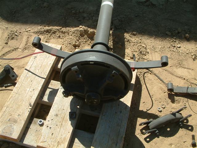

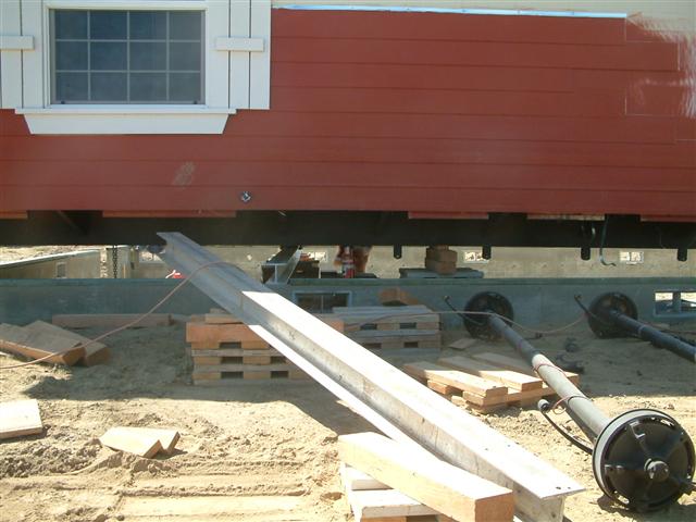

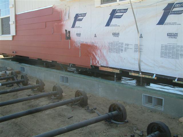

Here are the axles used for my doublewide delivery in Sep05
   / How to recognize manufactured home axles? #10
Many other threads mention MH axles having the brake backing plate welded to the axle instead of bolted to a flange.
