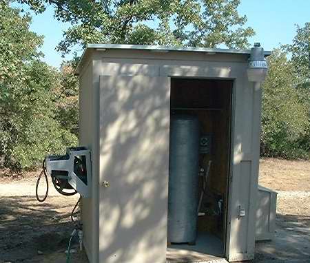

Well for an 8X8 I would just make a flat type roof. Here is a picture of one of my well houses it is 8x8 8ft on one side and 7ft on the other flat roof. whole lot easier to build.

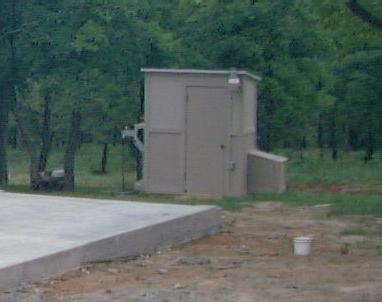

   / How-To questions - pump house #5
Jim, your wellhouse is almost a "dead ringer" for mine, including the flat roof. Some of my neighbors joked that it looks like an outhouse, but I don't care. It works great and the assembly was very easy.
Now if style is a consideration, the possibilities are endless. My well driller just suggested that the main part of the wellhouse not cover the well. I just put a little "doghouse" about 2' square around the wellhead with an opening into the main wellhouse. That way if the pump ever needs pulled, the main wellhouse can stay in place and only the little wellhead house will have to be moved. I even screwed it into place for easy removal. After 6 years, everything is fine.

My wells are actually about 50 ft from my well houses. I just keep the pressure tanks and controllers, control valves, ect in the houses.
