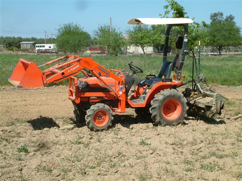

Nice place. Nice pool.
What kind of grass did you plant?
I'm landscaping my new place now. Here's my recipe:
Mow the weeds as short as possible (used my riding mower and weed whacker for this).
Hit the weeds with Roundup, wait 2 weeks
Plow the lawn areas with a middle buster (and the Kubota B7510HST).
Spread fertilizer (13-13-13).
Rototill using the B7510 and a 48"-wide Yanmar RS-1200 tiller (two passes at right angles). Plowing first makes it easier on the tiller. I was pleasantly surprised that the tilling left a very level and neatly pulverized seed bed ready for planting.
Spread tall fescue seed
Rake/drag to cover the seed.
Water like crazy.
It's been 3 weeks and the fescue is now starting to show up.
