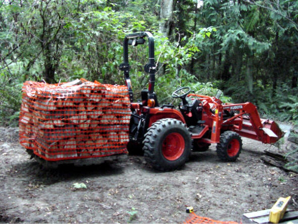

Dwight,
I palletize all of my firewood now. I move it with 3pt forks on my Kubota B7500. I have attached a picture showing my setup. I bought a roll of orange plastic security fencing and wrap each board with it. The security fence allows it to breath. It isn't that strong where you can bang the boards around, but it will stop that first piece from sliding out that starts the whole "pick up sticks" /forums/images/graemlins/frown.gif process. (Been there... Done That /forums/images/graemlins/blush.gif) I heat exclusively with wood and this has made my life a whole lot easier. Last year I put away 14 boards like this.
Hope this helps,
Greg

I like your idea and think I will take it one step further. I think I will also wrap it in bundles the right size to take into the house. Make it easier to just grab a bundle next winter when I run out to get wood. It seems it is always raining when I need it and that way both the wood and I will stay a bit dryer. Thanks for the idea -- Leo

Leo,
I would be a little concerned about shrink wrapping because the wood can't breath. Here in the NW, we have very wet winters and I see people covering their wood piles to keep them dry and end up with piles of rotten wood. The condensation keeps the wood damp and rots it rather quickly. There has to be air around the wood. I have built a tarp tent back in the woods to keep the rain off my boards. There is a lot of air around the boards and the wood stays nice and dry. Short term, shrink wrap may work, but I know around here it will rot wood in one season.
Just my .02 worth,
Greg

Neat setup.
I also heat my home exclusively with wood in the winter. Kansas winters arent real long, but they can be whoppers at times.
Anyways, I like your idea. It makes sense to me...with the snow fence tied around the pallet.
Maybe use tie wraps to hold the fence together?
dwight
