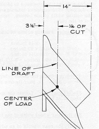

Here in the attachment is how I have always done it.

I have always seen people just measure across the beam.
   / How to measure plow size?? #5
That works also unless its a single bottom. Once in a while you will run into one where someone has put the wrong replacement parts on.
