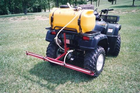

Welcome to the forum. Agreed, if you don't have a sprayer yet, new ones with boom are inexpensive these days. If you already have the tank but no boom, I've made cheap ones using small angle iron, spray tips from Rural King, and the appropriate size hose. For 48" you should only need 3 nozzles, depending on how close to the ground your boom will be.
Here is one I made several years ago. I didn't go by any plans.

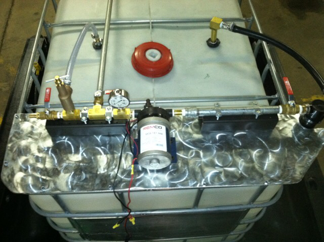

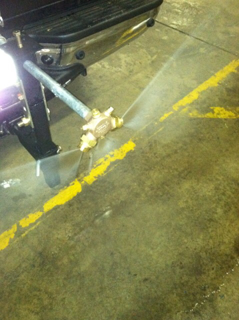

   / How To Make A Homemade Boom Sprayer #5
Here's one I made out of a 275 gallon tote. But the principles are the same. It shows how effective a boomless nozzle is. This one throws a nice pattern up to 49 feet.
But unless you already have a tank, it's probably about as cheap to buy one already assembled.

Little home made job I built. The boom is pvc and the spray solution actually runs through it. It's about 8' wide. MY only complaint is the the pvc will get to bouncing out towards the end of the boom.

Not really a problem on mine. It's got 3 nozzles: one is a standard "boom" type nozzle in the center shooting straight down, the other two shoot out to the sides: you can turn any of them off individually. I do that pretty regularly spraying fencerows, just shut down the center and one side, then just spray the fence off the other side. You could just as easily shut off the outer two and have about a 5' "boom" sprayer action.
Drift is more of an issue of droplet size than anything; I really don't have that problem with the one I've got; if there's enough wind to blow it back to me, there's probably too much wind to be spraying anyway. I do use it to spray my own lawn as well as the pastures. I went through 2 boom type rigs, now that I've got this I'll never go back..
