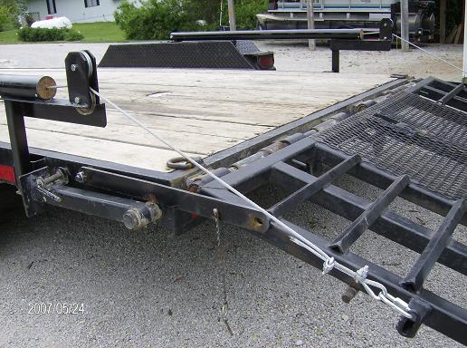

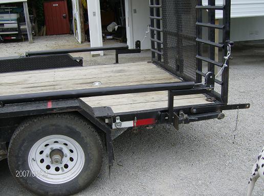

I made my own lift with garage door springs inside exhaust pipe. Garage door rollers at the back. Bear in mind, my trailer has a very heavy rampgate to handle an 8,000# tractor. Also has factory coil torsion spings on the pivot pins. Besides using the metal tubing there is a saftey cable inside the spring.

Northern Tool has spring assists that will bolt on your trailer to help lift the gate. Dont know how to post the link but their part number is 40101042G. Look at Northerntool.com for gorilla lift.
