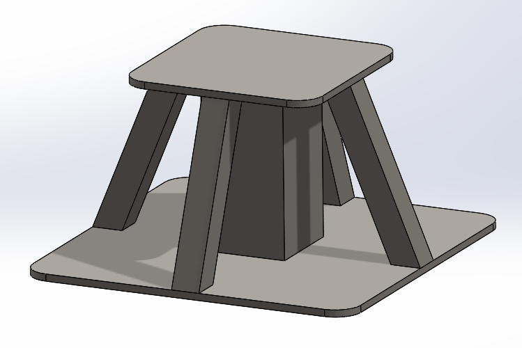

I also dug out my bottle jack this morning. It's a 20-ton and goes from 9.25" to 15.125". So if I make a 6.5" riser for it, that will give it a 15.75" to 21.625" range. Attached is a quick model of what I'm thinking. 6" long piece of 3 x 3 x 1/4" box tubing sandwiched between two 1/4" plates and then some braces connecting the midpoints of the upper and lower plate edges. Will also add provisions to keep the base of the bottle jack on the top plate (a perimeter lip or some sort of hold-down clamps). And perhaps some sort of cradle piece to go on the jack head to make sure it doesn't slip off the diff.
I'll put a nice long handle on the jack so I'm well away from things while lifting. Then chock and give it the shake/shove test like you do to a car or truck once it's up on stands or ramps.

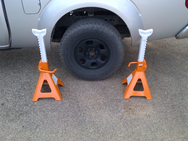

I broke out the new jack stands when I got home. They are pretty big. Attached picture shows them next to one of my truck tires, which just happens to be 30" OD.
