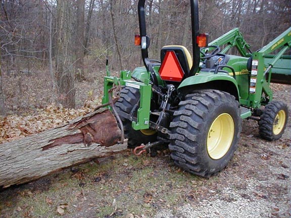

I do it by using the iMatch to carry a set of logging tongs, and the weight of the log will give traction. Care to feather the lift to match the weight on the front end (I do this with either the snow plow or the FEL attached) is important.
