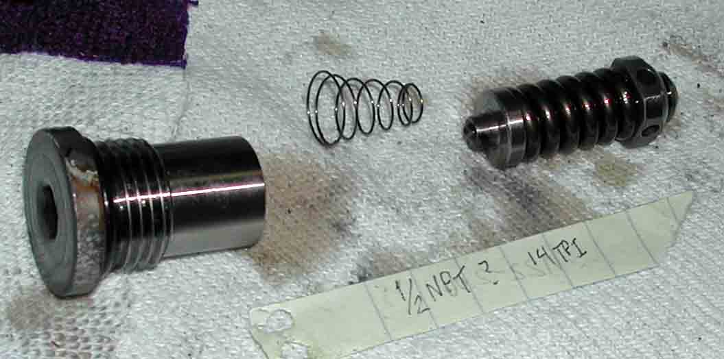

How much change in psi can a guy make before any danger, 200psi 500psi 1000psi?

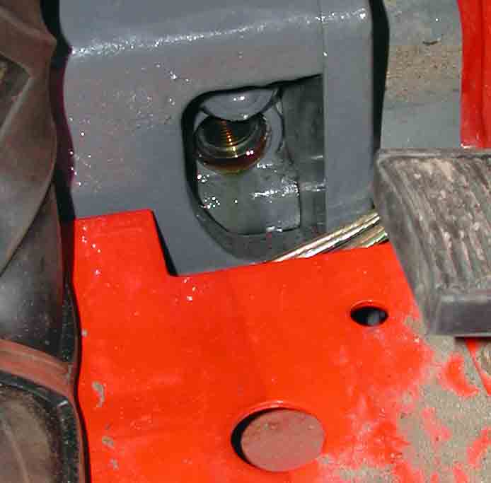

What port can be used to check hst psi?
/ How to increase HST relief pressure on a CK30 #22
It's been a few years but, sitting on the tractor looking down at the ports, I believe the left port is the forward pressure. The middle is the charge pressure (not what you want). The right one is reverse. It won't hurt anything if your monitoring the wrong port in the beginning. You'll see immediately which is which when you apply a little pedal.
Here are the details on the plug threads:
http://www.tractorbynet.com/forums/...rostatic-transmission-pressure-port-plug.html
I was able to get a local hydraulic shop to make me a hose for a gauge 0-5000psi.

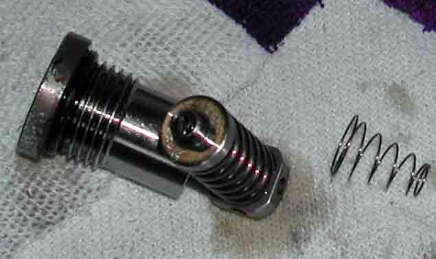

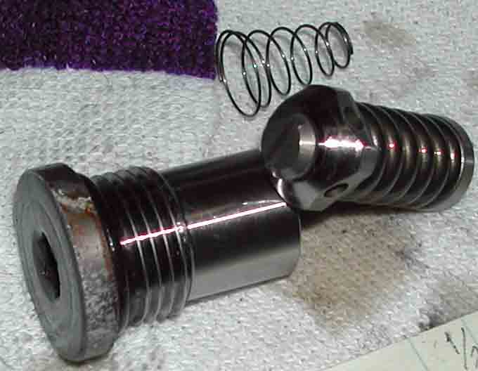

/ How to increase HST relief pressure on a CK30 #26
I forgot that I started this thread, TIN.
Kudos to Tim for making an adjustment, and measuring the pressures,
before and after. I have been meaning to get a 10,000psi guage to
measure multiple HSTs.
I may be quite easy to intall the CK35/CT235 RV in a CK30/CT230 as
well. I don't imagine the part costs very much....
The current CK35/CT235 has a slighlty different hydro than the 27 & 30. The drive reliefs have the replenishing check valve incorporated into the the relief on the 27 & 30 the replenishing checks are ported internal. The relief valves will not interchange.
