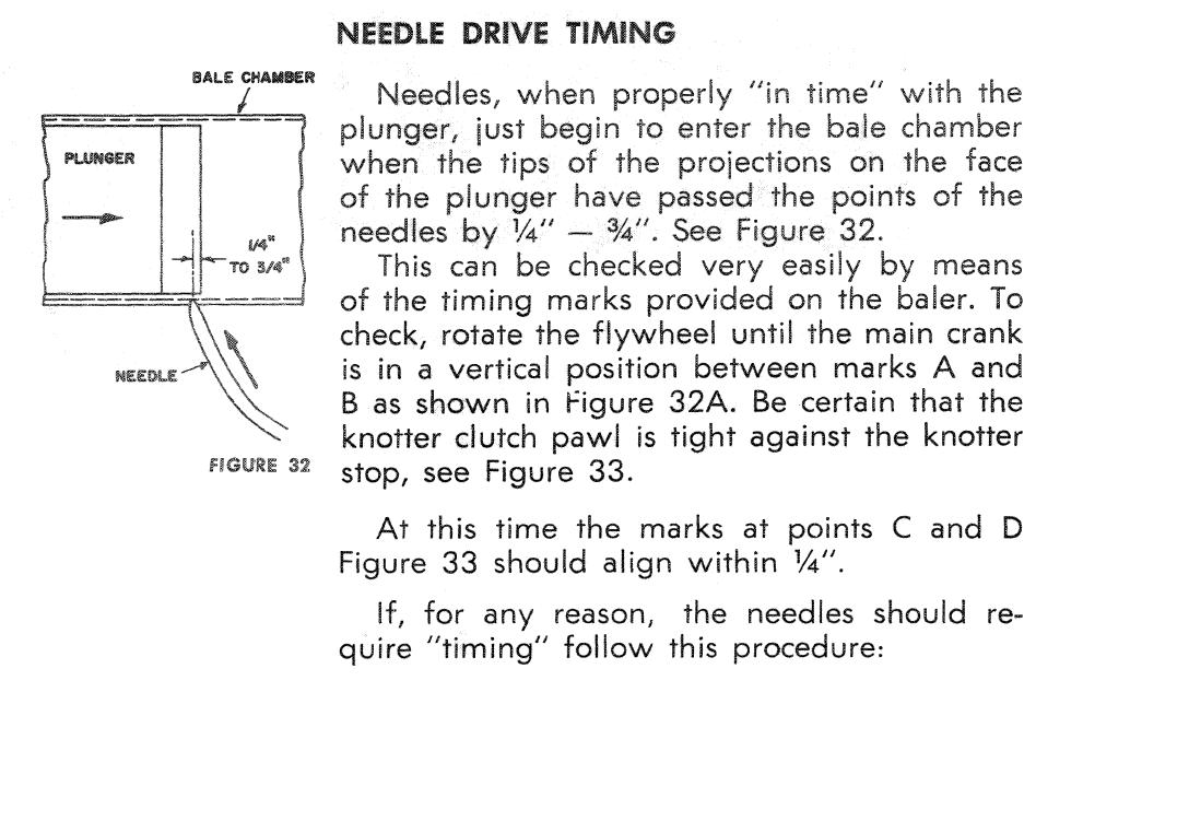

My Q on plunger timing- - As my needles are just about to enter the bottom, I see that the front plunger steel ribs are several inches out front of the needle slots. The lower main frame is around an inch. The Manual shows a diagram of 1/4" to 3/4" for the plunger to needle locations but fails to show if those ribs are part of the test. I'll review the NH baler knotter video agan too. What do you think?
   / How to hand test a NH268 knotter
OK... Back to the Manuals. As yesterday was the knotters- Next is the plunger timing (which I glanced upon). So that said, Attached is the NH Manual guide text which clearly states that you should be 1/4 to 3/4 of the front projections. so NEXT... ;-) Never a dull moment! I did attach the NH diagram and text if anyone is interested. I'd post the entire manual if the 1mb limits were lifted.... hinthint.

Countryguy ... I may not have made it clear in the first post. You MUST make sure ALL timing is correct before running it under power. When you say the needles are entering the bale chamber several inches behind the tip of the plunger .. It means to me , the machine is completely out of time.
You have a manual... Check the needle penetration, needle drive timing, needle latch. (Needle latch is what you are calling the interlock) etc... There are several inter-related timing adjustments. Change one and another is mis-timed .... too many to write about here . A mis-timed baler is expensive parts broken... much less well tied bales.

As for position of the plunger when the knotter trips, on my baler, the plunger is well on its way out of the compaction area when the needles raise. Some people think that the needles ought to help push the final flake at the bale being formed, but it ain't supposed to be.
I've worked on both JD & NH sq balers. On each brand the needle to PH timing is similar. Needles aren't designed to help form bales but take twine/wire to knotter system. If the PH on your baler is "well on it's way away from compression stroke" then I think your baler is timed incorrectly. If timed as you describe this puts undue pressure on the twine/wire as knot is trying to be formed. That may not affect tying on light bales but will on 60-70# bales. I just stating from my experience of many years of repairing sq balers.
   / How to hand test a NH268 knotter #13
You are corrent the needles should be just coming up into the chamber with the plunger still coming forward (compressing the hay) almost to the needles. As the needles rise they go through slots in the plunger face that allows them to be in the chamber and the plunger holding the hay. As the needles pull back so does the plunger (towards the tractor). Any sooner on the needles and they come up through the hay being compressed. Any later and the hay in the chamber will press against the needles, giving at least knotter issues, at worst broken needles.
I've never seen one but I have been told some of the early Deere 336 baler manuals either were poorly written or wrong. People would end up setting the needles with the plunger going backwards (towards the tractor) when it should be with the needles just entering the chamber and the plunger going forward (towards the back of the baler) and compressing the hay. I've fixed more than one 336 that a person timed wrong.
