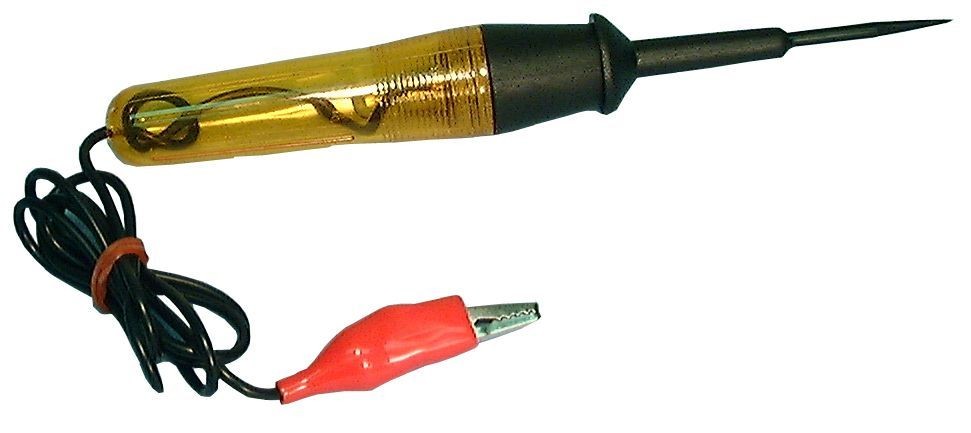

   / how to get lights to work ? #3
Invaluable for low voltage DC circuit trouble shooting...
