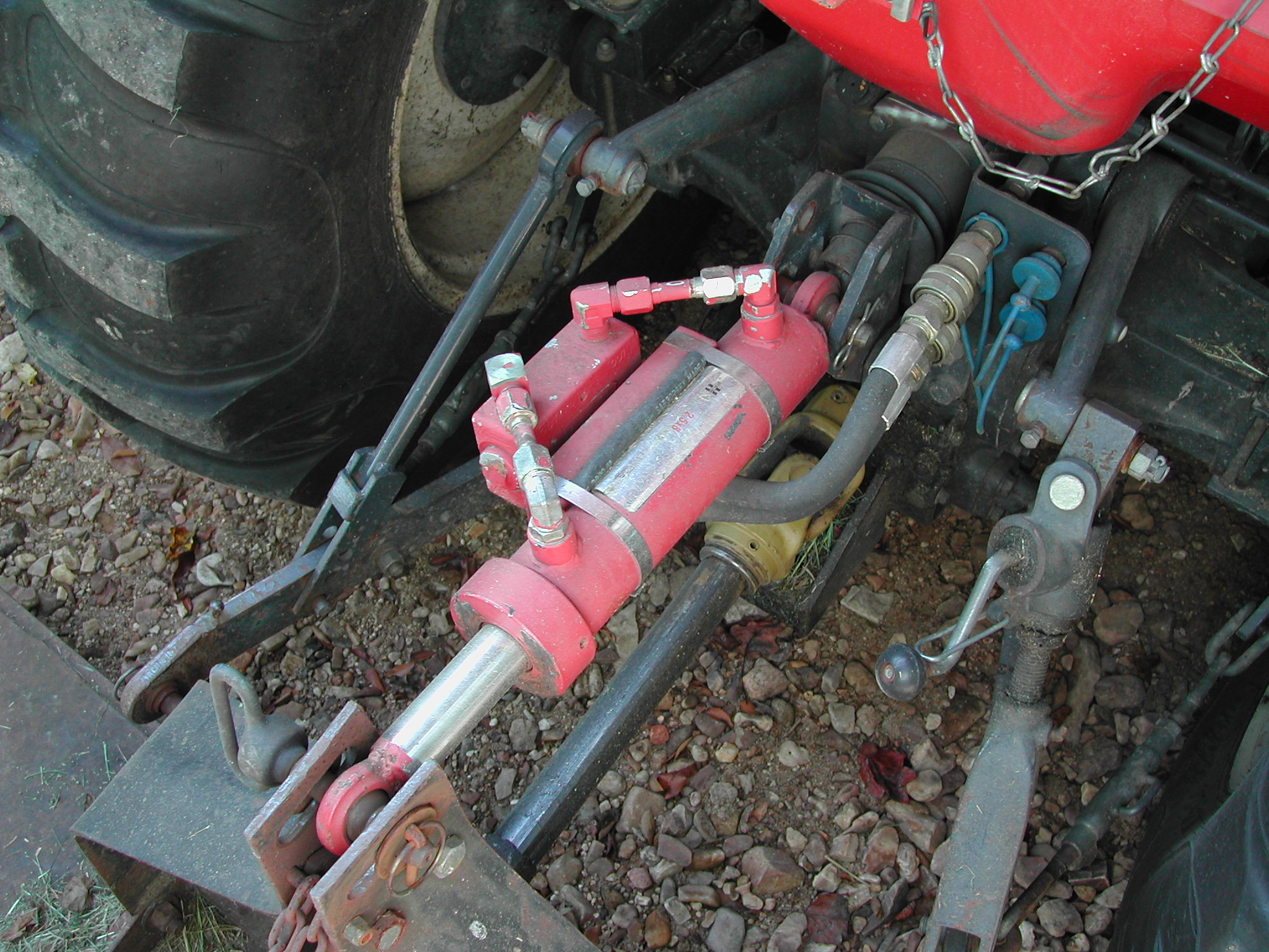

The slotted toplink mount on my old Howse works very well in our hilly country here. The hydraulic toplink makes it easy to readjust if necessary for special areas on-the-fly but overall I can set it and forget it on my 6 acres when I used to cut here with it - I now use a finish mower. Doesn't look like much travel in that short slot but it means alot at the rear of the 6' cutter. I guess if my cutter didn't have the slot I would try a short chain, although I would worry some when backing uphill with it - the way it is now it can't flip up and destroy the pto shaft.

On my rotary cutter, the last few inches of the supports that run from the A-frame to the rear of the deck are chains. This allows for some movement of the deck but also will not let it flip completely up if backing up a slope.
