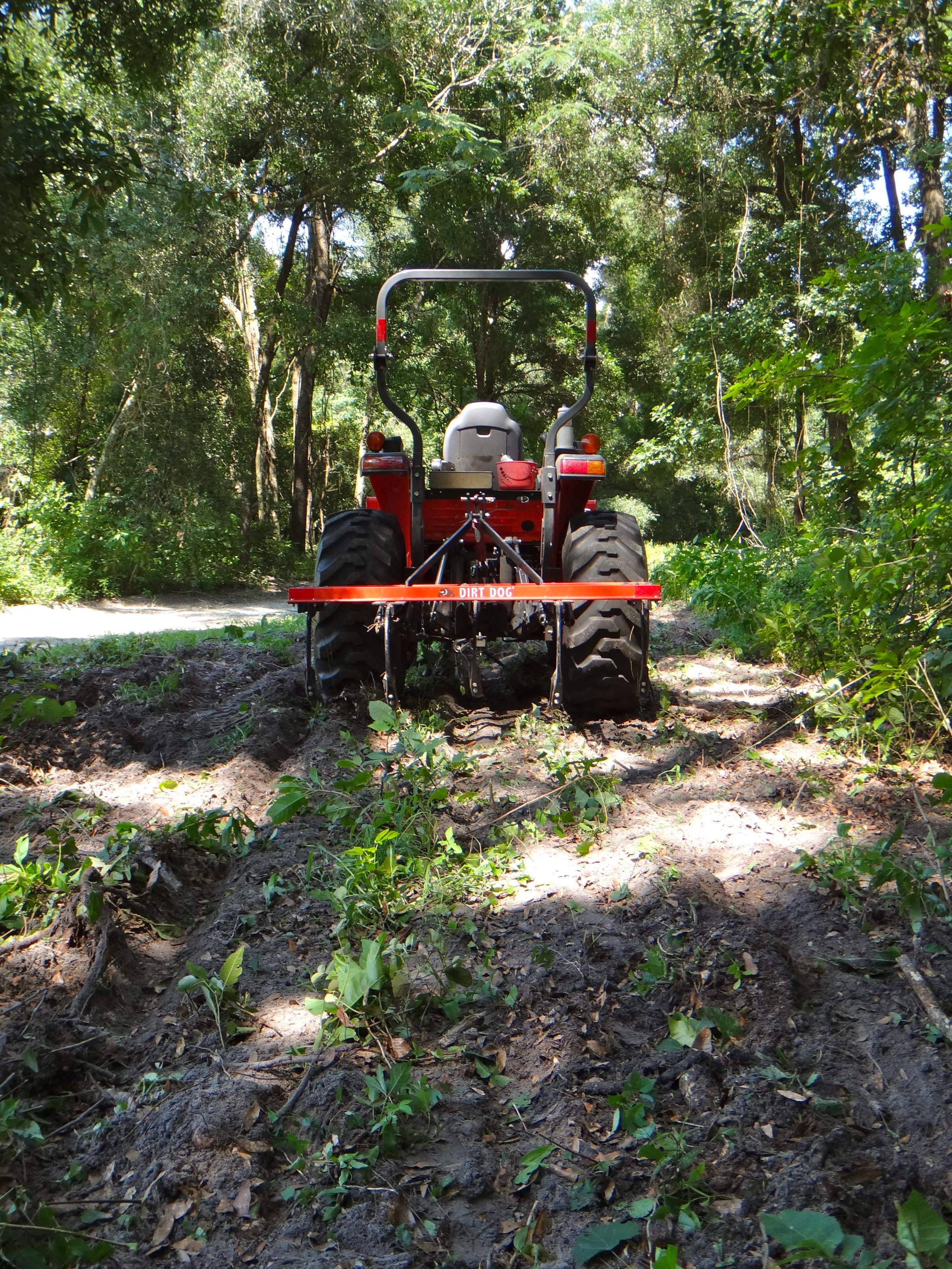

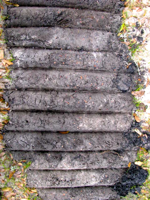

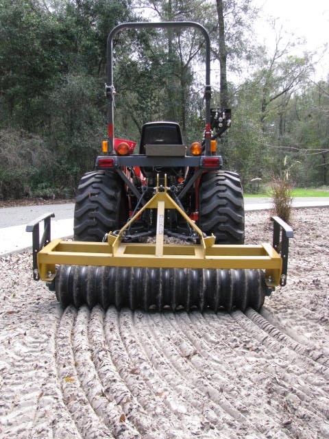

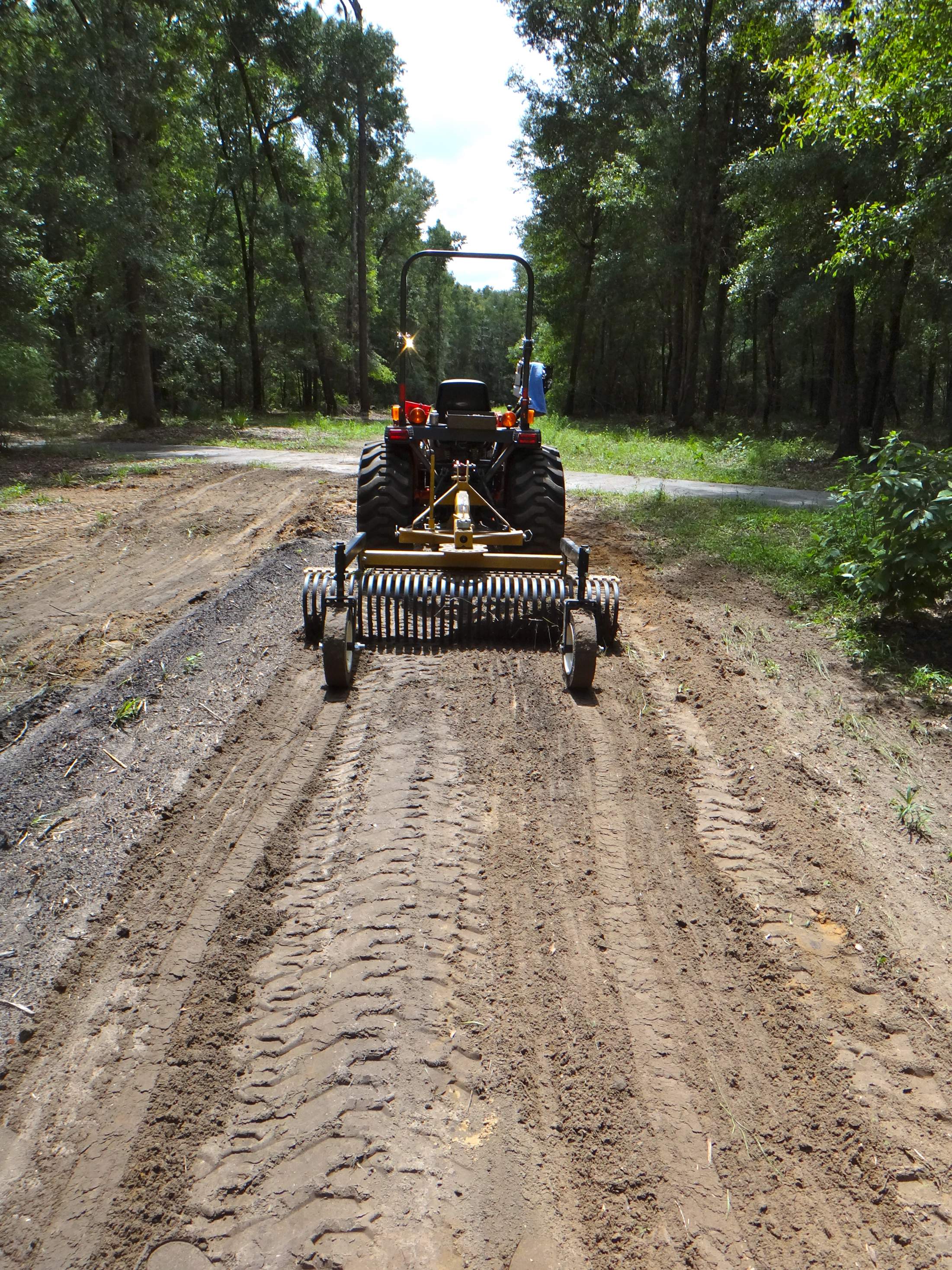

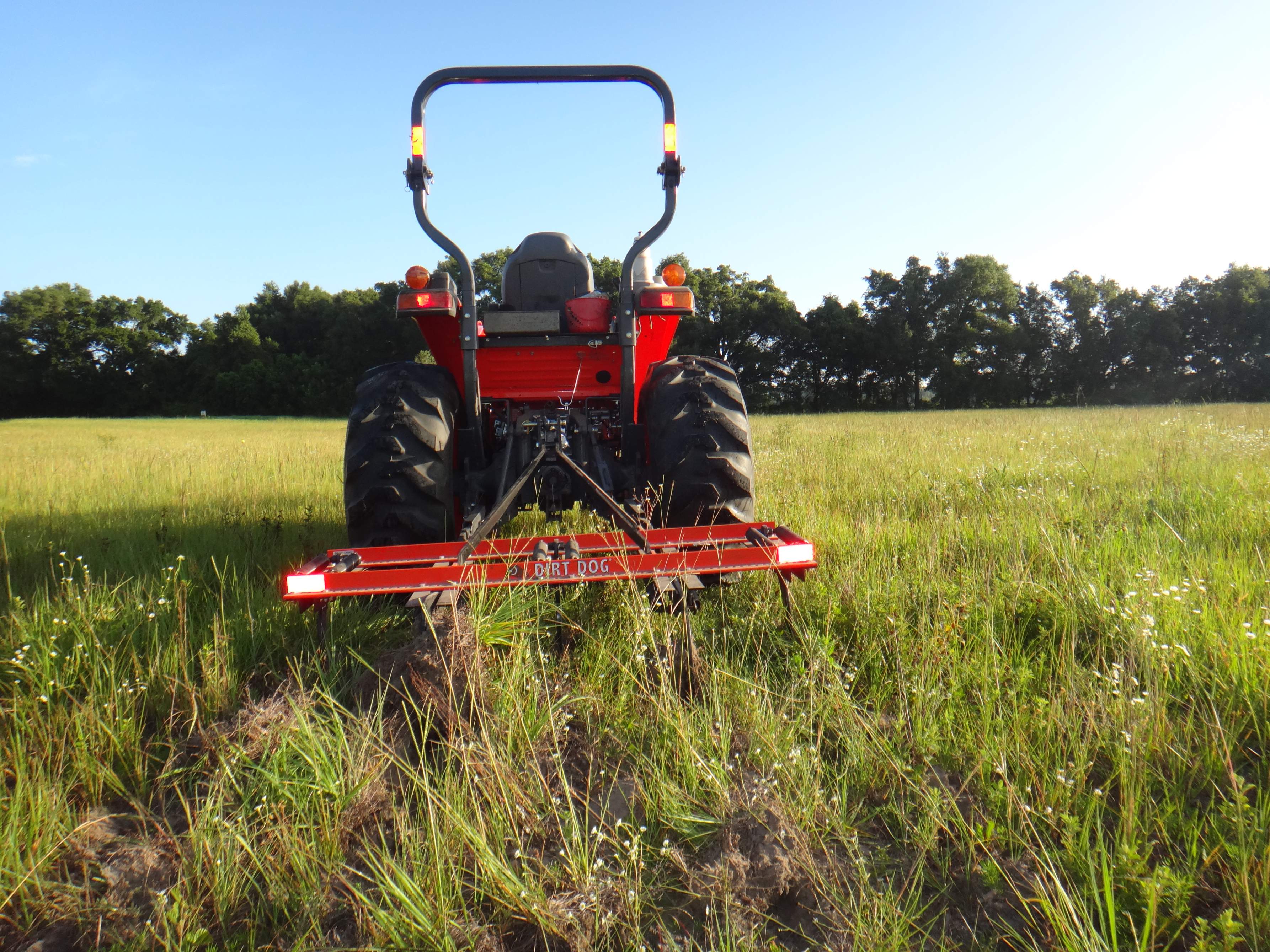

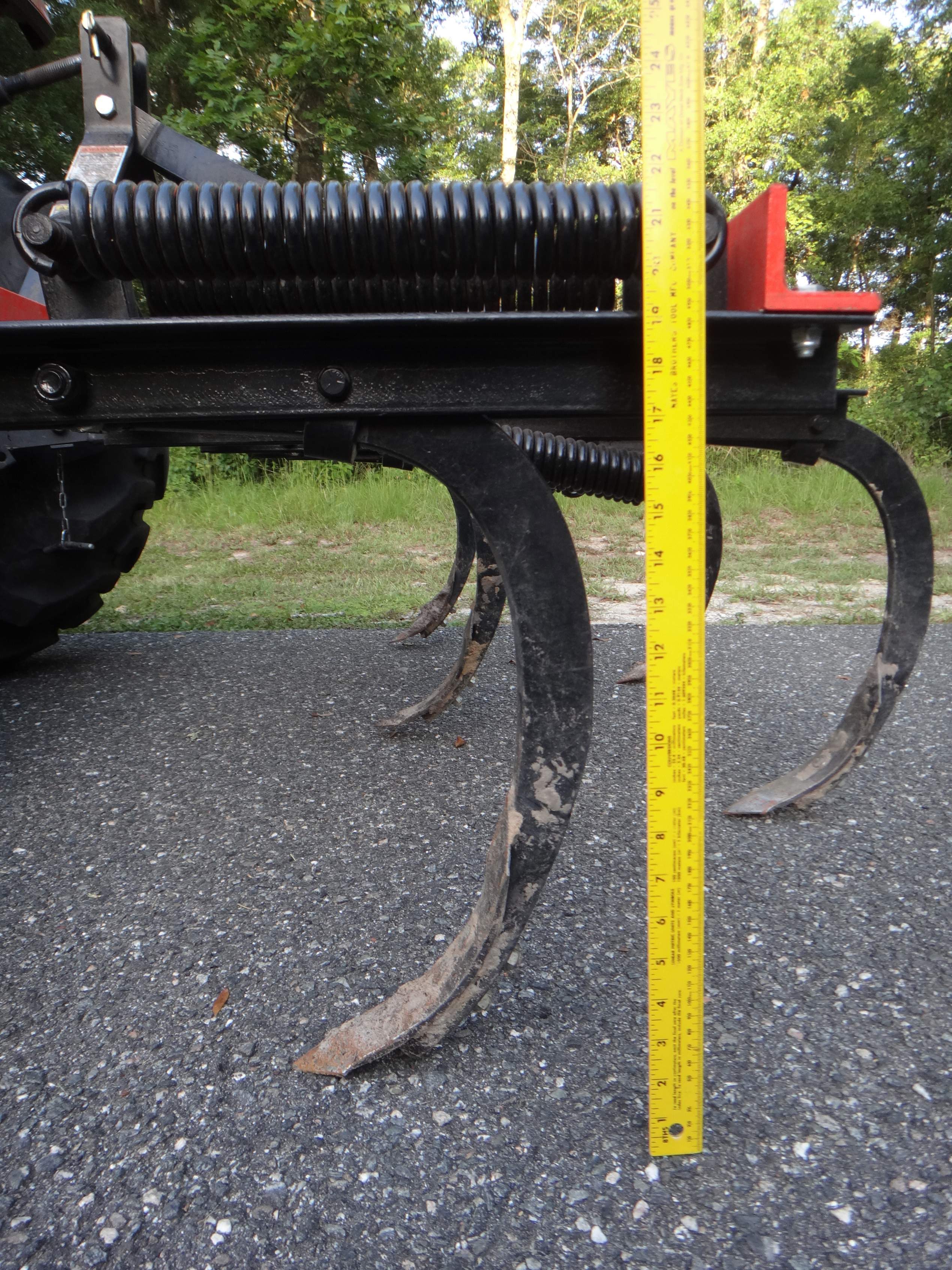

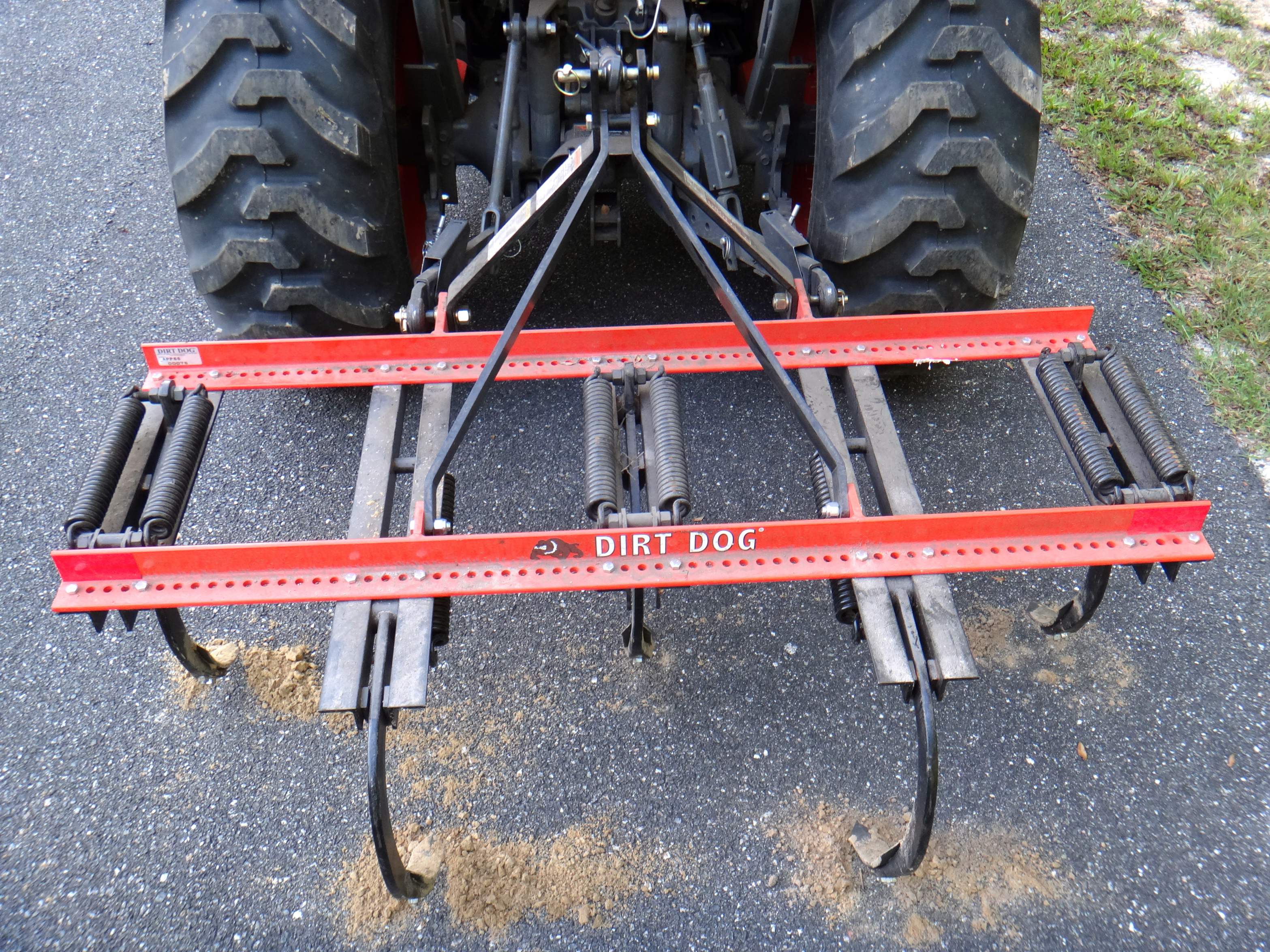

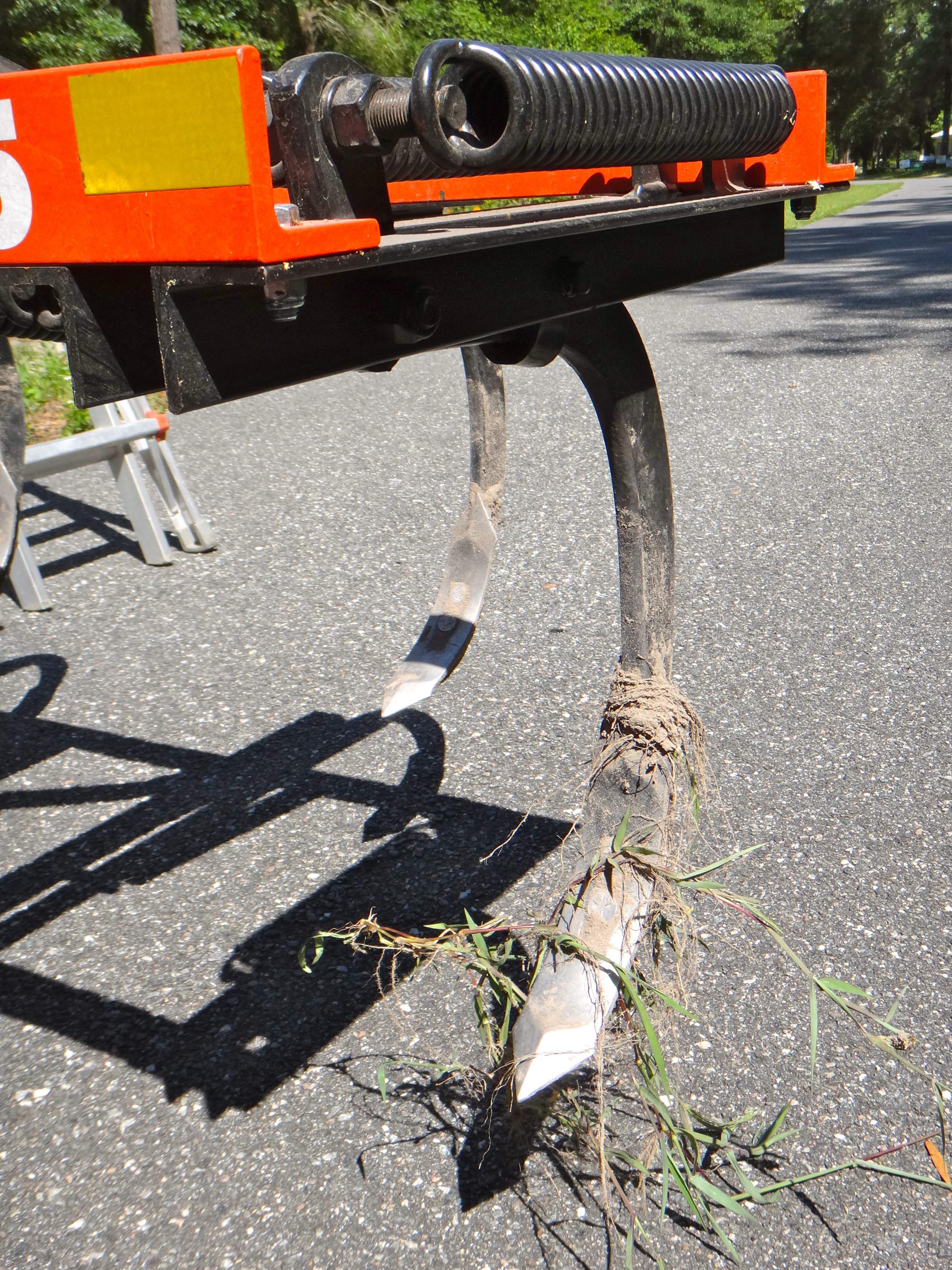

First you need a Field Cultivator, one type of pasture aerator, then a HEAVY Landscape Rake with gauge wheels, angled, to finish. You may decide to remove every-other-tine on the HEAVY Landscape Rake. Alternately, the Field Cultivator, a rear/angle blade and then anti-erosion finish with a Cultipacker. If you have areas that still have erosion potential you can cover with straw then go over straw with a straw crimper. (City ordinances often REQUIRE straw.)
Photo#5: Note Disc Harrow furrows on left, decreased ripples on right, behind Field Cultivator.
Be very cautious about moving dirt on slopes. One judgement error can kill you. If in doubt find a landscape professional with lots of experience who will know how to do this work safely, in preference to mangling yourself.
LINK: http://www.tractorbynet.com/forums/attachments/339095-dirt-dog-all-purpose-plow.html?highlight=

I would try smoothing in strips following the contour of the land (if you have terrace rows I would follow them). Work these strips the width of your implements 5 to 8 feet wide to smooth and then skip a row leaving the grass in place. In other words do half now and after you have grass rooted well enough then repeat the process with the remainder maybe next year.
   / How to flatten a lot to work on it ??? #5
I would try smoothing in strips. Work these strips the width of your implements 5 to 8 feet wide to smooth and then skip a row leaving the grass in place. In other words do half now and after you have grass rooted well enough then repeat the process.
OF COURSE! Why didn't I think of working in strips? :duh:
Forget the Cultipacker. Forget the straw and straw crimper.
Just need a Field Cultivator and a HEAVY Landscape Rake with gauge wheels. And some patience.
