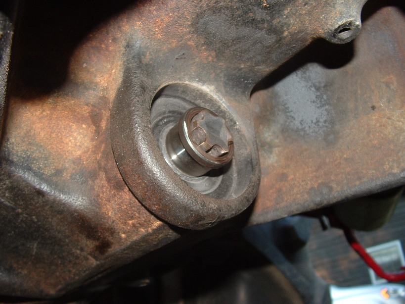

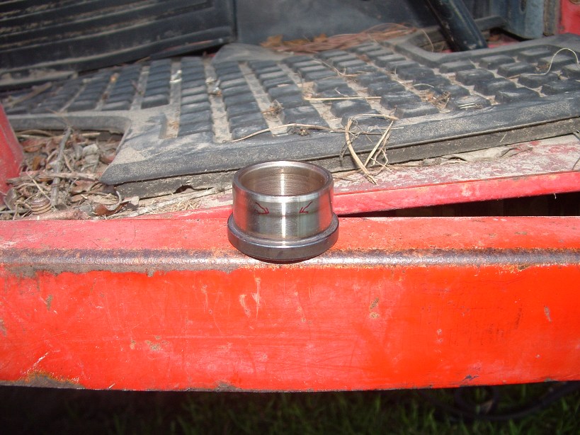

7). Now look a at the shafts both on the front axel and the tranny. one of them will be bad! " look at the pics!
   / how to fix FX series 4wd front driveshaft
8). If your is like mine and jhunt1x's your tranny shaft will be boogered up on the end.
9). if yours looks like the 2nd pic above remove the driveshaft and cover assmebly. With care you should be able to wiggle them free and remove them from the tractor. Mine has a koyker loader on it and I was able to remove them with out taking the loader off. jhunt1x removed his loader for more room.

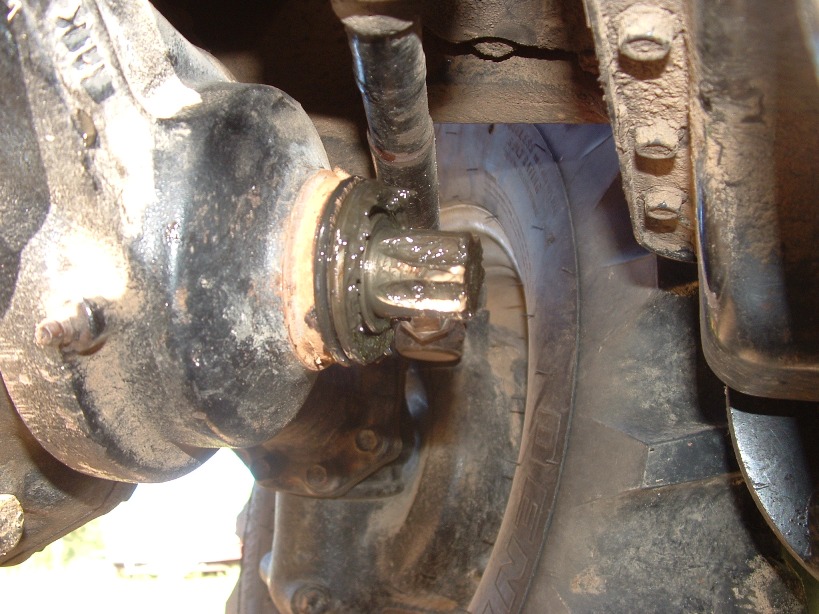

11). clean up the narled shaft so you can slip the coler and spacer off then take your 4" grinder and grind off the frist 1/4 - 3/16's of the bad shaft off. at least untill there's no more buggered shaft. See Pic

12). when you fit the colar and spacer back on you will see only a little bit if the shaft sticks out. My colar and spacer was a one piece set up, but fron what jhunt1x described to me his was a 2 piece. either way you gonna have to remove a bit of the spacer. here's how I did it:
