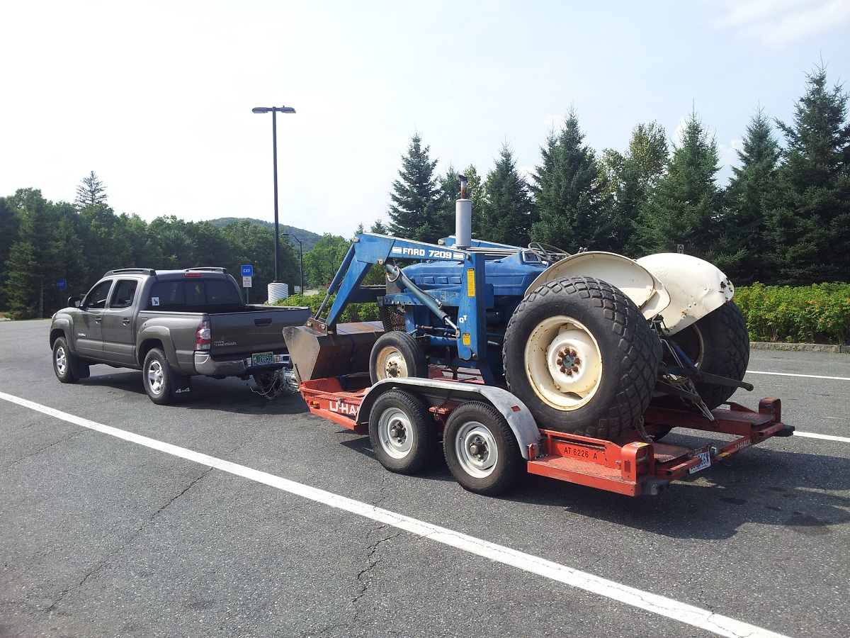

I towed a similar weight Ford 2000 w/ Loader. I had one person inch the tractor back and forth until the back of the truck had a reasonable, but not too much, sag.
Truck was a 6 cyl Tacoma, and I towed 350 miles, over the Berkshires. It didn't fishtail until over 55 mph.
Watch that you block up the back of the trailer when you first load. I didn't, and the trailer tongue tried to lift the truck off Tractor in Tow.jpg the ground when the tractor weight first hit the back end of the trailer. I had to back off and then block up the end of the trailer.
