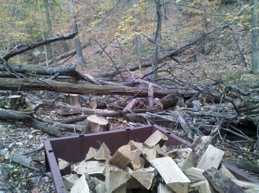

I recently retired and moved full time to our farm. I have a hilly wooded 54 acres and a number of trees that have blown down over the past few years. Since I was only here on the weekends, I never had time to get to them or needed them for firewood.
The trees I'm looking at are all off the ground, either supported by their own branches or having fallen across other trees. Some have been down at least a couple of years and some maybe 3-4. I don't have real good identification skills, but most are oak (red, pin and white) and hickory.
I don't have a moisture tester and have just been cutting those that I can get to with the tractor and splitter. The first couple of oaks have no rot, but the bark did fall off as I was sawing/splitting. The wood is heavy.
The only "test" I know of is to try to burn the wood. We are under a burn ban, so I've waited for cooler weather to burn in the fireplace. The wood burned like green firewood, so I'm assuming I just need to let it season.
I'd like to be more selective as the trees get harder to reach. If the wood is soft around the outside, I'm assuming it is too far gone. If the wood is solid through the cut, I'm assuming it will burn. Is that reasonable? Are there other simple "tests" you use to determine what is worth cutting?
I should add that I'm buring in a couple of fireplaces for pleasure and not for heat. So green is OK, as long as it will burn sometime!

Oak and Hickory can last several years if they are off the ground. I think the best way to determine wood's suitability is to just cut into it and see if the saw goes through like a hot knife through butter. If it does then the log is rotten and has very little heat value.

My hunch is the wood in your photo is just fine - just needs some time to dry out. If it was a healthy tree went it went down - it will stay good for quite a while if its off the ground. Doesn't lose much moisture until its cut and split.

I agree. Cut it and let your saw be the judge.
I will add that red oak may get soft on the outside, but it is still very much worth cutting. If you cut a good sized peice and look at the end, there is about a 1" white ring around the outer edge and the rest is "red". I have found that theat outer inch or so will get "punky" or soft within a year, but the rest will stay solid for 5+ especially if off the ground.
Most of our cutting is tops from logged out woods'. From my experience, the maple is the first to rot. within a year or two. But ash, hickoy, and oak will last much longer.
Another thing that we will do if unsure is cut 1 peice and use a maul to try to split it. If the maul burrys several inches into the wood without starting to split, it is either rotten or a very soft wood like poplar. Weight isn't always an accurate way to tell, cause there is ALOT of moisture/water in rotten wood.

Heart wood is much more rot resistant than sap wood. The heart wood is where all the heat is anyway. If the sap wood is punky, no big deal. If you get punky wood bone dry it makes great fire starter.

Thanks for the information. I actually stopped cutting a red oak because of the white ring around the outside. I'll go back to it.
I've got a lot of wood to cut and should be set for a few years if I can keep it stored properly. This may be a tough fire year since I'm going to be using mostly freshly cut and split. But I feel a whole lot better about the time and energy I'm spending after reading the comments here.
