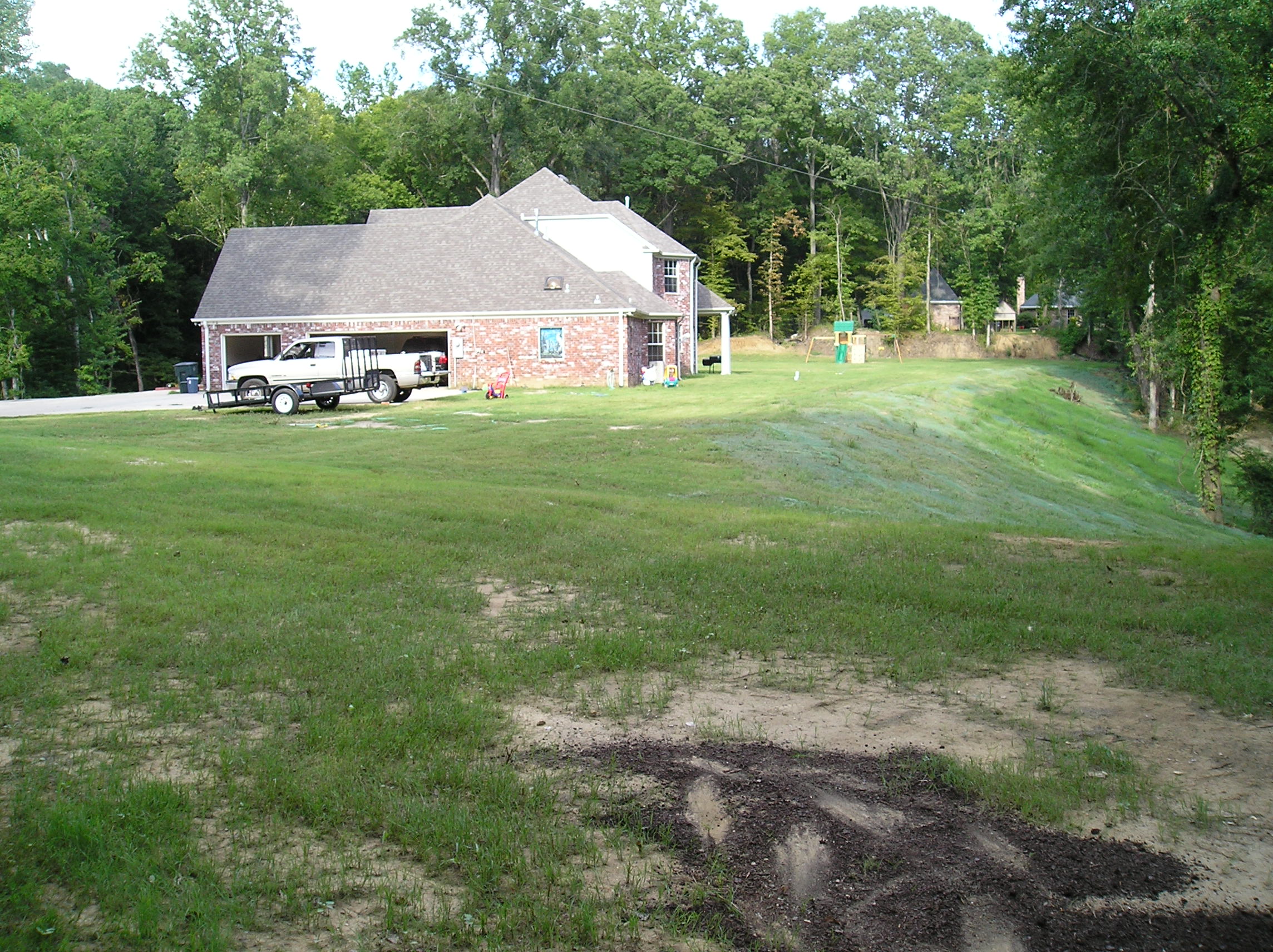

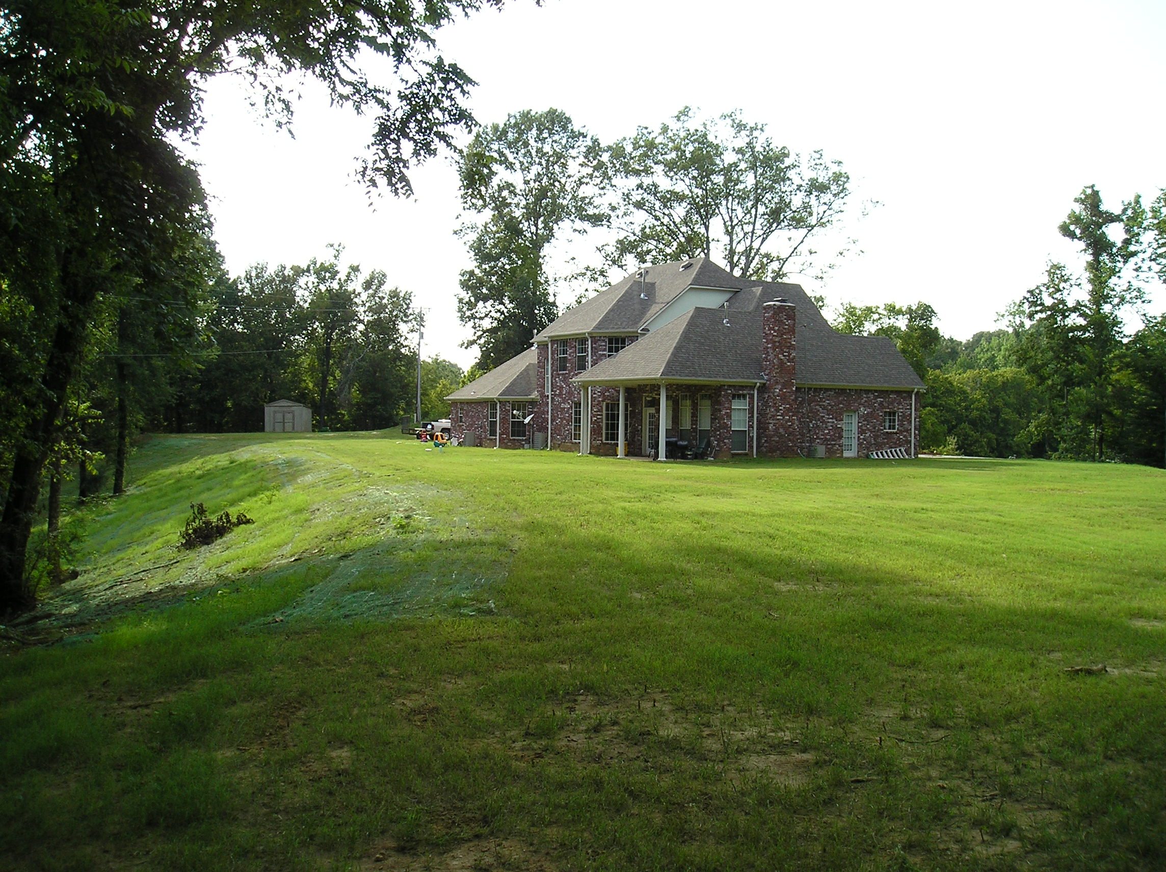

I have a problem with water draining down the hill in my back yard and washing away the hill. It's hard for me to cut grass on the hill with my zero turn because the ride is very bumpy, what's the best method to control water flow for this scenario. Which implements for the tractor works best. I'm in the process of buying a Kioti ck35hst with front end loader and box blade. Here are some pictures of my back yard.

I guess I'd be inclined to keep overseeding, fertilizing and watering. Try to get a good sod cover to hold the soil. Then you can use fine topsoil or a sand mixture to rake in and even out the rough or low spots. Our house is built well up a hillside and I use most of a 25 pound sack of grass seed every spring to make sure I've got good sod on all the hill.
   / How to control drainage off hill #3
If you ran some drain tile along the hill and filled the trench with washed stone, it would carry the water away and prevent it from washing the soil away. I think that you could get away with one line about 2/3rds up the hill. You will need to rent a trencher, but you could use the tractor to back fill the trench.

What if you built some sort of berm/ditch across the top of the hill? You could use that to divert the water to the drain tile DWW68 recommended..

You did not list where you live, so the following info. may not apply. I have a similar problem that I spent all spring working on. I live in what is considered zone 6 according to the literature that I have read. The yearly temperature low is -10 to +10 degrees F. My problem is that this past winter was a warm winter for my area with little snow fall, but with a lot of rain fall during the winter. The grass on the front slope on the side of my house washed out, so I spent a couple weeks moving dirt from another portion of my land to the washed out area. I then used a PTO tiller to till the dirt. I fertilized and planted grass in the tilled soil. The grass grew well until the end of June. My area is having a rain shortage along with hot weather so my new grass has now turned brown.
I am now going to place a border of football sized rocks around the entire area. I am then going to place junipers at the bottom of the slope and around the edge next to the wood line. I am also going to plant junipers across the center of my slope which is 50 yards in length. The center line will be approximately 20 yards across. I have used junipers and rocks before to stop soil erosion in other areas. Junipers will live almost anywhere and they don't require a lot of care.
I also had the same trouble with the ruts in the washed out area. I tried to patch the ruts but this method did not work for me. This is why I resorted to the above. Good Luck.
   / How to control drainage off hill #6
Turn the washing susceptible area into a no mow zone where shrubs and tall grass are planted.

erosion happens because the water has suficent velocity = force to cary way dirt/rocks/whatever.
you need to slow the water down. (or provide a surface that wont errode)
this is what riprap is designed to do. But no one wants piles of rocks in there back yard so....
go with the long grass... perhaps a wild flower mix?

I just thought I would throw another suggestion out there. How about planting sometype of ground cover like pachasander sp? or mountain snow to name a few. These varieties will spread and hold the soil while doing so ! ;)
