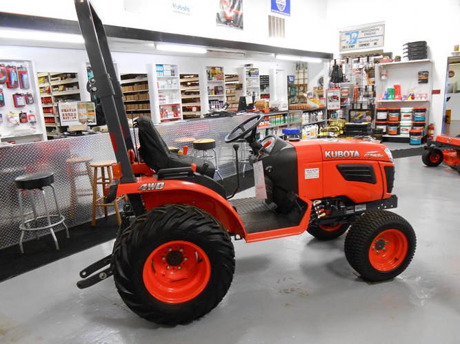

I have a front mount blower that I bought last winter. Will be mounting it on our L3830, but I am debating how to control it.
The L3830 has one hydrualic remote (with float).
The blower will have a cylinder to lift it, and it currently has a hydrualic motor to rotate it.
I would like to be able to control lift, rotation and chute angle (I have a linear actuator to control chute angle).
I see a couple of options to control lift/rotation:

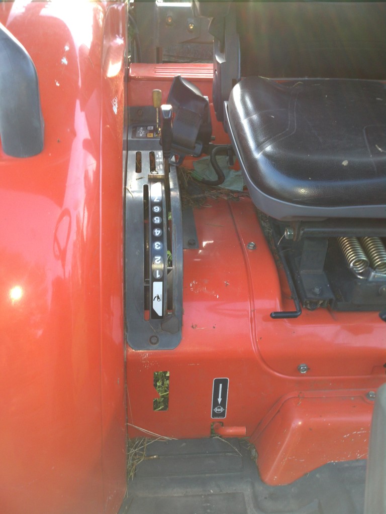

Option 1: Use a joystick valve to end up with a handle sort of like on the B2920, but starting on the floorboard or next to the seat:
This:
But mounted where this hole is (or next to the seat):
This:
<img src="http://www.tractorbynet.com/forums/files/snow-removal/438286-how-control-blower-img_20150819_190133-medium-jpg"/>
Price: Between $250 and $450 (guessing).

For your option 1. With the joy stick. Your talking about tapping into the hydraulic system and then using it to add 2 more hydraulic remote??
   / How to control a blower...
Yes, there is a block under the floor of the operators station and for $30ish I can get the adapter to hook onto it like they use for the loader valve.
Aaron Z
Pretty sure I am going to use the winch to rotate the chute. I will put the winch/actuator relays in by the battery, then mount a connector there as well so its hidden and out of the way.
Aaron Z
Change of plans, now going with option 1 (loader valve by the floorboard, QDs for two remotes stacked in the back).
Estimated cost is $330 in parts.
Ordered a Cross joystick valve from ebay for $118 shipped. Waiting on a price from the local Kubota dealer for the hydraulic block (Messicks has it for$34 but they want $16 to ship it).
