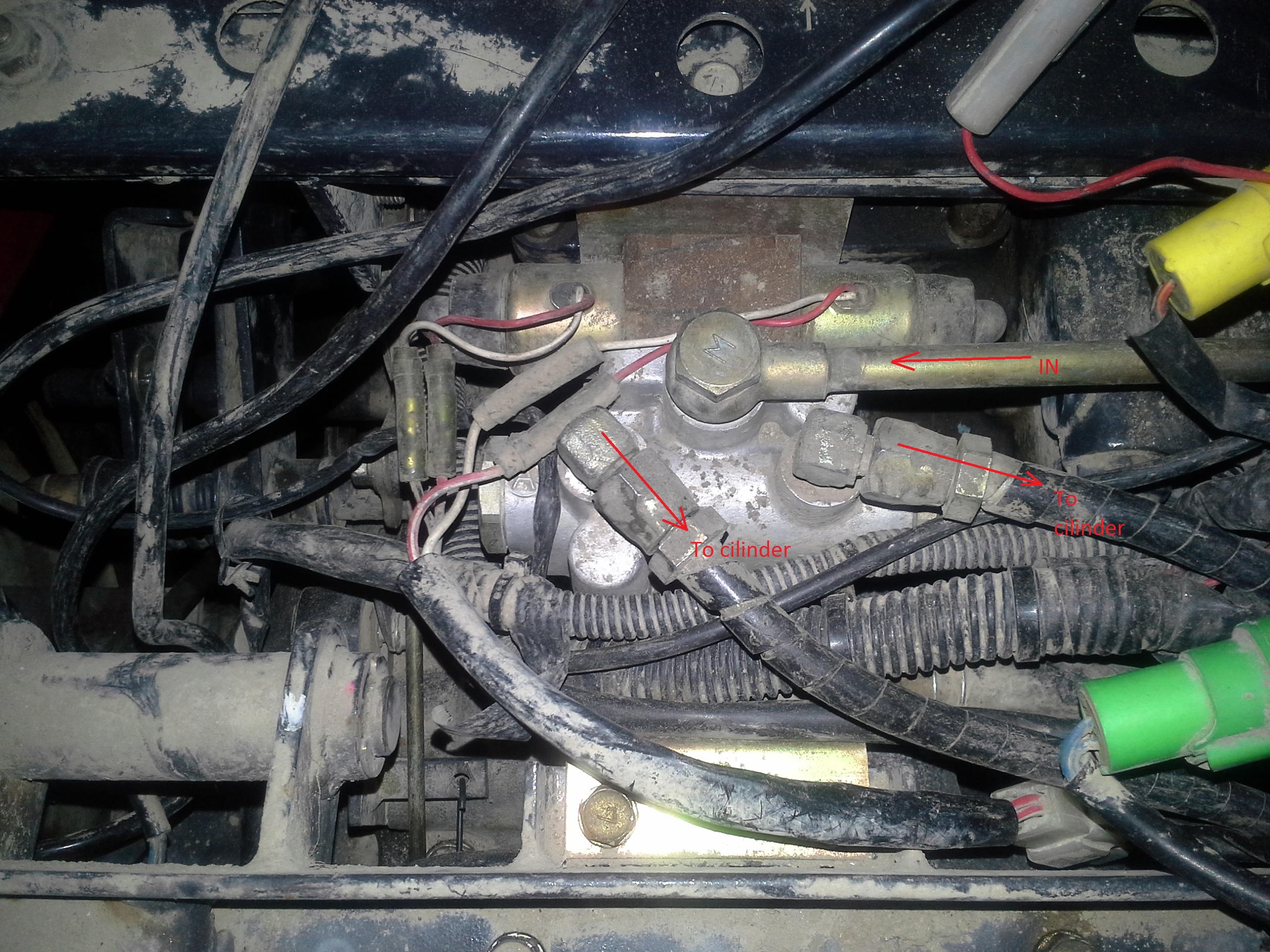

I have a Yanmar FX 265, I want to mount a spool valve. I need two double hydro outputs, I'm planing to use them for mulcher or front loader. I just wonder might be somebody has experience, where you need to cut the line for connecting in. What's recommendation on spool valve, simple or electric.
At the beginning I thought to put triangles and divide income (outcome) flow from 3point hitch leveling cylinder valve (attaching picture). But now I not sure if there will be enough flow?
