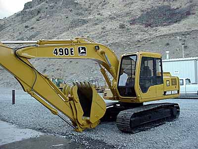

Like everyone said, use a dozer to clean it, then maybe use an excavator with a hydraulic thumb to load it and then go and dig out any stumps you want out. Or burn it if your state, city, or county lets you. I personally would leave some stumps just because I'm a birder and like to leave things as natural as possible, but that's just me. To clear our property at our old house, they used a tractor/loader, and a 490E excavator. Just like the one I attached. Nice machine. I got to drive it with the guy, his name was Erl (however you spell that) loader. lol. /forums/images/graemlins/smile.gif
Blake
WA
Blake
WA
