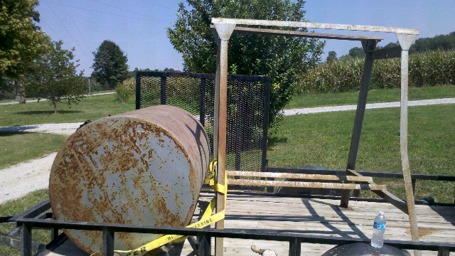

I just bought a 200 gal. Fuel tank from a guy at work. I want to use it for gasoline. It hasn't been used un five years. What is the best way to clean it out? Its on a stand im Gona wire wheel the out side of it and the stand and repaint it should I paint it a certain color to help keep the fuel from evaporating? I'm going to keep it in my barn also! I would like to paint it I H red with a big I H logo on it not sure tho! Thanks!

My wife's cousin owns the local bulk distributorship for farm fuel and he had his guys come up with a power washer and clean ours out and put a filter on it. He said regularly obtained chemicals would be fine and to put lots of cleaner and fresh water through it. We put diesel in ours.

i'd pressure wash it as well... then dump in a gallon of diesel and a quart of atf, and 2 pints of 90% rubbing alcohol. agitate and roll around end and end.
drain.. put that mix in yer parts washer maybee.. ;)

Look at POR (paint over rust) website. They have acid and neutralizer to clean rusty tanks as well as coating to protect it when clean. The coating will seal rusty pin holes or small leaks if you have any.

As for color, if kept inside it makes no difference, but if outside in the sun it should be white or silver. For gasoline storage, make sure your paint is tolerant of gasoline so the occassional spill doesnt remove the paint.

I just put StarTron's Fuel Tank cleaner in 2 gasoline tanks, one that has been idled for 7 years, the other since 1995. I'll give it some time to work and we'll see what happens.
