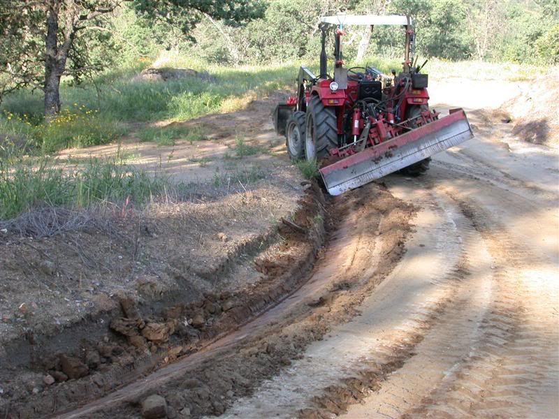

Supposedly you can use a box scraper to clean ditches...can anybody tell me how that's done? I can't get my mind around it? Do you tilt it at an extreme angle? Do you straddle the ditch or drive next to it?
I have about 600' of ditch that runs next to my driveway at the base of hill that gets full of sediment and washes over the drive. I cant straddle the ditch due to brush and uneven terrain. Any ideas? Using a FEL would be a done of work going back/forth.
Jinma 284 4x4 FEL, 5' King Kutter box scraper.
Thanks!

I use a miniexcavator and smooth ditching bucket. It makes a really smooth ditch and you can dump the spoil on the other side or haul it away really easy.

Check out this thread by 3RRL and the different uses of a box blade. He has some great pictures of creating a swale along the side of his driveway and it looks great! I am sure you could use the same technique for cleaning the ditch.
Here's a picture from his thread. :thumbsup:

This is a job better performed with either a ditching bucket as mentioned by Kay's Supply or a good rearblade with offset.
I use a rearblade with it angled and tilted sharply to pitch the materials back up on the roadway. Then respread the materials with a landplane.
Make sure the ditch has enough slope to it to carry the water away or all you will do is fill it up when it rains and repeat your problems.

Agree. A box blade, although it will work, fills up the portion of the box which is down low and then relies on the rest just falling out to the sides, but not very far away from the resulting ditch. A properly angled rear blade, either with or without offset, will move the material further to the side and away from the ditch.

I tried to use a box blade for a ditch, and it does work. However, it took a long time, and it will not do the job in an area with larger rocks. Unless you have a hydraulic side link, be prepared for getting off, and on the machine a lot to adjust the angle. I have a tlb, and what I have been doing now, is to dig a shallow ditch with the hoe, along the side of the road, and then grade the road, and ditch at the same time with the box blade. I can extend the crown of the road right down ito the ditch. I do this, because as mentioned before, the excess material from the box blade has no place to go sometimes, except back in the ditch. So I take some material out, including bigger rocks, then use the scraper, as sort of a planer to smooth the edges. It works.:thumbsup:
