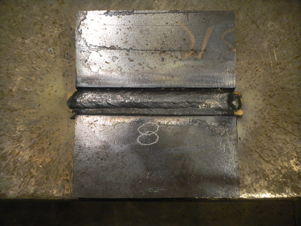

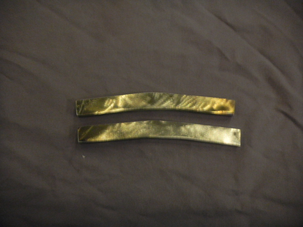

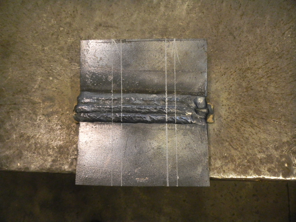

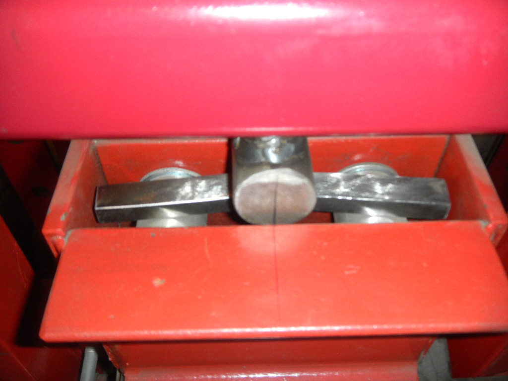

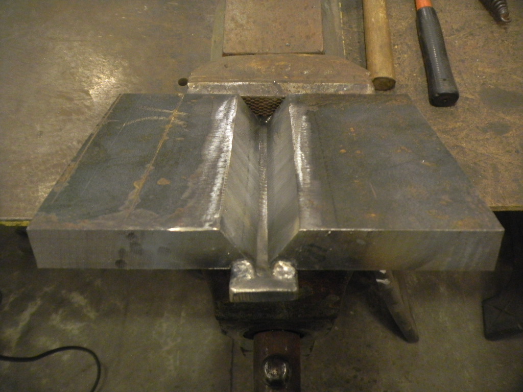

   / How to choose flux core wire? #5

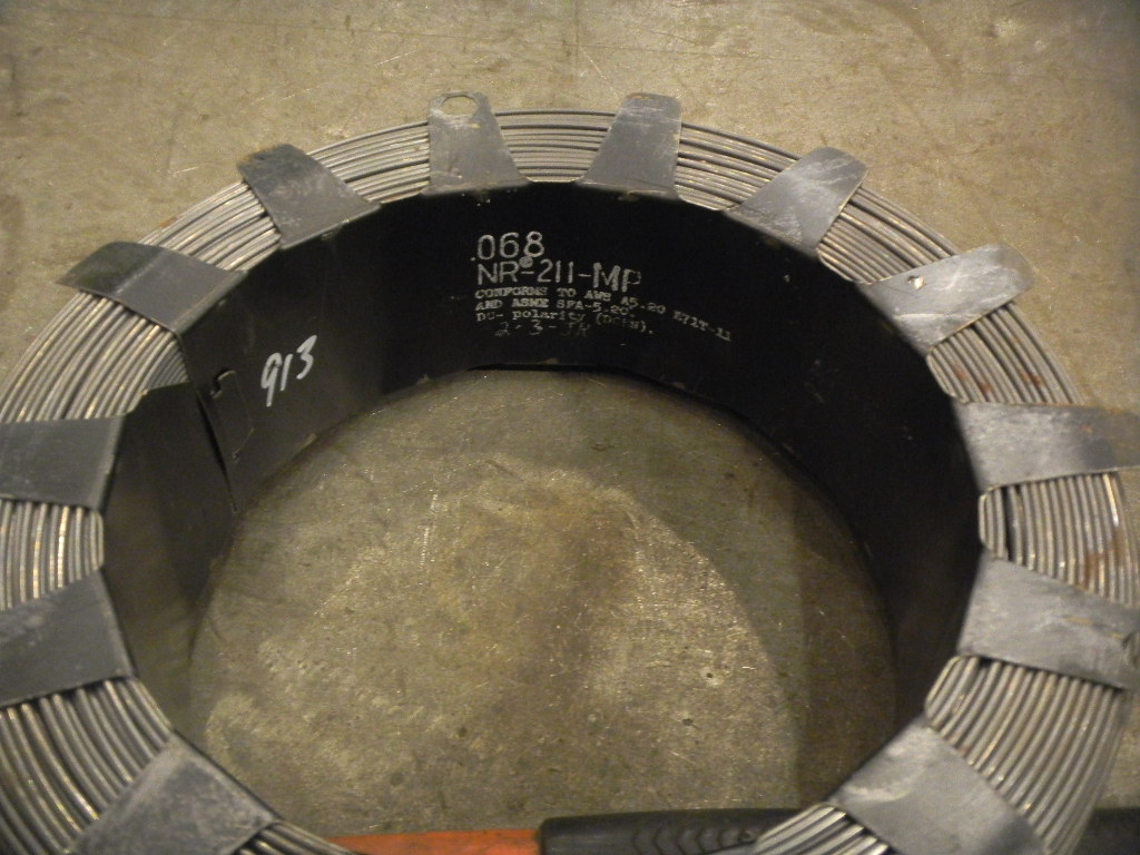

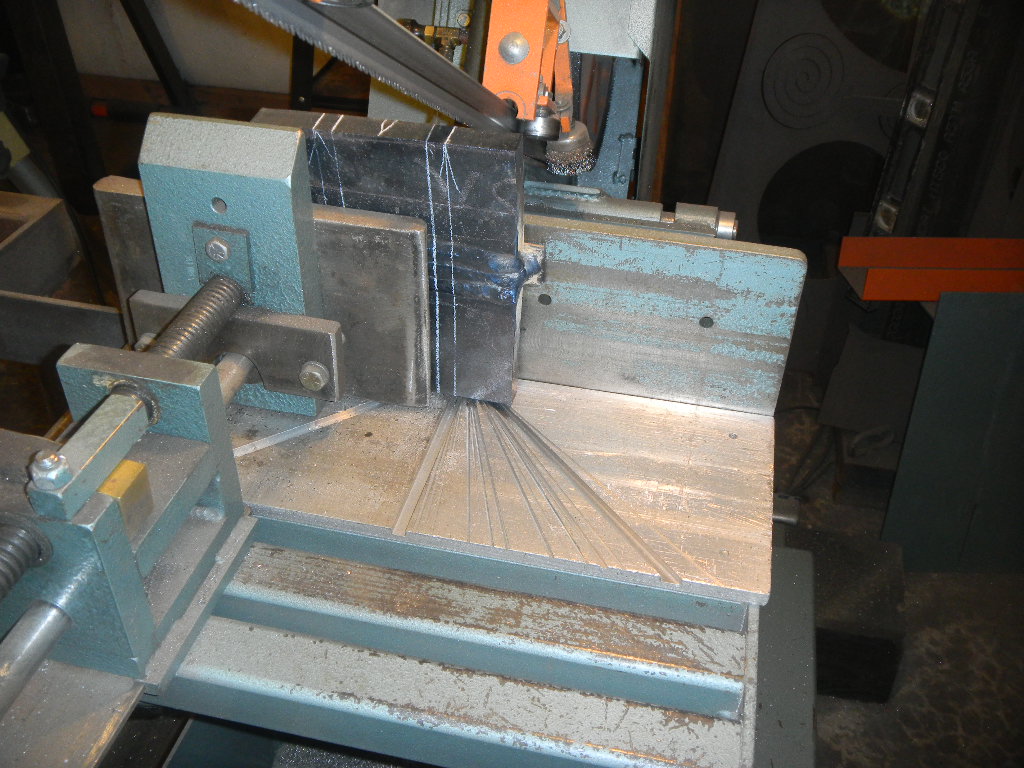

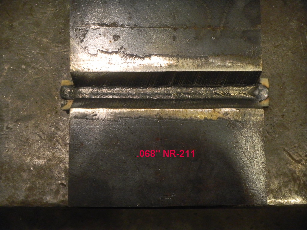

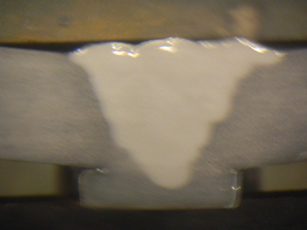

Over the years I've had several welding inspectors tell me they never seen anybody who could pass a bend test with NR-211. Last summer I found a roll of NR-211 in my Dad's barn that I took off a job in the early 1980s. The roll had rust on it. So being as I have all the time in the world, I thought I'd try my luck! :laughing:
Nice welding there should arc. How thick was the metal? How many passes?

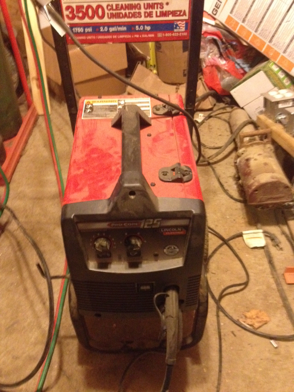

Here's the picture I promised.
Yes that is an old pressure washer cart that it's bolted to.

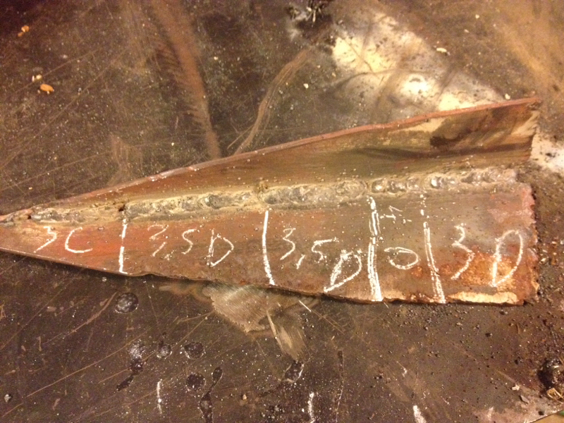

Here's some piddling I did today. The settings are wrote on the segments. Been about 15 years since I did any wire welding and I always went back to a stick then. I know they're no good but maybe someone can help me with what I'm doing wrong. It's 10ga metal.
If I remember right 3D is what the machine called for. After it got warm it started to surge. Wouldn't weld smooth. Or maybe it's me. I've got about 4 hours messing with a wire welder and a quarter of it was today.
