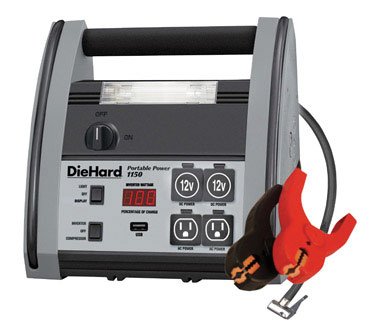

Is it for a car, truck or tractor?
There are new style Lithium Ion jump starters available now that might be what you need.
For my diesel engines, I got this DieHard 1150 several years ago:
