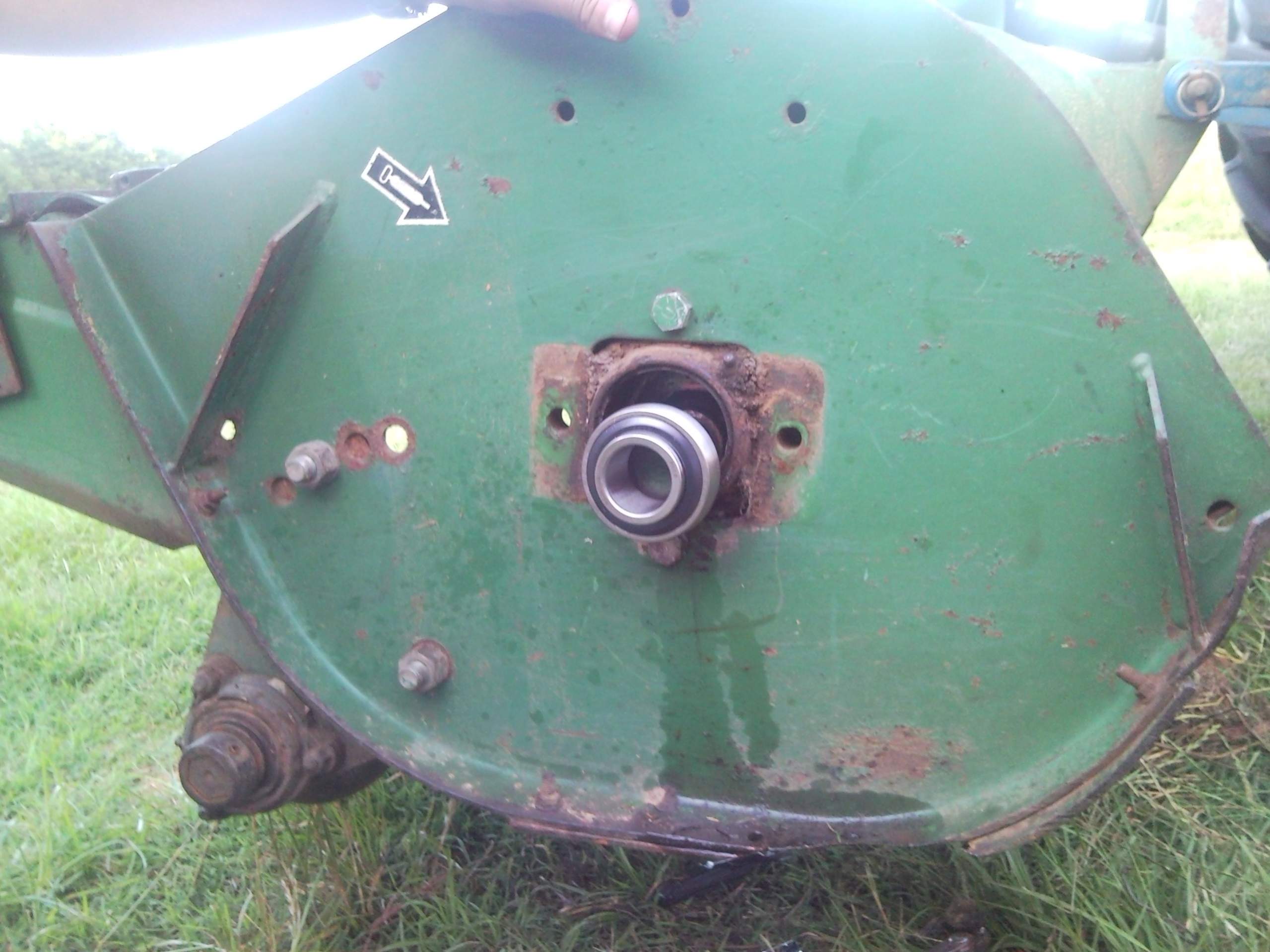

I've got an older model John Deere 25A flail that, after lending to a friend for a weekend, has come back to me missing a rotor bearing. From what I understand the repair will be similar to a 300 series JD flail also. I've ordered the new bearing, but am unsure of how to install it. Will it be as simple as removing the small shroud protecting it, unscrew the allen set screw, remove the locking collar, slide the new bearing on and reverse the process? The entire rotor assembly doesn't have to come out does it? I'm really hoping this is a 30 minute fix as I really need to get mowing again.

The bearing came in and as I started taking it apart I found out why the bearing went out in the first place. Looks like there was some nylon rope wrapped around the inside of the bearing. Looks to have been there longer than I've had the mower. I cleaned it up and realized that 1. I have the wrong bearing and 2. the rope had torn apart the bearing shield as well. So I have parked it and am mowing with the rotary cutter. I will revisit the flail in the next couple of weeks. Apparently there are two types of bearings on the 25a. One that was on the older models with the square shaped bearing housing and one on the majority of the 25a's out there with the round housing. I bought the most common bearing and it turns out I have an older model with the square housing (even though the serial number indicates I have the round housing type).

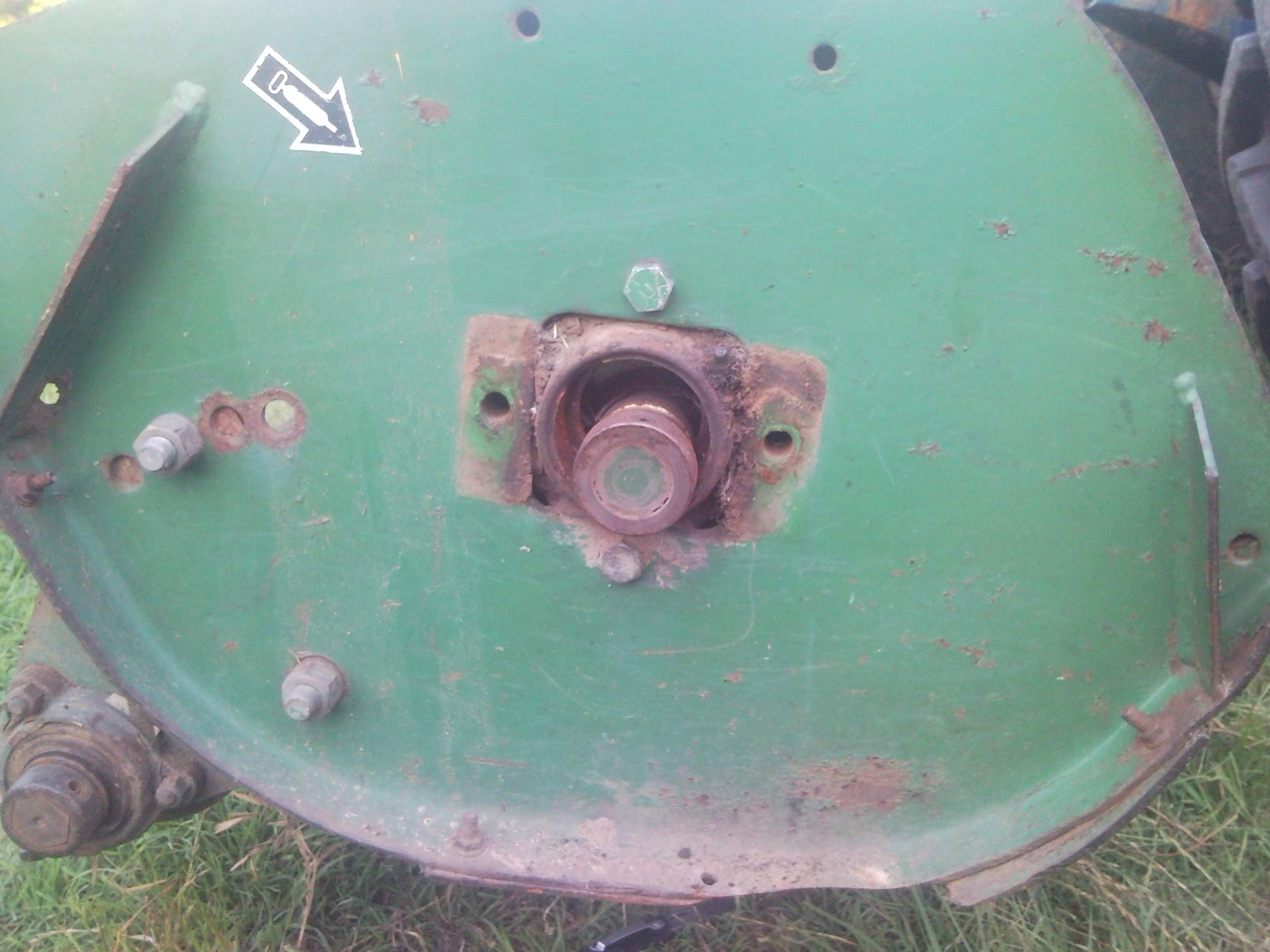

Actually, I'll go ahead and walk you through what I DID get accomplished in case you are going to do this before I finish up.
First remove the two bolts holding the shield.
This is what I found after removing the shield. As you can see the bearing is completely gone.

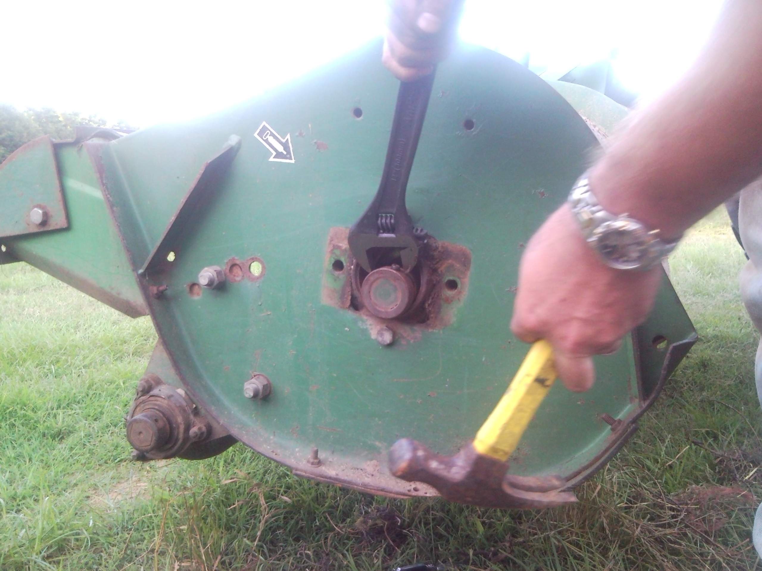

On the end of the shaft is a locking collar. It's held on by a t30 set screw. Back out the screw and pull the collar off (with much grunting and force in my case)
Backing off the set screw

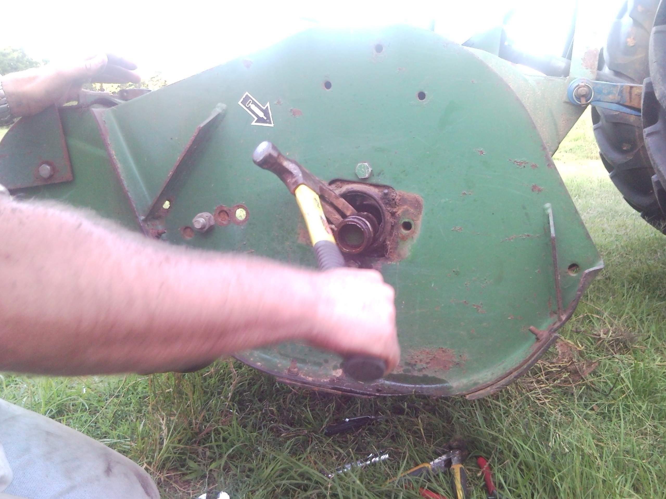

First attempt to remove collar

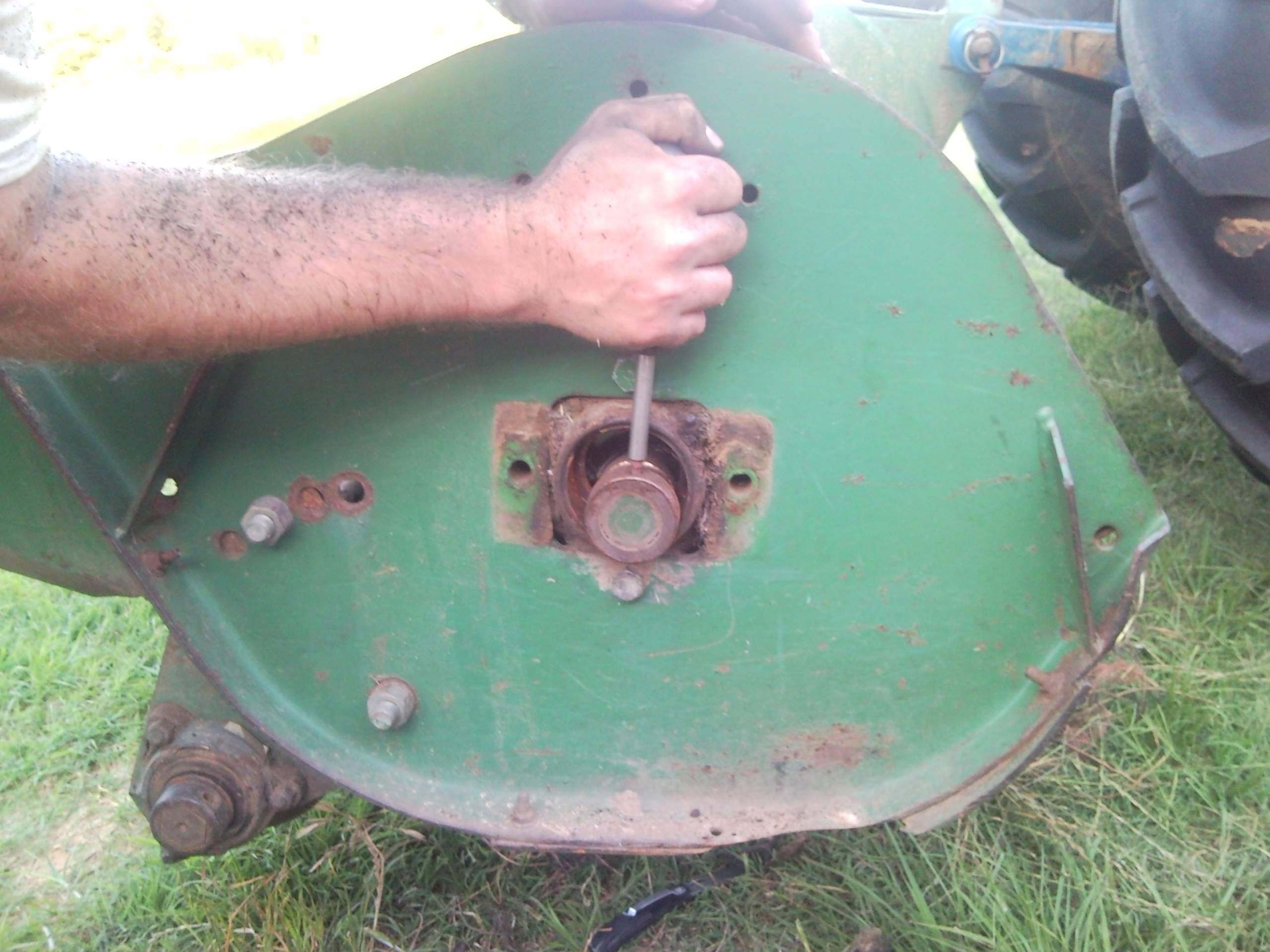

Frustratedly thinking about approach for second attempt

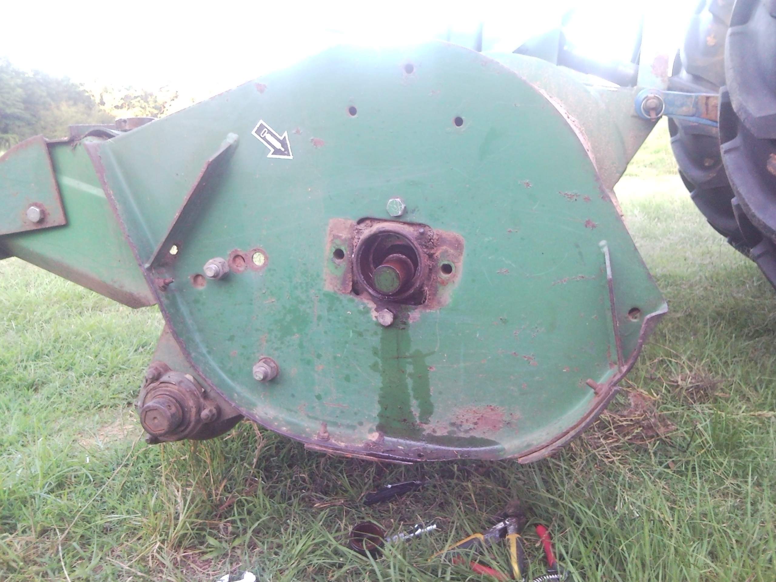

Success
And this is what you have once it is removed
This is where I got hung up. My thoughts were that the bearing would slide on and I would reverse the process and be on my mowing way.

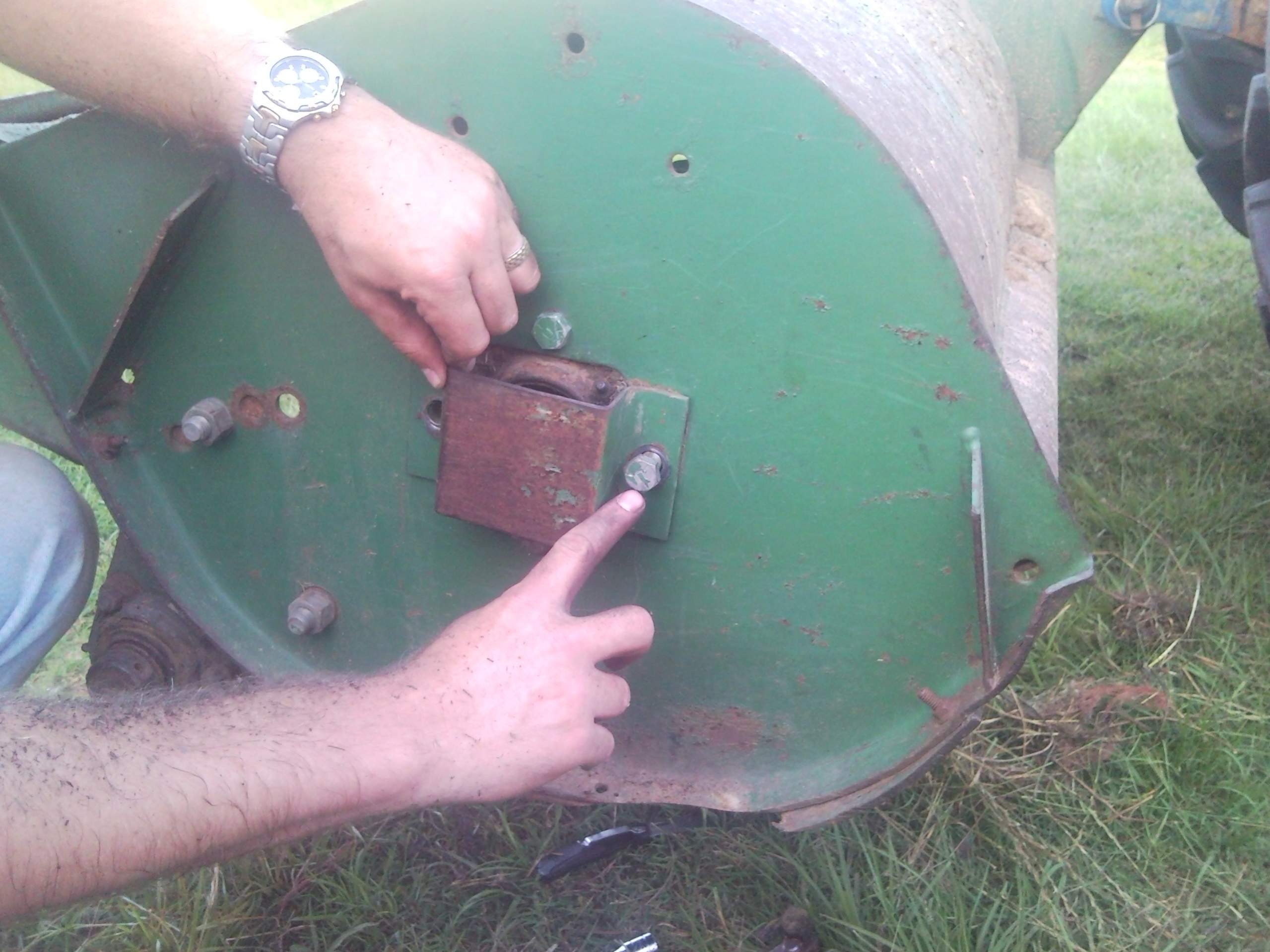

After I realized my new bearing wouldn't easily slide on, I thought that I would have to take the housing off, put the bearing on , collar, shield and move on. While under the mower figuring out how to remove the housing, I discovered the rope. As I cleared the rope, I discovered that I had a square type housing. Armed with this discovery, I looked at my rotor diagram and discovered I had the wrong bearing. At that point, I parked the flail in the shop, hooked up the rotary and went to work so as not to upset the new neighbors.
If yours is the round bearing housing type, the bearing may very well just slide on after the collar is removed. If it does, this is a very easy fix, however if the housing has to be removed, I think the rotor shaft has to be removed for it to happen which turns this fix into something slightly more difficult. Not impossible, just more time consuming. I'll be ordering my new parts this week and when they come in, I'll do a write up for that as well.
