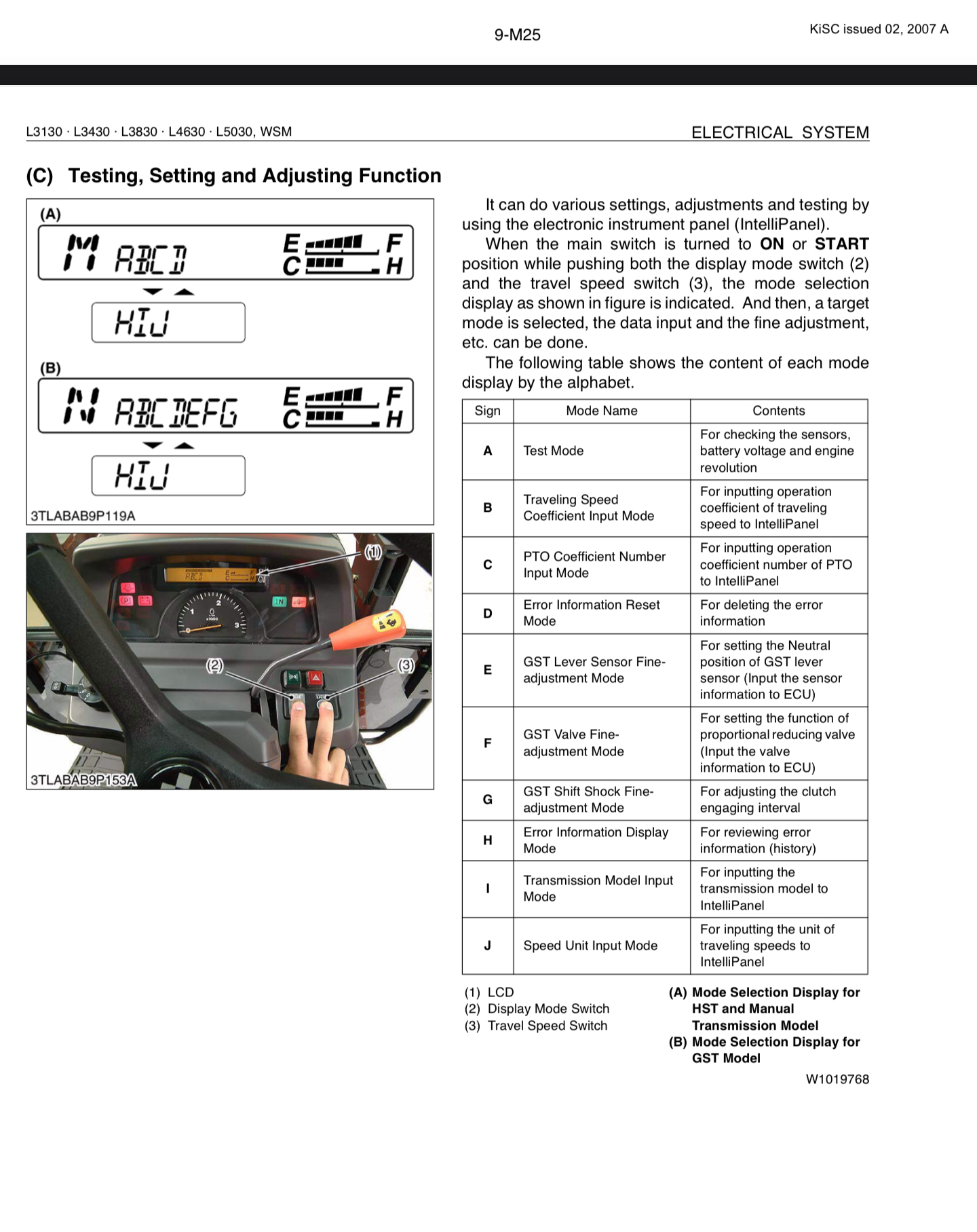

I have a 5030 that I somehow by accident set the dashboard to metric. I would like to get it back to English. Does anyone know how to do this. I have searched the manuals and I must be missing how to do it. (I would think they would tell how to do this, but I do not see it. Thanks John M.
   / How to change the Eletronic dashboard from metric to English on an L5030 #2
It's buried in the WSM electrical section. (Assuming you're referring to a Kubota L5030).
