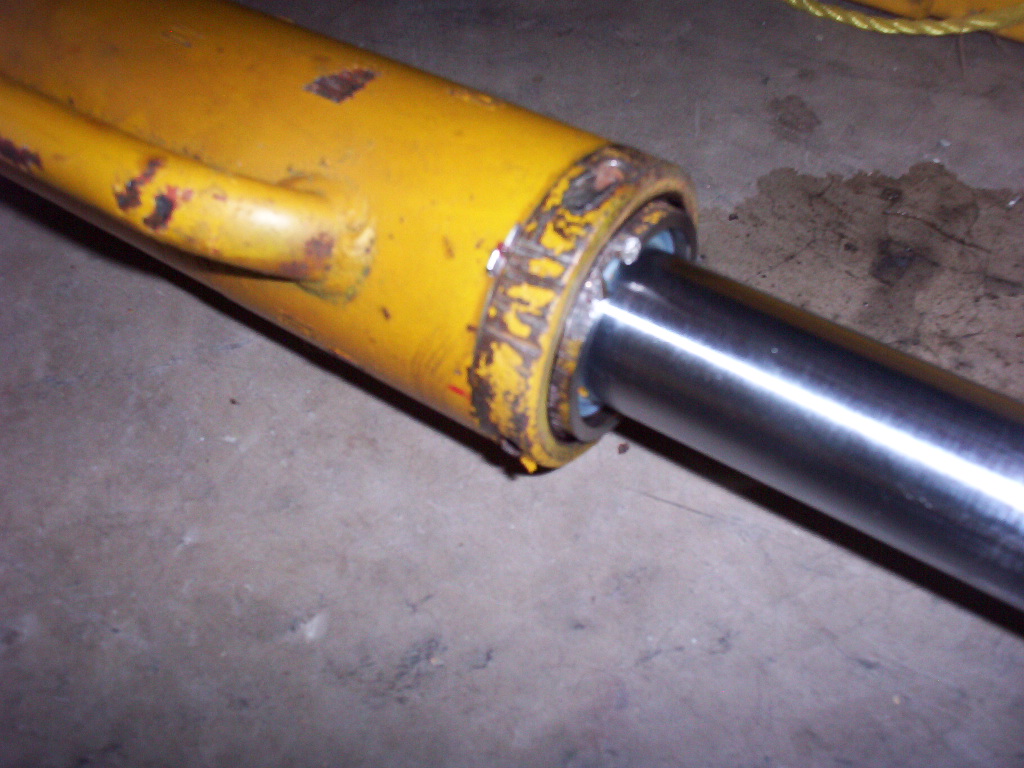

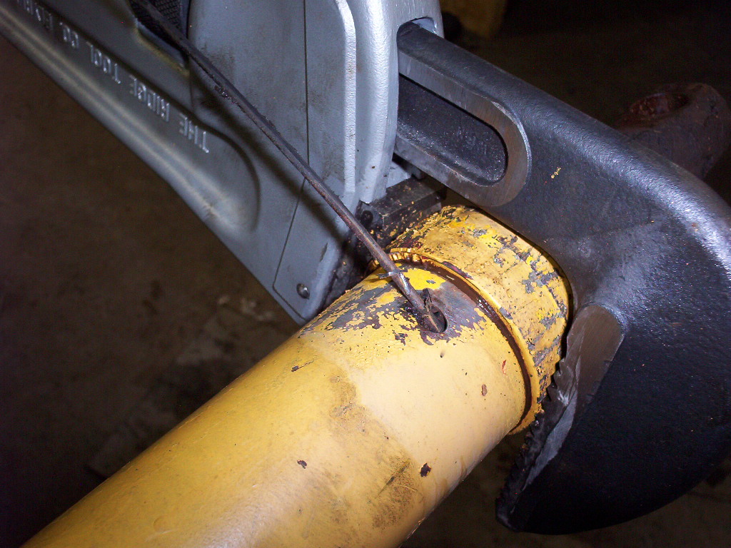

Last week I was doing some trail making and seen one of the bucket cylinders leaking oil at the cylinder of the bucket tilt cylinder. Do not know much about how to change these seals, noticed that you could turn or is it tighten cylinder as there is a flat spot for a 18 inch pipe wrench to fit and rotate, what is this for and how do you change the seals and if so what are the numbers.

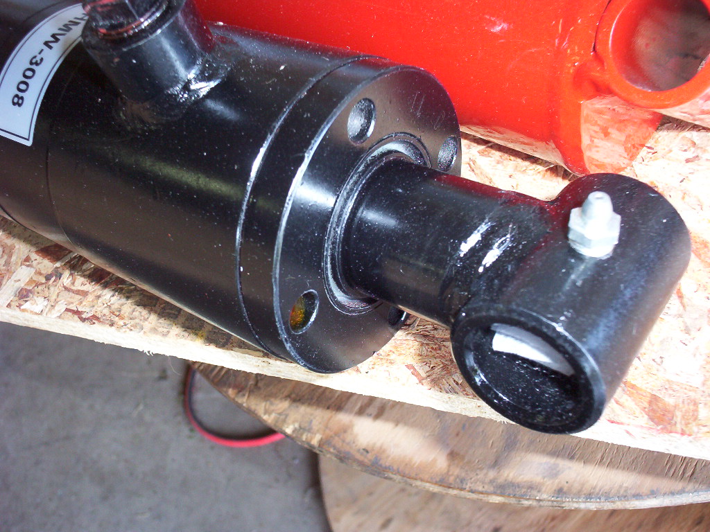

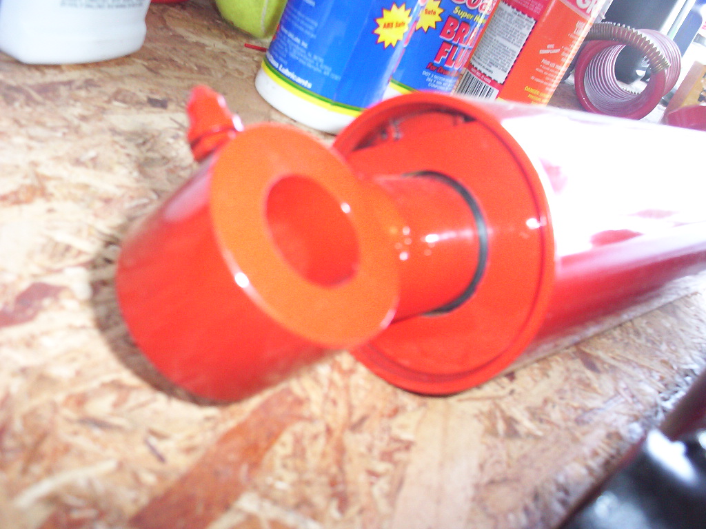

Anyway, I attached some pics of different style glands and how they are retained. There are screw in, wire lock, snap-ring, etc. Anything look like yours?

none of the above, the bottom end is larger than rest of cylinder and is about 5 to 6 inches long, it has two flats that a large 18" cresent might fight over to hold, this part is near the bucket and turns like this is where it comes apart, got some three eight pipe plugs yesterday and a couple of caps and will take a part today, that is remove bucket from tractor anyways, not that fast moving.

That cylinder should have a threaded gland. It uses U-cups for both the piston and gland seals. It is necessary to remove the elbow from the base end port and insert as large a drift punch as will fit into the port AND a drilling in the side of the round piston nut. Once the nut is trapped, the rod is rotated, loosening the piston and relieving compression on the U-cup piston seals. It may not be absolutely necessary to loosen the piston to get the rod out of the bore, but the piston MUST be installed loose and tightened in place at reassembly. And loosening the piston as described is a good way to free it without damage to the O.D.
Edit: After re-reading the original post, you should try tightening the gland. A little more pressure on the gland U-cup stack may stop the leak. It's certainly worth a try.
