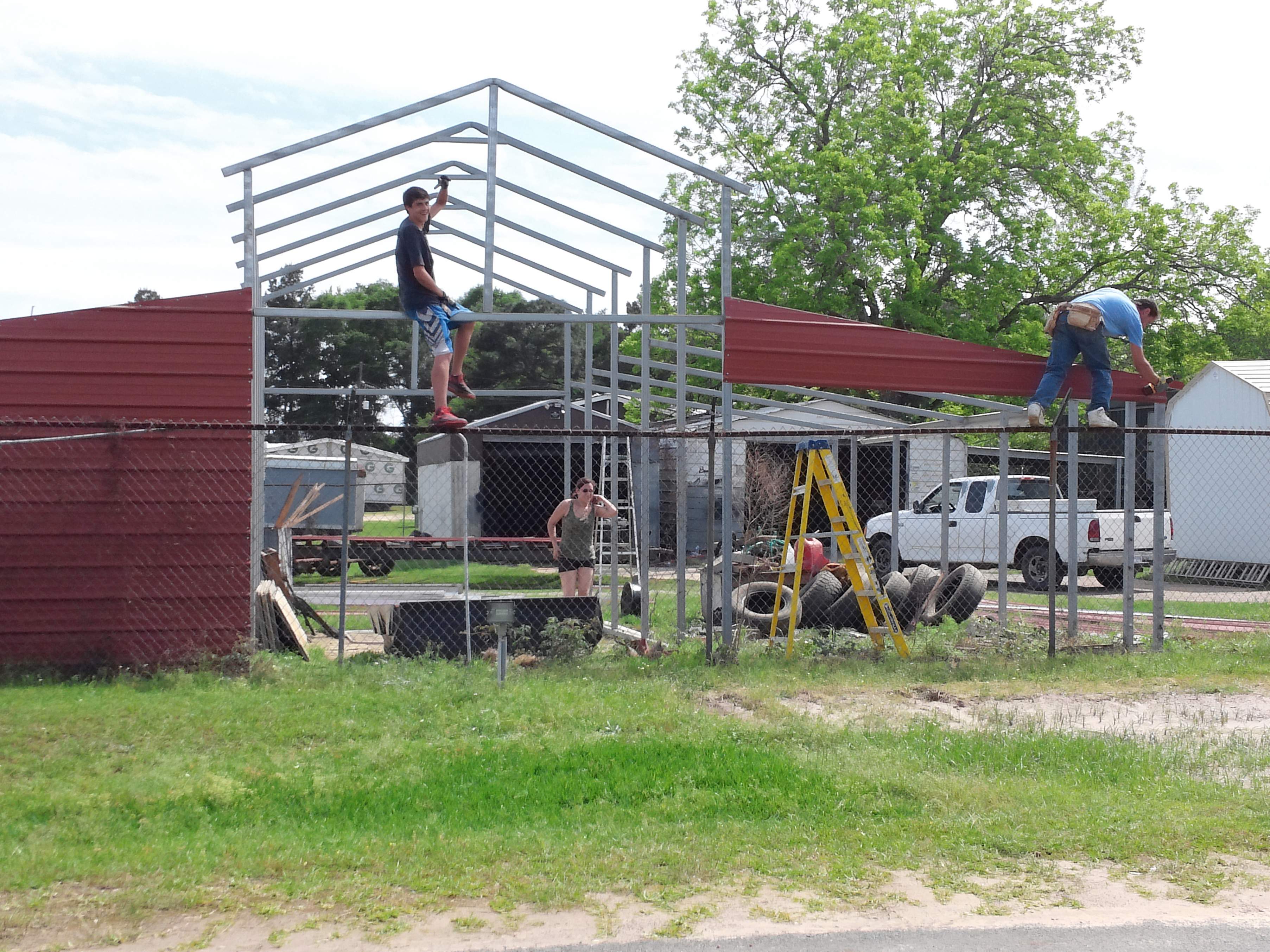

Hi, thanks for the reply... here is link to picture when they were taking it down... my son is doing it... have to tell ya, this was my wife's deal and man I hope it stays up lol.... gonna be expensive pile of metal if it does not lol...
Anyway, the metal posts are not very substantial and I don't think I would put anything on them... course it could be stronger than I think also lol.. I just figured it would be safer to build it independent of the building frame. I could go all the way across but initially was just thinking about down the middle area where it is so high... there can be no middle post so that the tracter will fit inside..
let me know what you think.... and thanks again.....

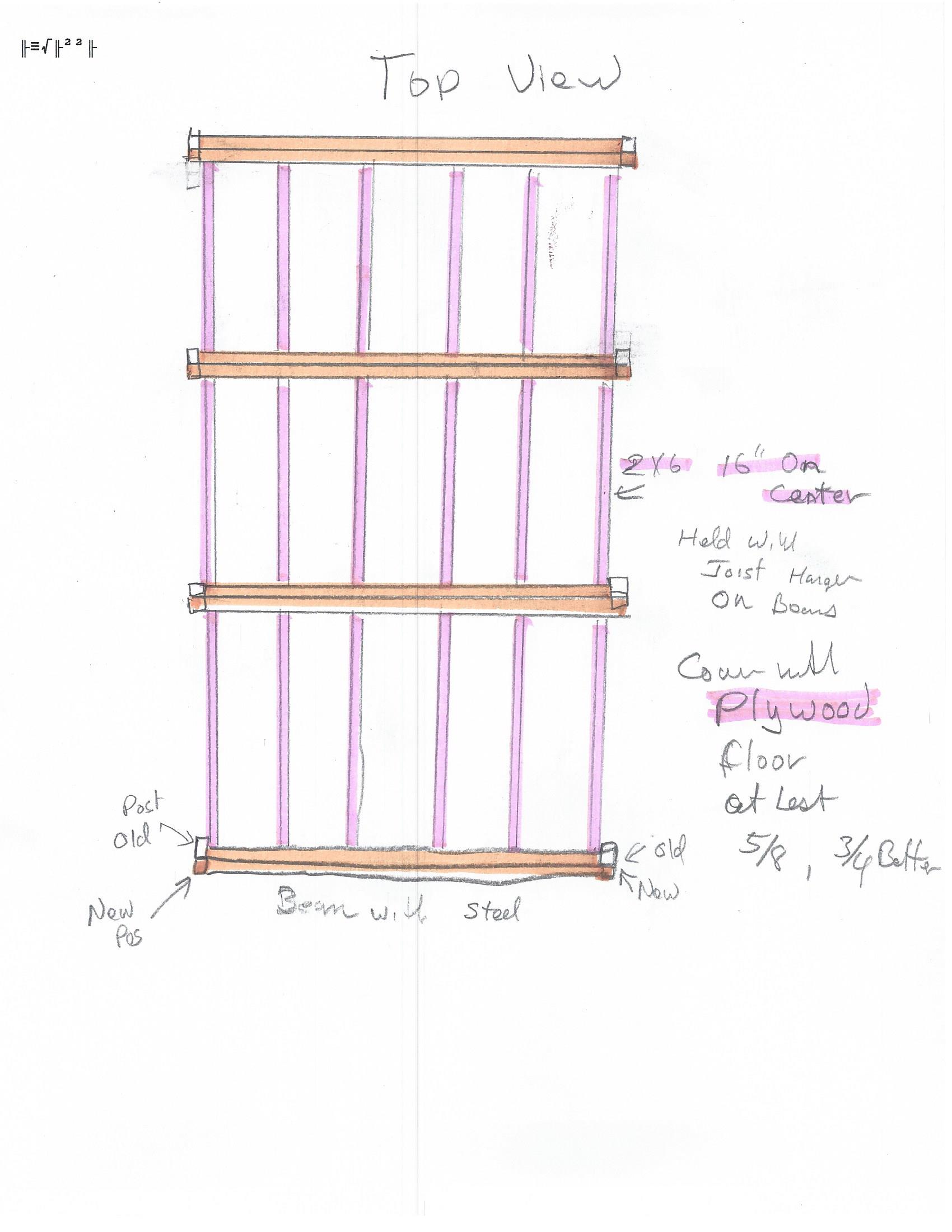

If it was mine and wanted to put a floor in the center section, I would saddle up to the center posts with a second post, (my guess is the posts you have is 2x2" 12 gauge post,
since it is steel building I would most like use steel, and put a flat steel flat, say 1/8 to 3/16, x 7" across the building laping on the posts, then bolt (drill on the ground) a 2x8 on each side on the lap side extend the lap side by the posts and bolt to the post, on the inside lumber cut to length between the posts, (one could skip the steel plate but it would add a great amount of strength).
then use joist hangers and put joists across the beams you bolted to the posts,
Don't know the span between posts but one may be able to get by with 2x6, 16 inches on center, and then floor it with ply wood, at least 5/8 preferable 3/4" ( I may build it all out of steel, but my guess is wood would be easer for you to work with, take 2 light gauge of tube 2x2 and weld a thin flat to spread them say 8" over all and make a I beam like structure, and it would be far stronger than wood, but for joists would be a little harder than wood and most like cost more if a rectangle steel tube was used over 2 x lumber,

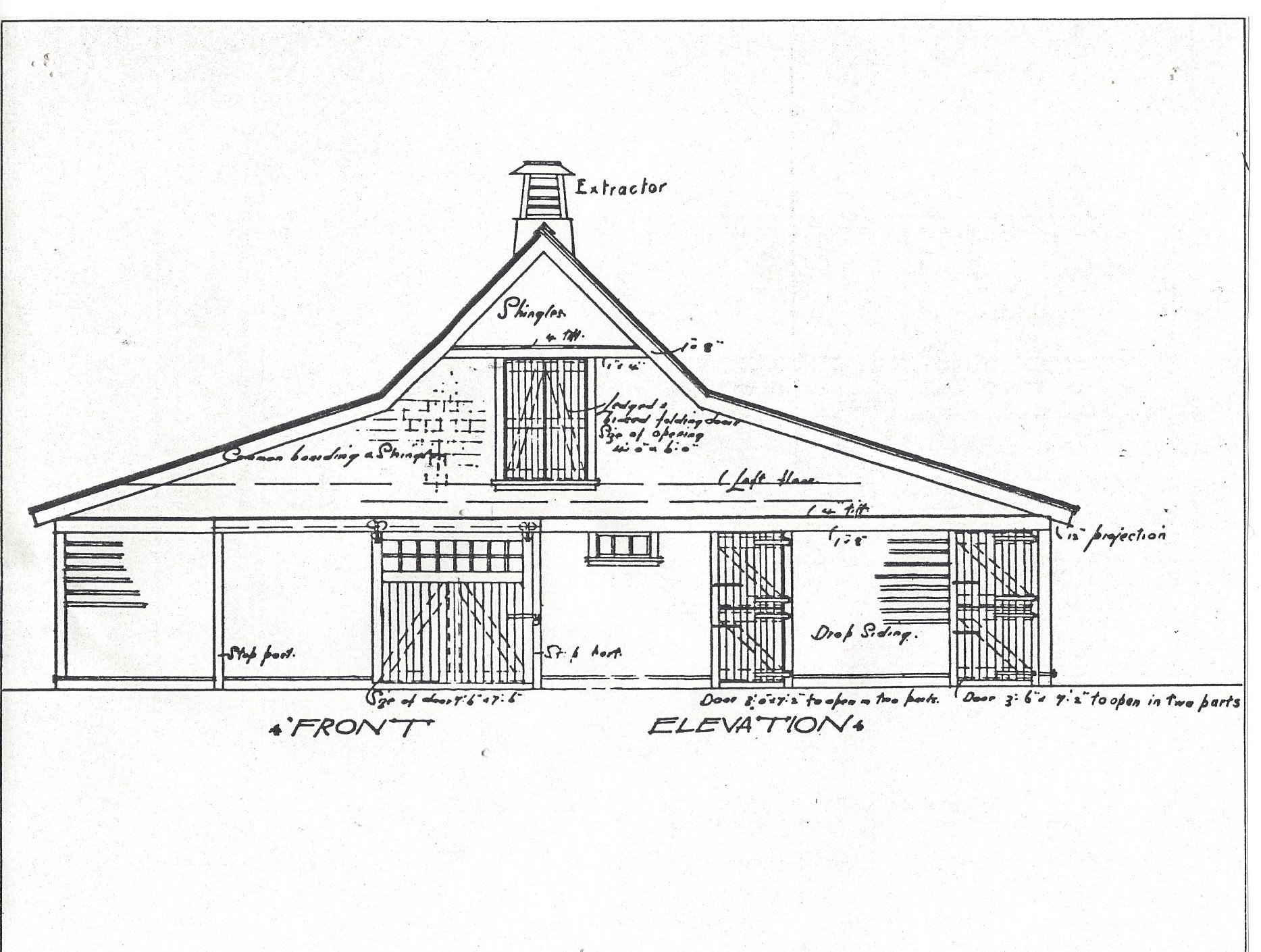

I have similar Idea that I would like to build in time, for a wood shop, patterned off of a old barn plan I found,
I would want the old look, but have considered using a metal frame, use a tube 3x6 or similar to build the frame out of weld it up and then use some rafters put a metal roof on it and most likely stucco the sides, many of my other buildings are stucco,
the ultimate desire would be a post and beam design, with tongue and groove planking for the roof deck but the center would have a loft in it for the stain glass studio, and the wood working on the ground floor, the loft would be enclosed, and wood paneling on the inside, (not the 70' 4x8 sheets but real tongue and groove 1" by lumber.barn Idea 2.jpg
just a dream most likely,
I hope your building works out to your desire,

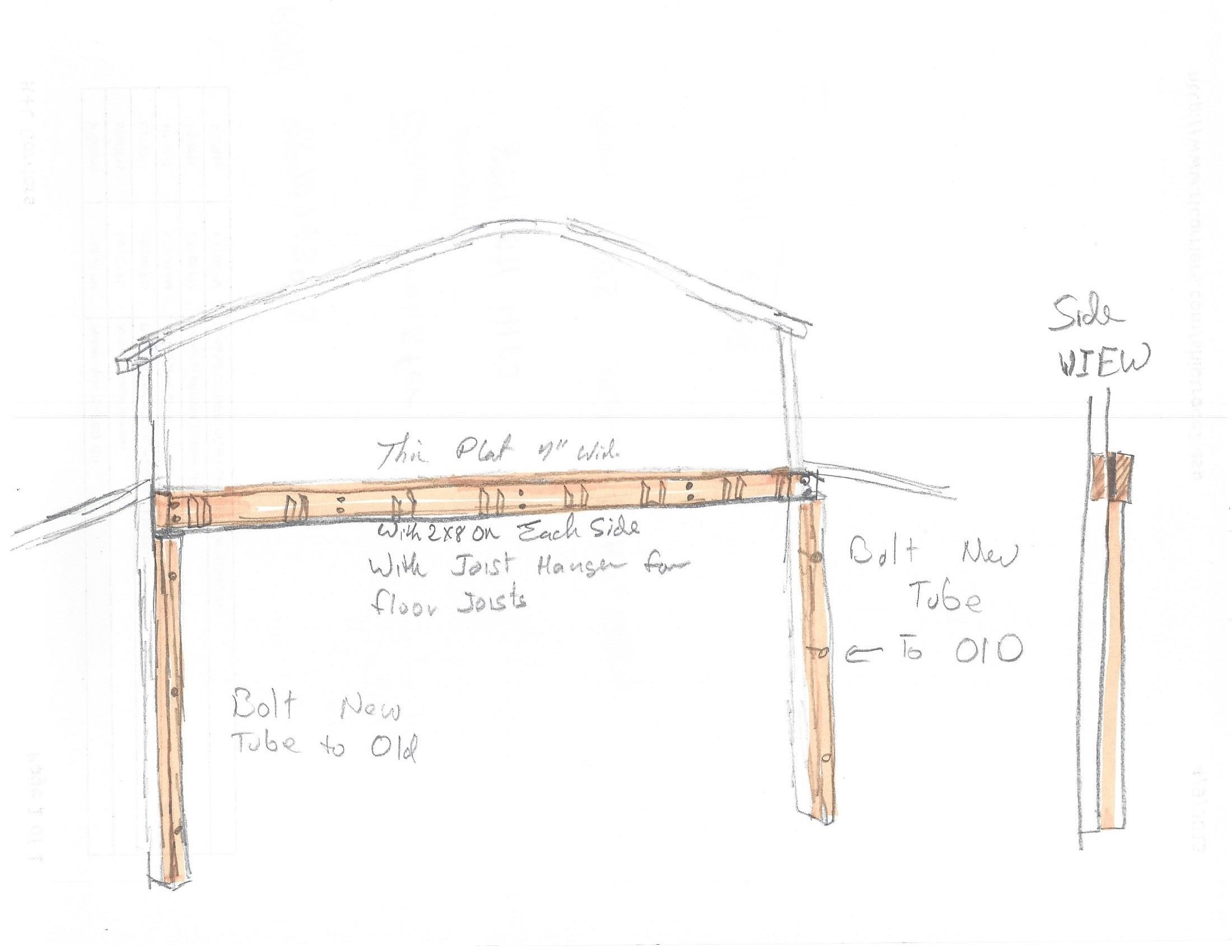

   / How to build loft ideas. #9
First of all why I am recommending the 2x8 is the head room and the loft height, if more room was available I would use 2x12's why I am suggesting the steel plate for added reinforcement, If you chose not to use the steel plate use three 2x8 for a beam lapping one of he at least on to the posts and setting on top of the posts,
my guess your spanning 12' across the middle of the barn, and the tubing is 2"x2" 12 gauge,
the posts look more like 6 feet apart the 2"x6" should be more than able to handle the load if one does not get stupid with what one ups up there,
Use joist hangers and there special nails to install them.
drill as much as one can on the ground, on the tubing drill the new posts, clamp it up to the old and drill the old (the bolts should line up), after the first hole put a bolt in it to keep the post from shifting (keep it clamped).
I suggest 3/4 inch ply wood, for the floor (the quality of ply wood CDX, is not the greatest, and I dislike the wafer board, but if OSB, wafer board is used, 3/4")
below is two sketches,
disclaimer,
Build at your own risk,
I have not see the building or inspected it, this is what I think I would try, but I have not looked up specifications or used a beam calculator to make my choices, this is my gut feelings,
