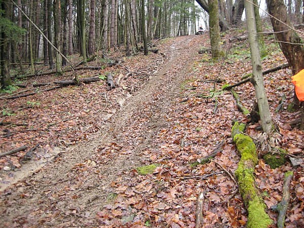

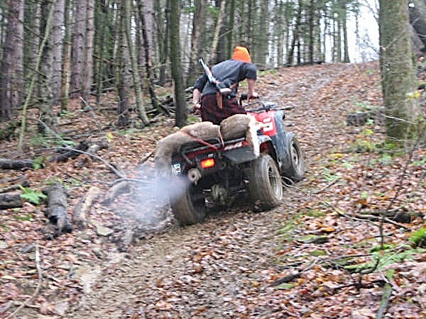

I use a Box Blade with rippers down and back up my with Box Blade up until I get to the top. I have some pretty steep hills and I hang on for dear life. If I lose traction I drop the blade go forward and try to back up over where I just leveled the ruts. Kind of hard to see the steepness....Once I get up to the top I actually hate to come back down for fear of never making it up there again..
