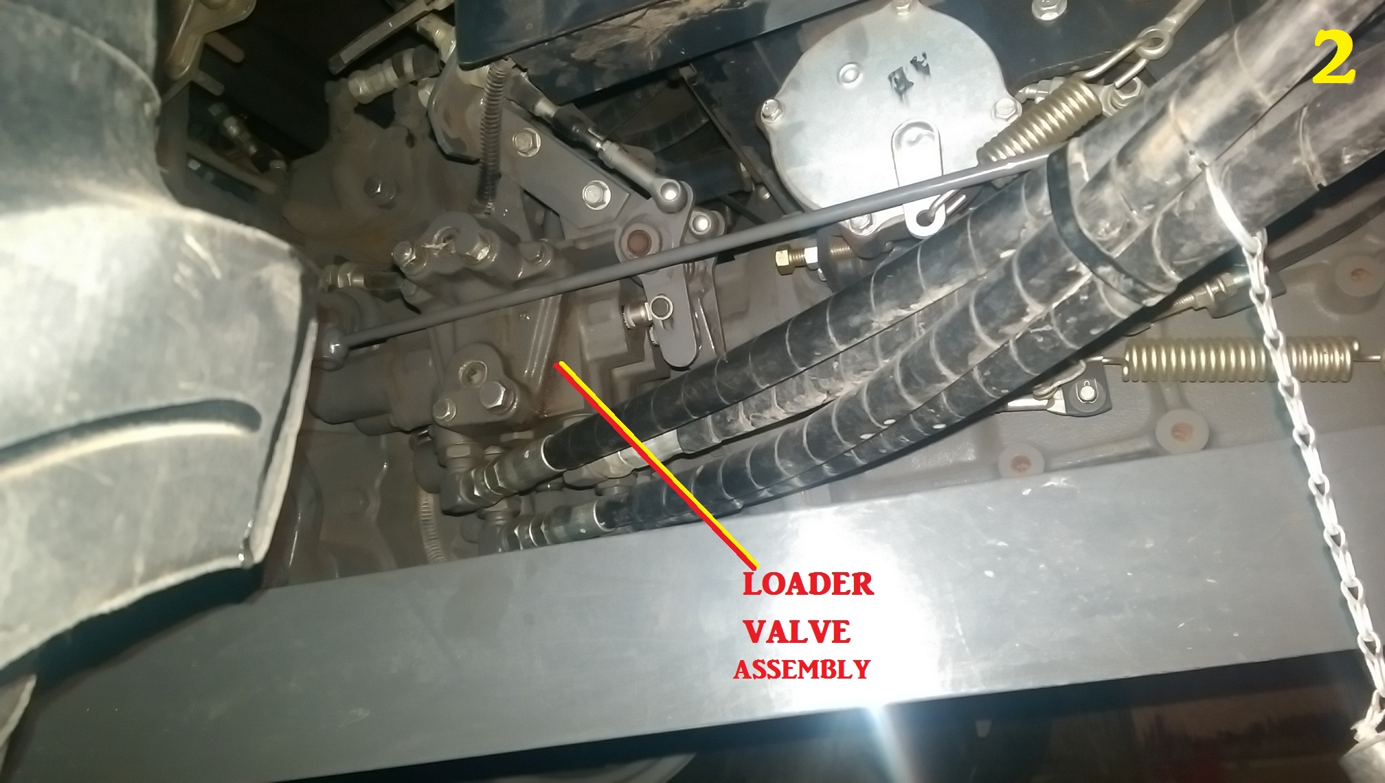

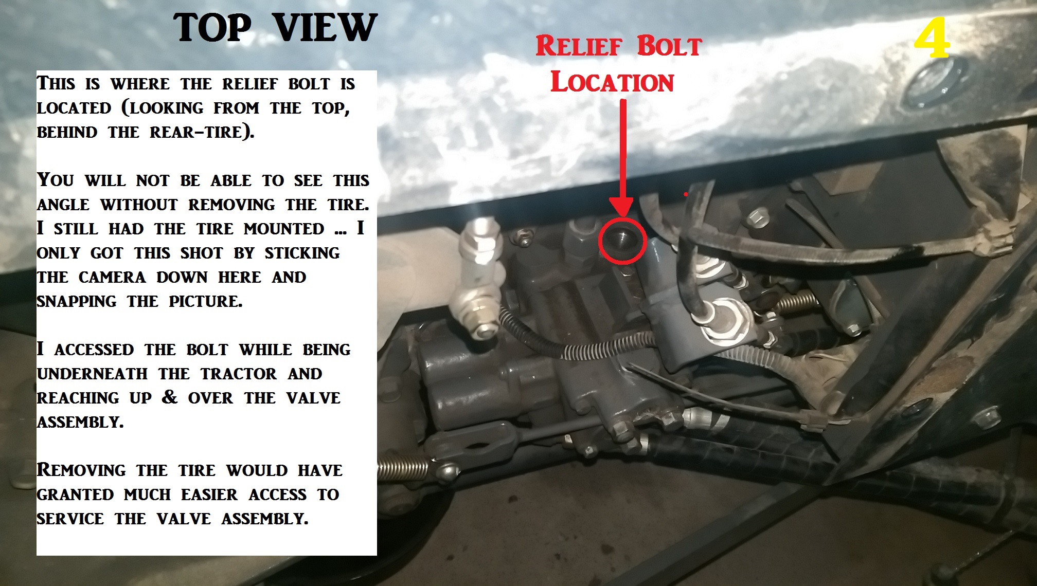

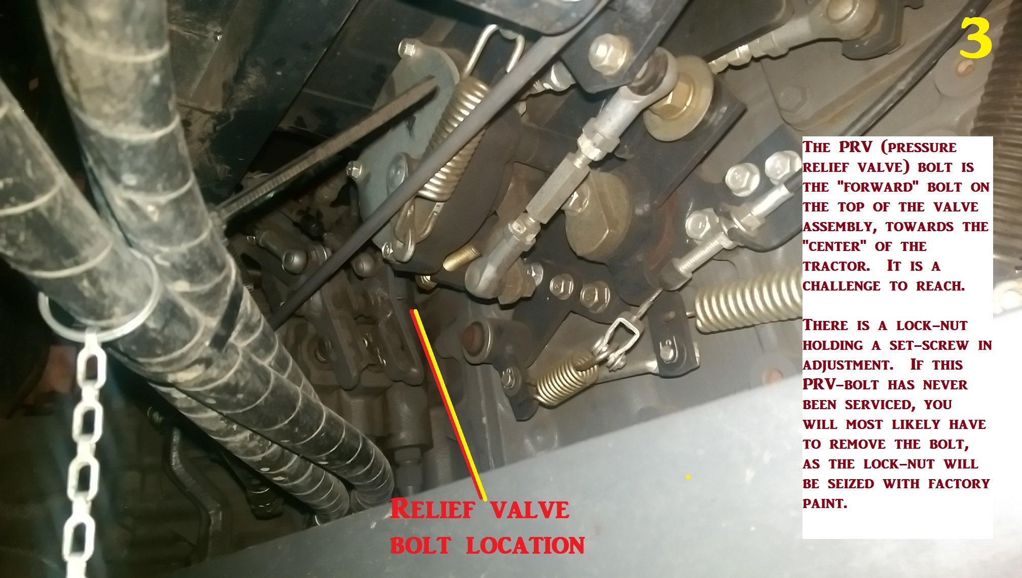

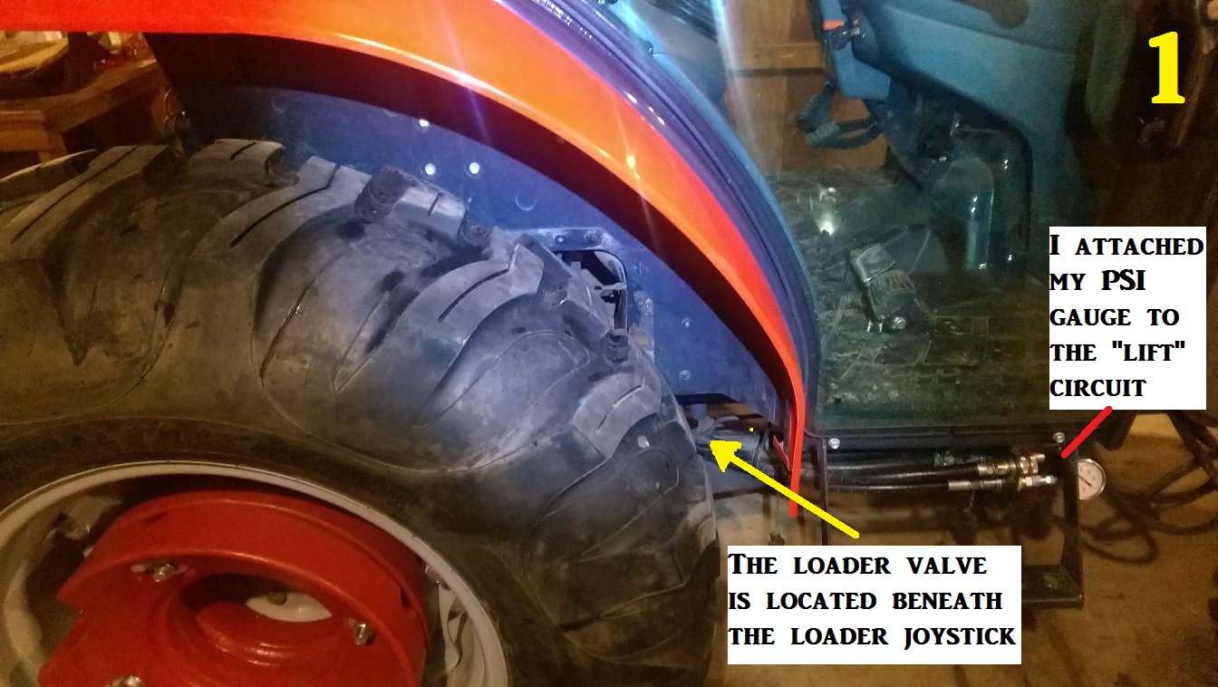

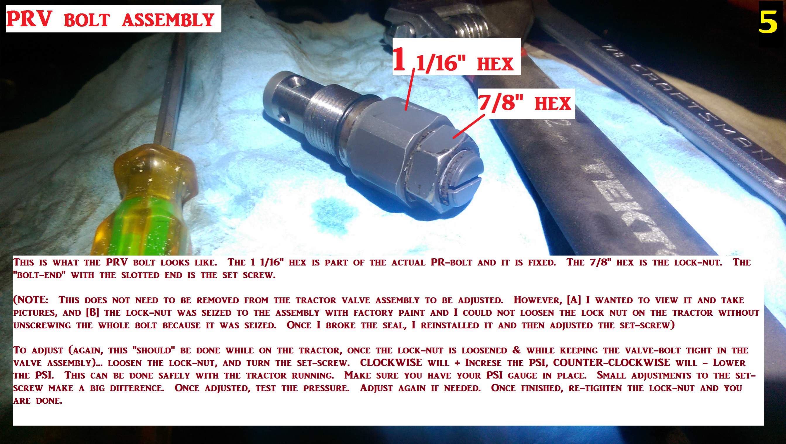

Finally located the pressure-relief valve for my Massey 1648. This should be the same valve-assembly for multiple tractors built by Iseki (for Iseki, Massey, Challenger, etc). Once located, I was finally able to check my relief PSI. My pressure was set at 2350psi, which was low - the manual states the loader relief is rated/tested at 2500psi.
Once I finally located this valve, adjustment was relatively easy. Access is the main opponent, as it is hidden pretty tightly in there. Also, the lock-nut (see pics) was seized to the bolt with factory paint, so the whole bolt needed to be removed to "un-seize" that lock-nut before I could adjust the set-screw.
I am excited to test the loader now with my salt-pallet test. Adjusting to proper specs amounted to a 6% boost in hydraulic pressure going to the loader, which in the case of my previous salt test (51 bags = 2,040 lbs) should increase the lift by 122lbs (up to 54 bags) --- IF there is a direct 1:1 correlation between the % of PSI and the units of weight that it can lift. But I'm not versed in the mathematics of hydraulic theory, so I don't know if that will be the case. I have also been hearing people suggest that it is "safe" to go 10% above the "rated" spec, which would put me at 2750psi ... so I might play with it a bit to find out what happens. I would assume that as long as I stay safely below 3000psi, which my hoses are rated to, I shouldn't break anything ... for limited testing scenarios. Anyhow..............
See pics for a "how-to"

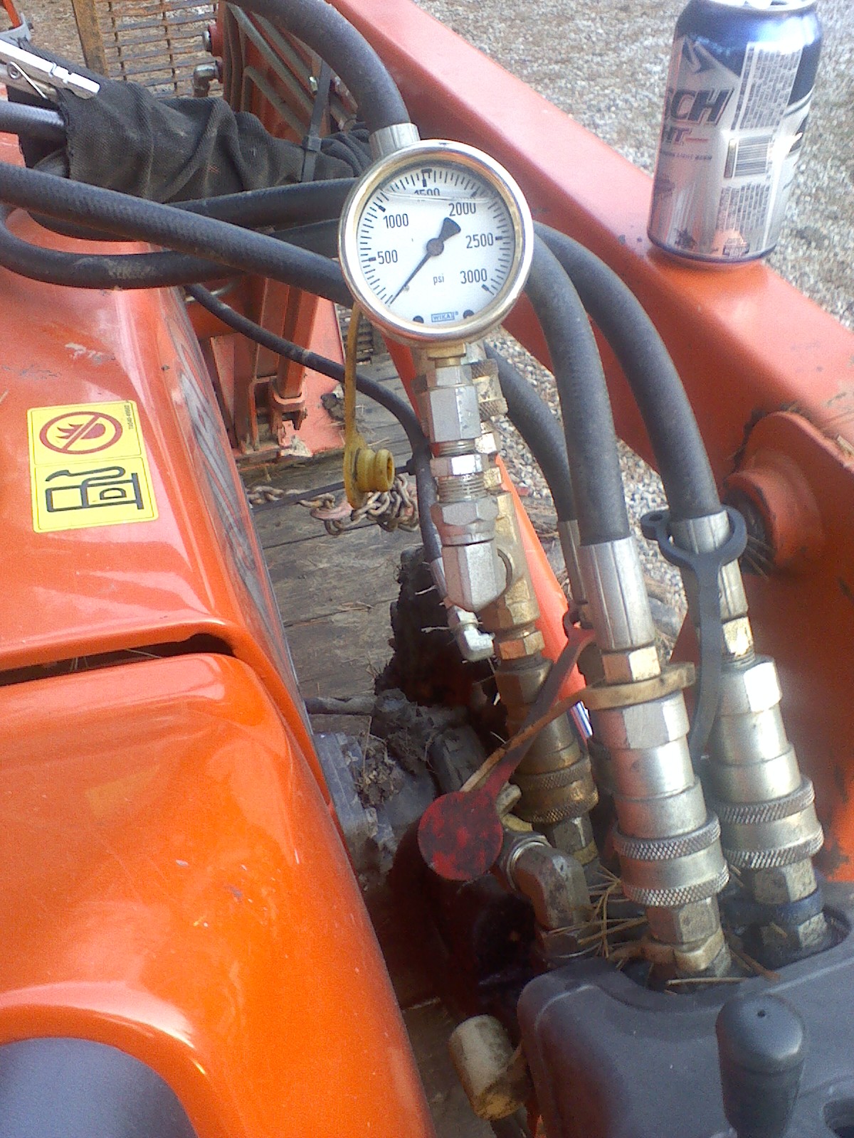

Why not install a tee in the IN port of the first valve and then run the gage to where you can see it while operating the tractor.
The gage can now be used for general operation and troubleshooting.
The gage will tell you when you have pressure and how much.

I see you are not using the official Orange Kubota clothes pins on your hydraulic hose cover!
Shame, shame, shame........:rolleyes:
   / HOW-TO-ADJUST (with pictures) Loader Relief Valve - Massey / Iseki / Challenger / etc #5
Shame on someone else as the picture is just a picture , not my tractor. .
The beer is optional.
I'm not worried about viewing it while driving... Only for diagnostics.
