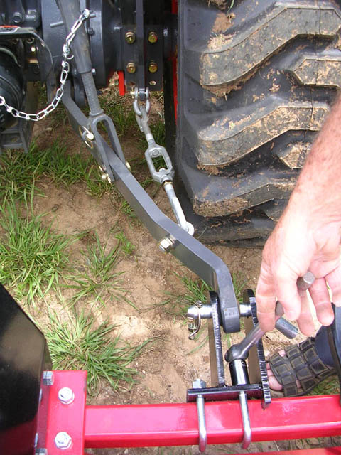

I decided to drop the backhoe today so I could mount the new tiller and get the garden ready. After the tiller was on I noticed the turnbuckles on the lower arms rub the tires. It looked like I needed to loosen the pin brackets on the tiller and slide them in...so I did. I took a pic of this. Now, as long as the tiller is level nothing rubs....but when I till and make a turn or on unlevel ground the tiller will sway and the turnbuckles rub again. Should I move the brackets in more or is there some other adjustment I need to make to remedy this? :confused:

Judging by the shiny paint, this is probably the first time that tiller's been used. As such, I'd say that you need only make a one time adjustment of those pin brackets. Cat 1 lifts pins are typically 26"-27" apart, but I'm not sure if that's center to center - or an inside measurement.
At any rate, after relocating the lift pins you then reattach the lift arms. The side links may need adjustment to center the implement and to minimize side-to-side movement. It should follow straight behind, not offset - neither should it be wagging around back there like a tail.

Move those brackets in more, your problem will be solved:D
/ How To Adjust This? #5
I'm pretty new to tractoring as well so there may be better advice, but here goes. Park on some flat ground and then manually swing your tiller so that it is centered between the wheels and the turnbuckles have some clearance. Now, tighten up both turnbuckles so they become rather rigid. This should control the side to side swing of the tiller. Also, when the backhoe goes back on make sure they are good and tight or the backhoe will swing side to side as well.

The turnbuckles are needed so the implement will not sway back and forth causing even more problems with tire rub.

I agree with Kenny. Most the brackets inward, that your wrench is shown tightening.
Kinda strange that your turnbuckles are outside the lift arms. On my tractor and others I've seen, they're inside. You definitely need them to keep the implements from swaying.

If you don't want to create more marks on your paint by moving the brackets inward, then just turn the brackets over so the offset moves them in a little. It won't take much so if you move both sides by the amount of the offset, it should keep the chains off your tires.

Thanks everyone for the quick replies. I measured center to center on the brackets and they are 32" apart. If they should only be 26"-27" then moving the brackets farther inward should solve the problem. I like the idea of flippin' the brackets to save the paint. I never even noticed that they were offset.

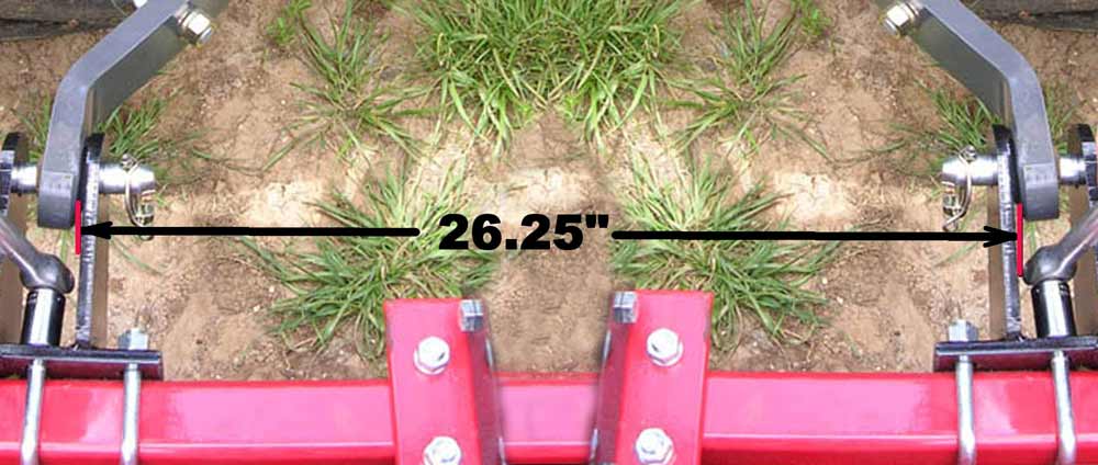

Set your spacing at 26" inside measurment and enjoy . Since this is your first time to run the tiller did you adjust the PTO shaft length accordingly if it needed it?

Thanks wushaw...I will adjust to 26". I had read elsewhere that the PTO shaft on new tillers may have to be cut down if they are to long....so that was one of the first things I checked on mine. Luckily it seems to be fine. I ran several passes through the garden plot and the only trouble I noticed was the turnbuckles dragging. I think we will be good to go after the adjustments.

Rigid link anti-sway devices should work equally well either side of the arms. Mine (greymarket Yanmar) are outside like the picture in the OP. Chains, on the other hand should be inside, between the arms. Otherwise, with no implement mounted, they won't restrain the arms from swinging out and contacting the tires.

Here is where to measure and then adjust your sway links to where you have about an inch of free play. Where the tiller will sway back and forth about an inch.

I have an L3400 which has the same setup on the 3PH as you. With standard Cat 1 implements and R4 tires there is only about 1.5 to 2 inches between the turnbuckles and the tires. Adjust the turnbuckles to where there is just a little movement and tighten those lock nuts. Use a wrench or screwdriver to hold the turnbuckles and tighten the nuts tight or they will come loose and the turnbuckles will rub the tires. Do not remove the check chains.
