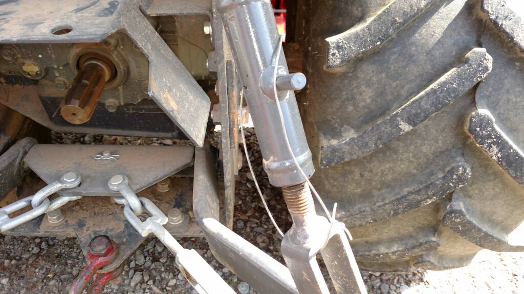

I have a 1705 also but my adjustable arm kept backing off even when I tightened the lock nut so I put a piece of wire on it to keep it from backing off. IMG_20170402_151628135.jpg
   / How to adjust 3PH to create tilt for Box Blade #7
After having lost a turnbuckle I now always safety wire mine and any other component that might come off.
Also serves to 'lock' your adjustments.
Constant vibration plays ****.
