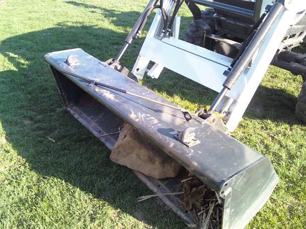

I was going to weld some hooks onto my bucket, but before I got to it, I needed a way to hook a chain to my bucket to lift an old trailer that I was scrapping.
I got to rummaging around in the barn and found a construction shackle, and it fit the brackets that are existing on my bucket ( im not sure why they are there, and havent noticed them on any of the pics I have seen on here) but that shackle worked great, and I have left it there. Hasnt seemed to bounced or even scratched the paint so far.
I think I will forgo the hooks unless I find I need them down the road

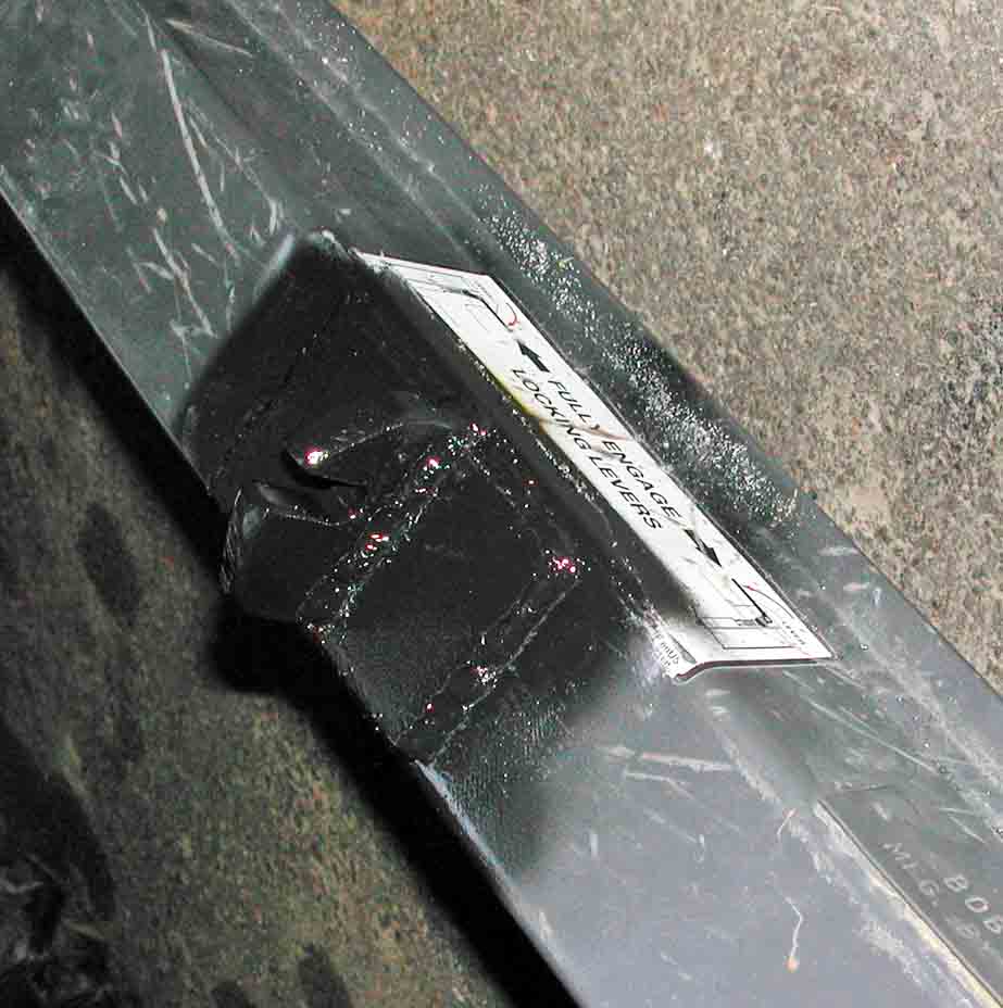

That might have been me.
I did use a reinforcement plate. The Bobtach carcass seems robust, but
the 1/4" plate I used will avoid problems. I really like how it works: I can
lift much more weight with the bkt off. I prefer slotted 1/2" steel to
hooks as they allow easy detachment (roll back and the chain drops off).

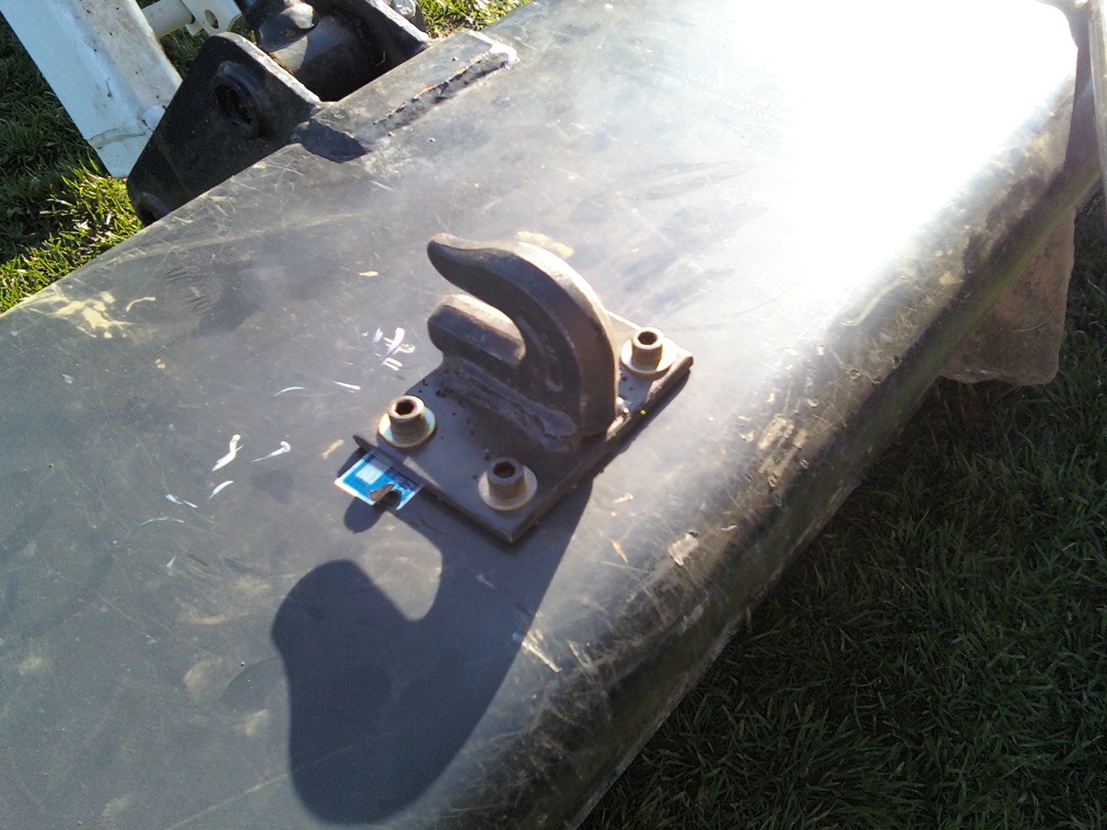

I bought the same hooks as you got. I welded them onto 1/4" plate about 4" x 3" and then bolted them on with (4) 5/16 bolts each. I have the standard bucket which is 11 gauge (.1196") thick. I thought that was a little thin to be welding directly to. The hooks are mounted forward as possible, the nuts on the underside are right up aginst the rolled edge.
I use mine almost every time I've got the tractor out.

Arch, here is the pics of my shackle and bucket.
It is attched to brackets that I have on both sides of my bucket.
I do not see these any on anyone elses bucket in pics I have seen posted on here, Im not sure if I got a bastard bucket or if it was built for putting a grapple on it
   / How thick is the metal on the Bobtach? #10
No bastard bucket. I have that one too. The pin on bucket is totally different. I think our bucket is a skidsteer bucket.
