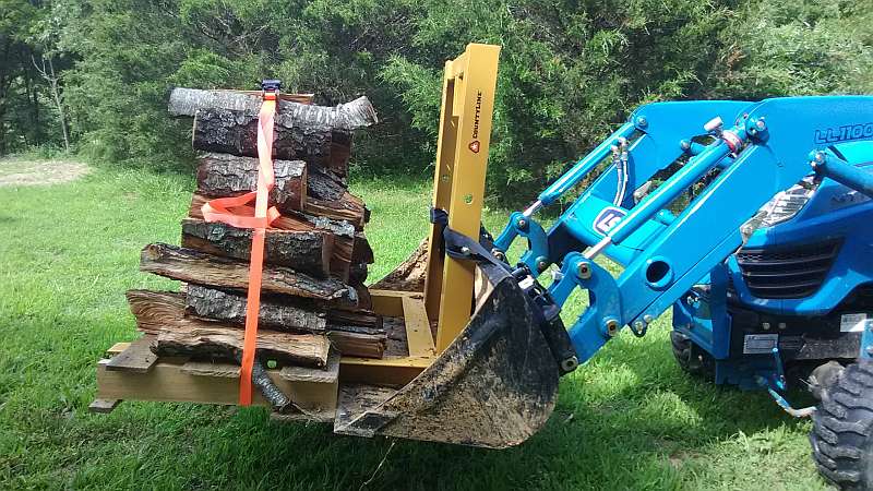

A while back I asked about clamp on pallet forks: https://www.tractorbynet.com/forums/attachments/408400-question-pallet-forks.html
Discussion implied they were OK for limited use, but you put the load too far out front which reduced capacity and there was a risk of bending the bucket lip. Some said a Carry All was a better idea since you could back in and lift more load. So, I got one. I'm pretty sure that's how this happened: https://www.tractorbynet.com/forums...rating/412555-how-avoid-bending-lift-arm.html Responders there said it could happen with compression. The more I thought about it, that's probably what did it, backing in and hanging up on the pallet slats. There was also discussion of needing to be able to tilt which I can't do since I don't have the extra hydraulics.

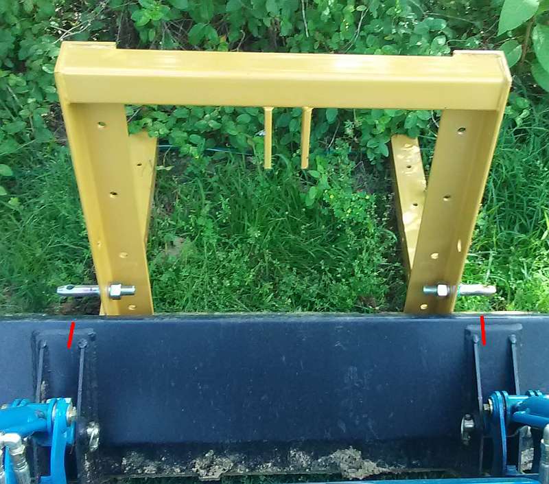

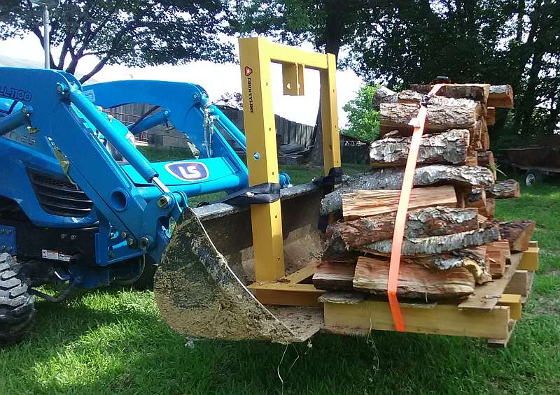

So, this morning I came up with this idea: CarryPallet1.jpg CarryPallet2.jpg
This puts the load a bit closer to the arms and also eliminates the weight on the lip that the clamp on forks would apply. For this test, it's held in place by ratchet straps hooked to the bucket attachment points. I'm planning on adding bucket hooks at some point and people say to align them with the arms. So, if they are about where the red marks are, that aligns them with the 3 point pins on the Carry All. I could use some larger U-Bolts or Muffler Type clamps from the bucket hooks to the pins and maybe even do something else higher up the Carry All frame to help alleviate the front loading even more.
Remember, I won't be lifting full pallets, only ones I've cut down. Pictures show the Carry All 'forks' all the way through the cut down pallets. I moved two today with this test/temporary setup and had no problems at all.
So, how stupid is this idea? What might I have missed? Be honest, you can't hurt my feeling since I don't have any.
(I certainly can't be the first one to have thought of this. I know others have, so don't be afraid to chime in and tell us if it worked or not.)

I'm looking for safety or functional reasons I might have over looked. For example, will this pose a risk to the loader arms?

It looks like it works good and I知 all for saving money. If the clamps don稚 hold, why not get a 2 sets of bolt on hooks to keep it from shifting side to side and chain the carry all to the bucket. You could also get the shackle mount bolt on where all you would need is 1 short chains and 2 Clevis hooks to secure it and it wouldn稚 take but a minute or two with a wrench to unscrew on side of the chain and slide it off and use it on the rear or to use the bucket. The bolt on hooks just need a drill and bit to install them. I think kennyd has the clevis mounts too and from what I have read on here, everyone loves the bolt on hooks.
   / How Stupid Is This Idea? (Related to Pallet Forks) #10
While I can't see all the routing of the straps, what I can see there might be a possible problem if the bucket was dumped a bit too much - to the point it causes the bottom of the carryall slid out out the front of the bucket making the straps/pins becoming a point of rotation.
Though if there was a need to dump the bucket that far, I'd think running some straps to hold down the lower arms of the carryall should solve that issue.
Depending on the terrain it might also be worth considering/trying an approach where the straps are threaded over the carryall pins to the far/opposite side of bucket to help remove the potential for the carryall sliding across the bucket as well .... so I think the simplest solution to solve both possibilities (though it may lose an bit of usable length on the carryall arms) would be to run the straps from the right pin on the carryall to the left side of the left loader bracket (or through one of the brackets on the bucket) to the lower left arm of the carryall/ Then doing the exact opposite for the left pin on the carryall, so the carryall is strapped to the bucket at both the top and bottom of the bucket with the straps crossing sides (and not being able to slide). That should pretty much eliminate the potential for the carryall moving/sliding relative to the bucket.
However, going to that extreme may not be needed if you're doing this over fairly gentle terrain, and can keep the bucket relatively level or curled back so the bottom of the carryall is always being pushed into the back/bottom of the bucket (in addition to the top/back of the carryall).
