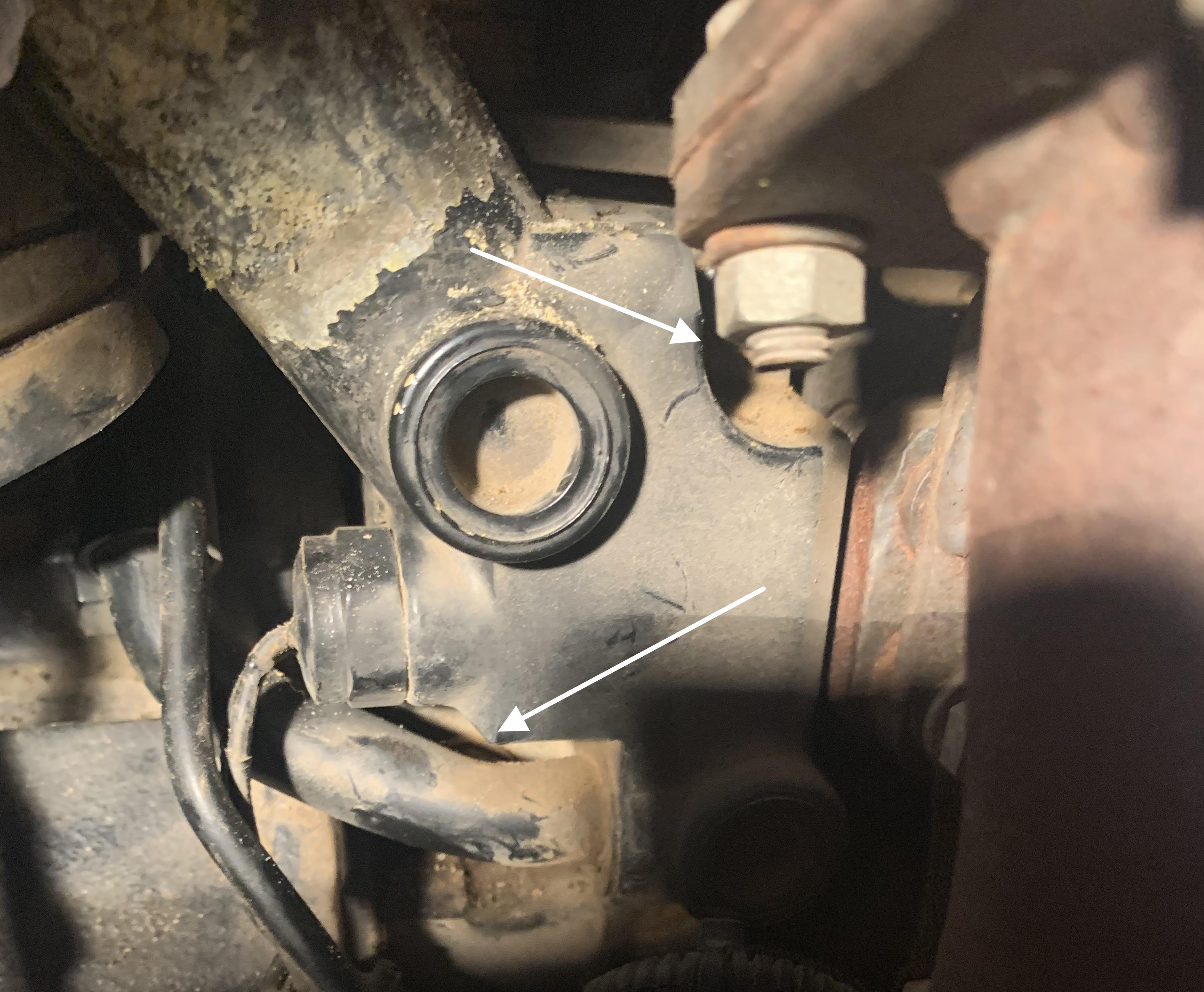

My TYM 550 started overheating, so I'd like to pull the thermostat. But I cannot see how to get both bolts out of the cover, picture below. The arrows are where the bolts are. The upper right bolt has maybe just enough clearance from the exhaust connection for me to get a socket in there. But the lower left bolt appears hopeless, as it is directly behind the metal heater pipe. There must be some trick to it. Anybody?

maybe the heater pipe has to be removed first, this reminds me of mercedes benz cars, where everything is close quarters, and you had to do a lot of disassembly just to do minor things!..
Any idea if/how that pipe detaches? It's the rigid metal tube below the lower arrow in the picture. Even if it has a fitting that unscrews from the thermostat cover the bend in it will prevent any rotation until the cover is freed anyway.

   / How on earth do I access this thermostat??? (TYM 550) #10
I would try good radiator flush and new pressure cap before I borrow down layer by layer to get to thermostat...
