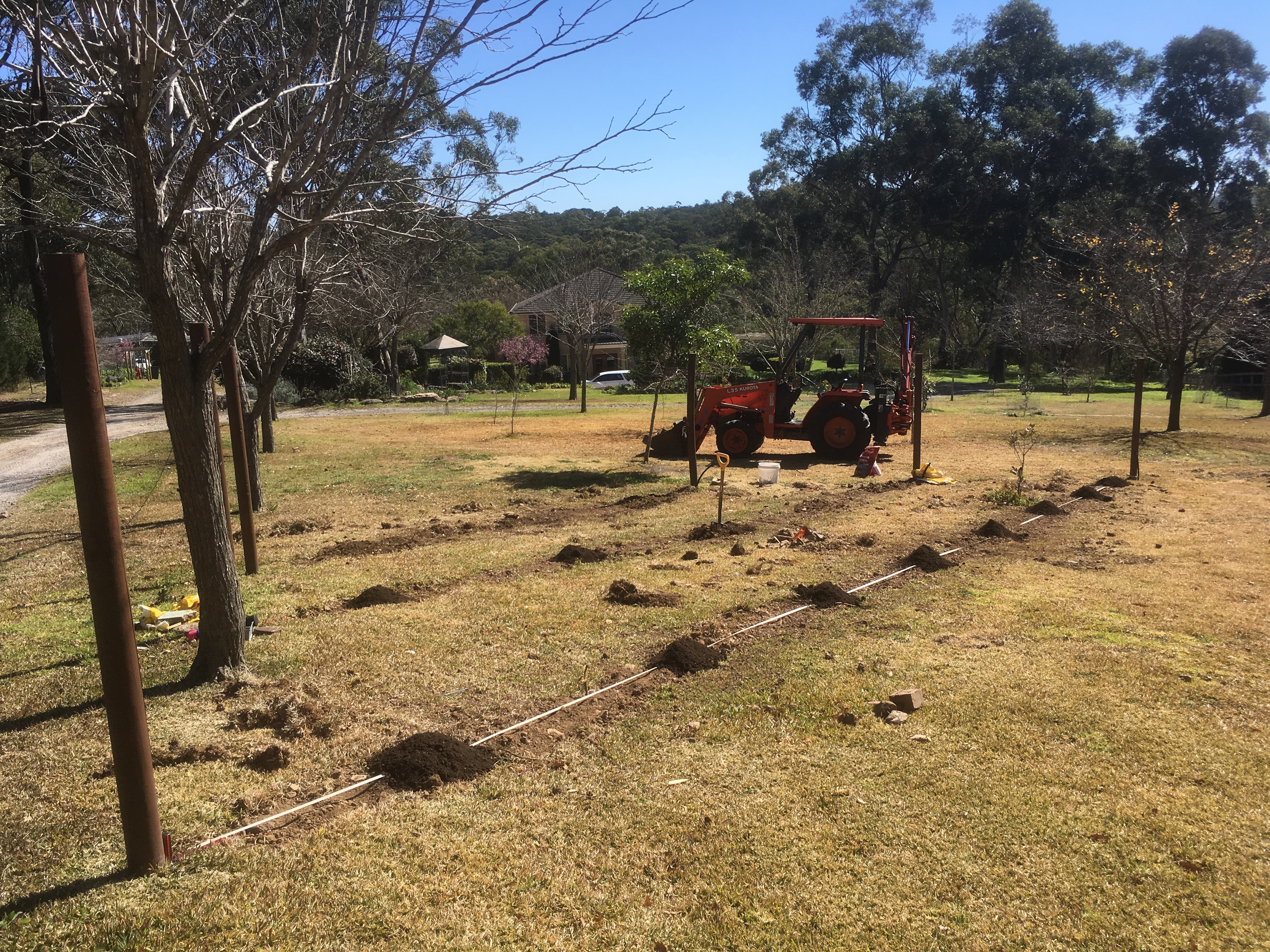

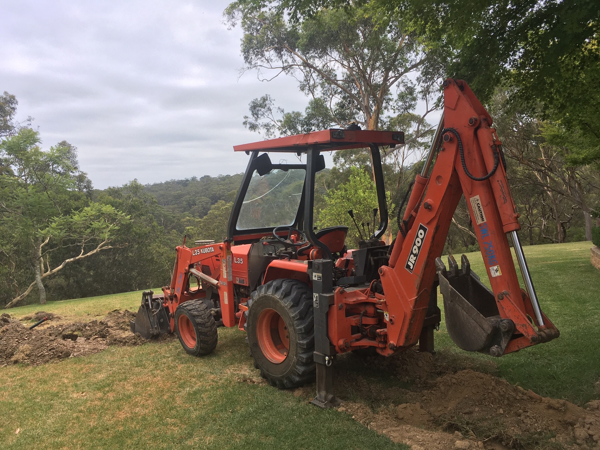

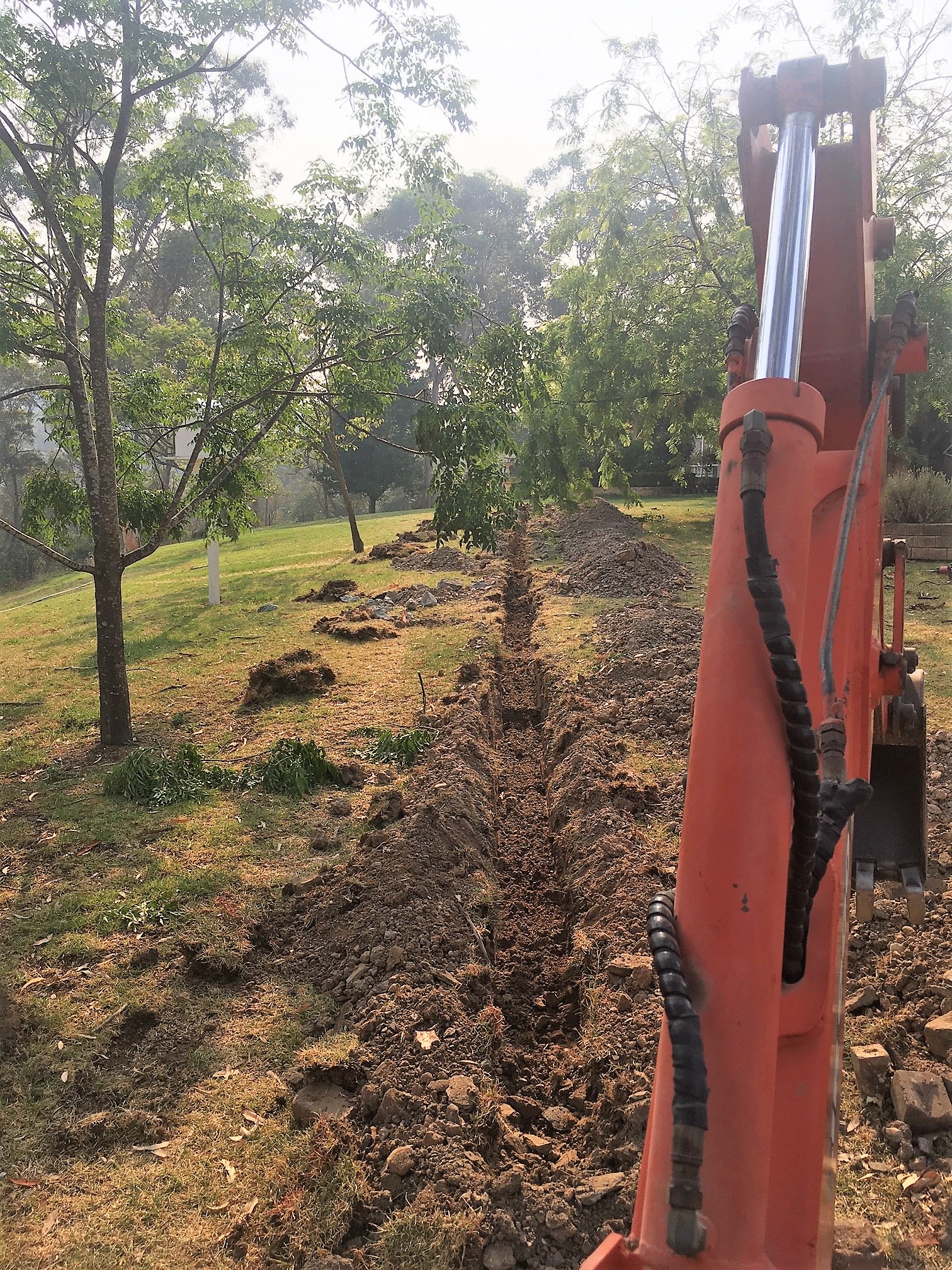

I love the backhoe on my machine, seriously for my purposes the machine would only half or even less valuable if I did not have one. Fire - Outlook.jpgFire - Trench (2).jpgVineyard 2.jpg
Recent usages have included digging a 100 yard trench for running pipe work from water tanks to our house for bush fire protection (as you will have heard in Australia we've been hit heavily) We are in a vulnerable location so the pipes should be a couple of feet under the ground. We have been planting a number of trees, building new garden beds, all jobs where the backhoe was invaluable. Other applications have involved digging out the root balls of dead trees, again an impossible job unless you have hours of time and many helpers.
As my skill level has grown I find I can use it more and more.
Good luck
