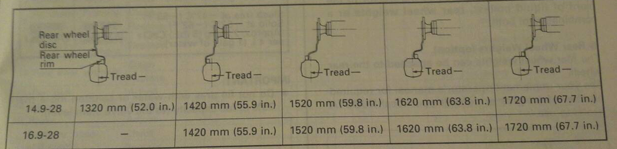

I've never done this before.
I understand swapping side to side (to keep the tread design pointed in the right direction), however, the concept of 'turning around' the inner part of the wheel to get maximum 'narrowness' gives me pause.
It's around 64" currently...anyone know if I can tweak it down to 54" or so?
Regards, Scotty

If you have the frame and fender clearance it should work. I don't have a clue how narrow you can go though.
   / How narrow can a 3215 be with Ag tires turned all the way in? #3
What he wrote.
My M4700 with 14.9 28 rears goes from 52" to 67.7"
378782d1402434660-how-narrow-can-3215-ag-m4700-wheel-spacing-jpg
But when adjusted down to the narrowest it rubbed the fender.

I rushed back to my 3215 owner's manual...looked twice...no such luck on an equivalent chart. However yours appears close to what I've got...and helps to explain disc/rim/tire.
