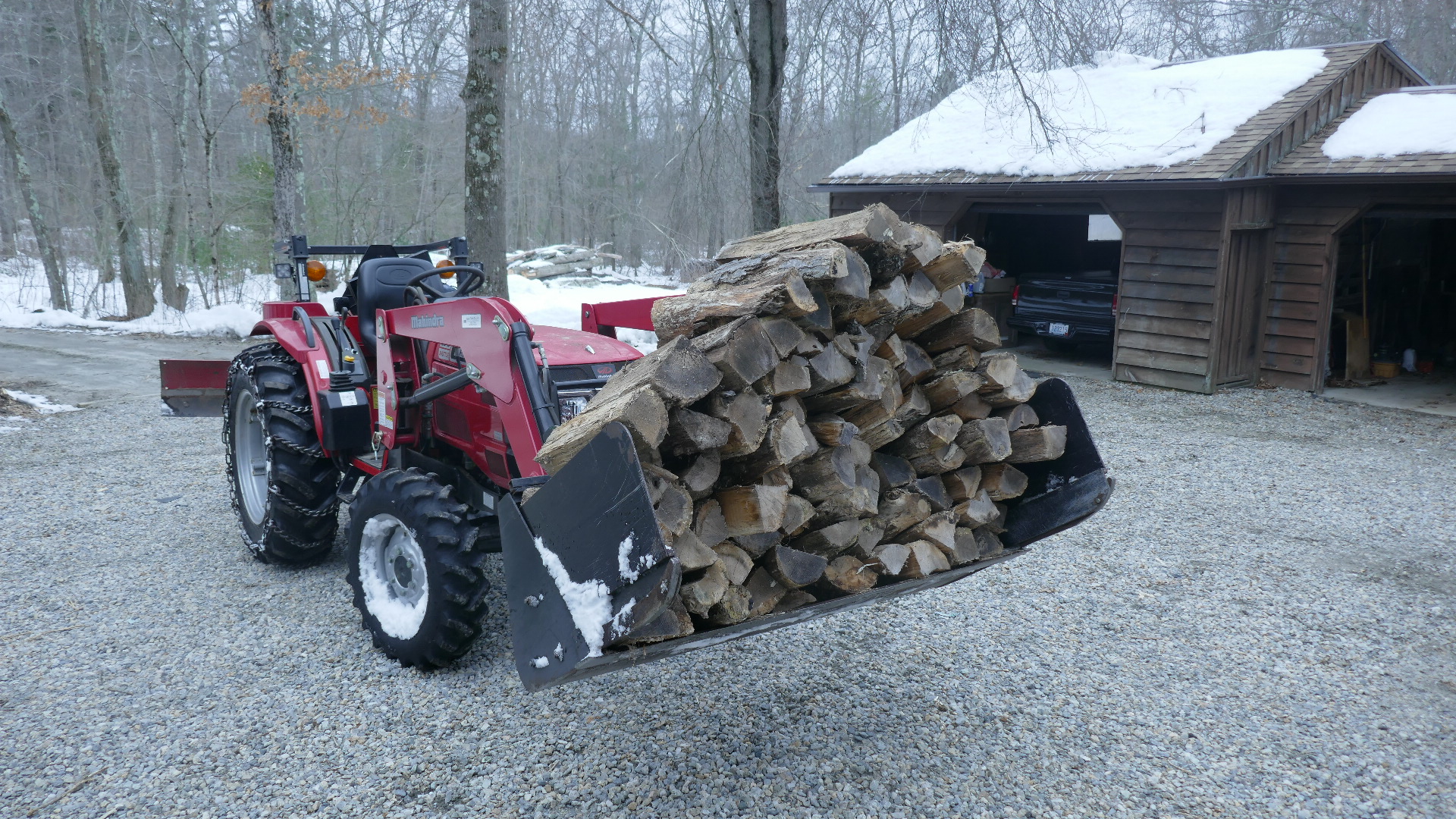

What is displayed in this pic is 5 days worth of wood burning 24/7 with an "air tube" wood stove placed in the basement heating about 1800 sq ft.. This is with temps 18*-40* and is mostly red oak. Just with wood, I can keep the house between 65*-68*.
I am thinking about getting a gassifier wood furnace mainly for its ability to extract as much heat energy out of the wood as possible. This would be at least an 8K further investment as I would also have to mount ducting in the cellar.
Right now I do not know if it's worth it. I do not buy my wood but harvest all of it myself. I may burn wood for another 10 years. If a gassifier would not save at least a cord to two cords per year, then I don't think it would be worth it. Just wanting to hear what amounts folks are burning with this type of wood burning gassfier. Right now using around 5 - 5 1/2 cords yearly.

Well let’s see- $8000 to save 2 cords (max) a year for 10 years. That’s 20 cords of wood for $8000!!!!!
I’d save my money and effort and blow an extra 6-12” of insulation in the attic- 75-80% of heat loss in a typical home is lost through the ceiling. Just my SWAG
   / How much wood #3
I agree with Neumann, 8k to save maybe 20 cords. that's valuing the cords at $400 each
and there will be no "added value" to your home with a 10 year old wood burner in it.

It looks like you have 79-80 pieces of wood there. For 5 days, that's about 20 pieces a day.
We heat our house primarily with wood and the most I've ever burned was 6 cords one year. So I burn about 5 cords on average. Very similar to you. I burn about 36 pieces per day when its cold out, less when its 20-40. So I'm guessing we are about the same.
