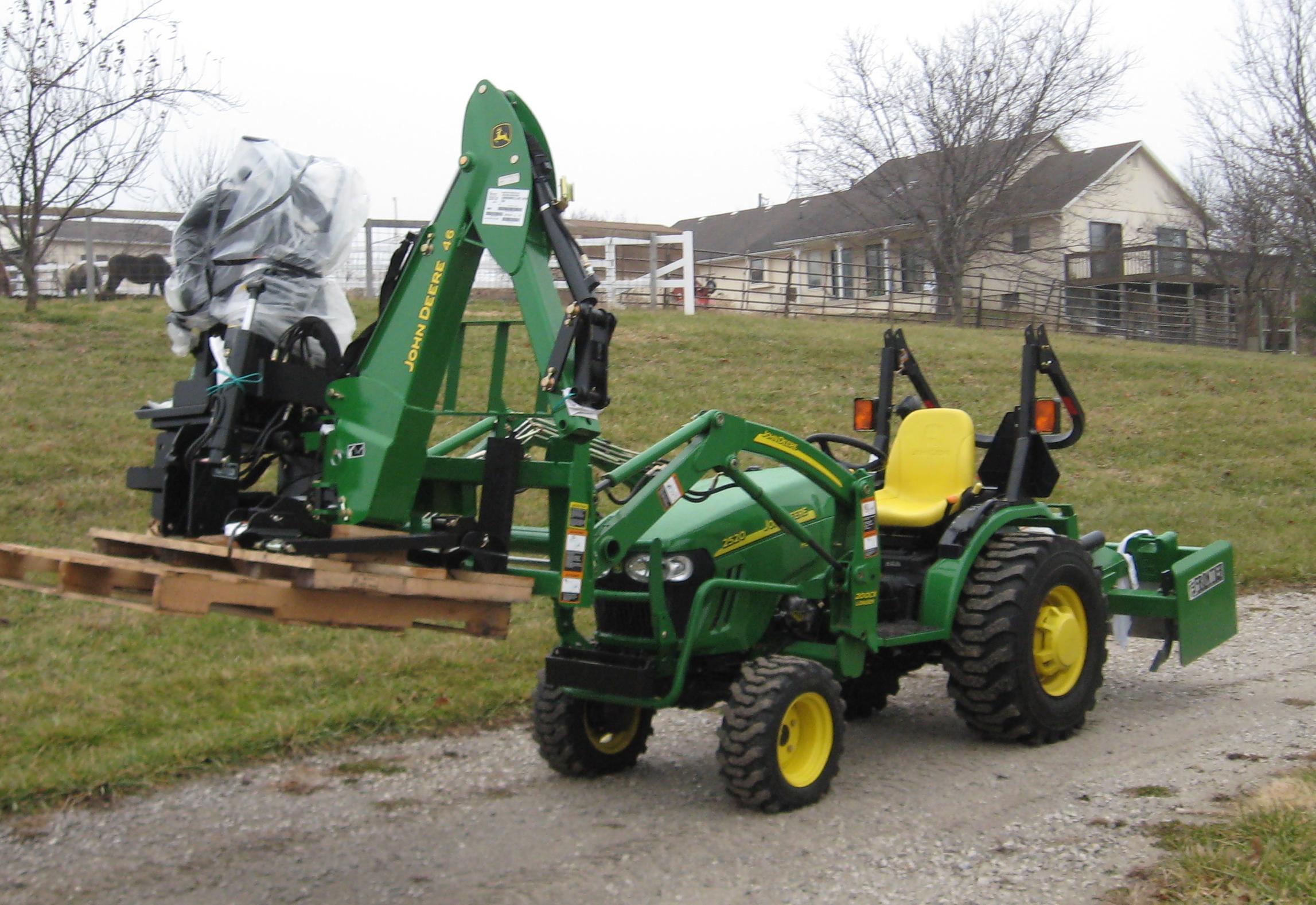

I lifted my 46BH out of the back of my truck with my Frontier pallet forks. I believe the sticker on the hoe said 759 lbs and the forks are approximately 380 lbs, so you should be able to do it.
Might want to double check the deck construction to make sure it can handle the load....
