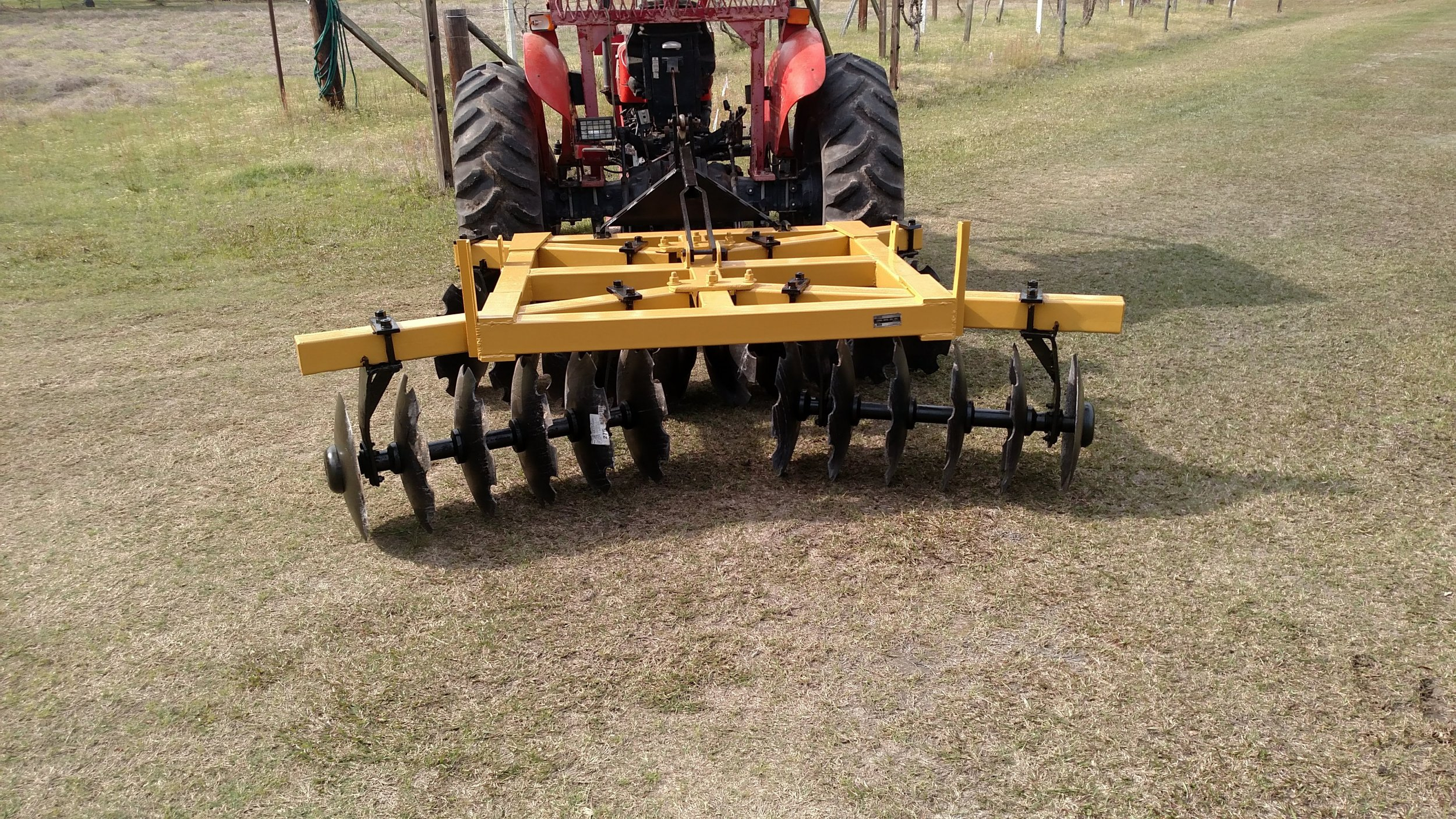

I can only guess what the belly pan and top adds to mine in the front, but I also keep a chunk of railroad iron, bottle jack and about 75ft of chain piled in the front of the pan. I can lift and pull my 8ft set of Long harrows with the added weight.
I think like mentioned 500lbs would be a good place to start..
Do you have your wheels out for added width stance? If not I would look into that also.
