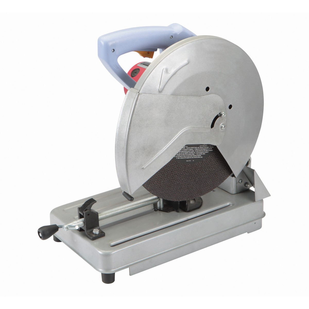

Anyone know if a Harbor Fright HD metal cutoff saw will make it through 2.5" of steel? :confused: I have a buddy with a welding shop and he probably has a bandsaw that would cut through them.
I think you'll do better using your buddy's bandsaw.

Here's my saw. It cuts pipe and whatnot like butter but I'm not sure about these monsters.

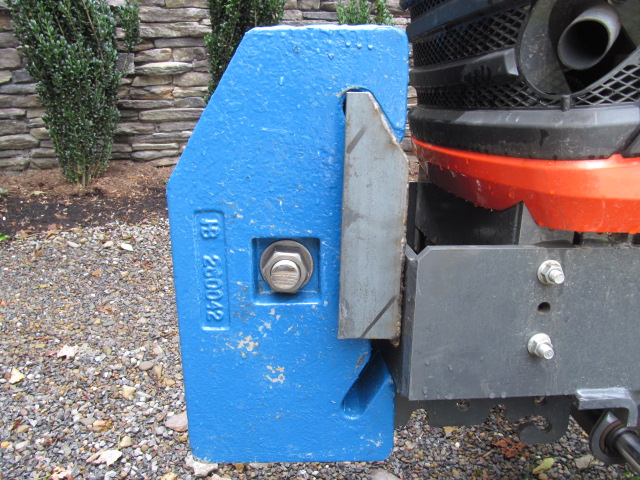

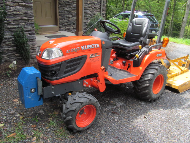

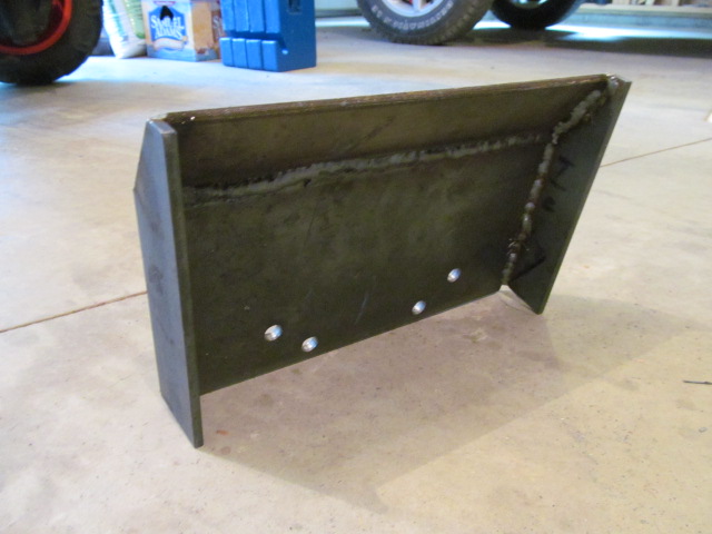

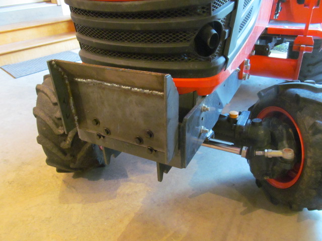

I gave up on cutting the weights and instead, I fabricated a bracket out of 1/4" steel for the front which lifted the weights up. Here are some pics of the bracket and final setup! :thumbsup:
/ How much weight do I need on the front? #39
Very nice setup. :thumbsup:
As to using the "search feature", occasionally you will get that, but my assumption is that has been tried already without success. I have used that feature, but you can spend literally hours sifting through stuff unrelated until you stumble onto it where a member can often very quickly point you in the right direction.
#40
Looks good! Nice work...
Thanks. I'll probably paint the bracket and maybe the weights on down the road. Too far behind on hogging right now to get fancy! :)
