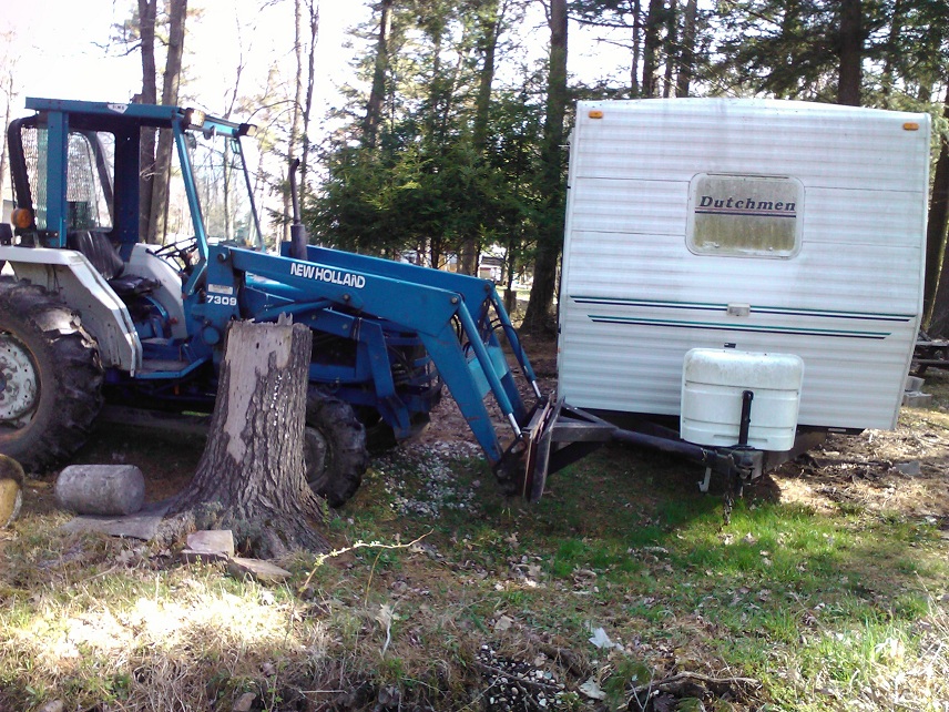

A friend made this attachment for me last year. I can't believe how much I use it.

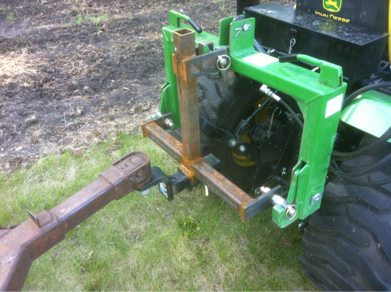

If I remember right my JD 2520 has a 1200 pound 3 point capacity. As most trailers aim for 10% tongue weight it would easily handle your trailer. I have moved a 5000 pound travel trailer around the yard with it. It doesn't even feel it, but it is tough to back up as I don't have wide mirrors on it. I made a 3point trailer hitch, so I can just lift the trailer to move around the yard, no jack cranking required.
Sent from my iPhone using TractorByNet
