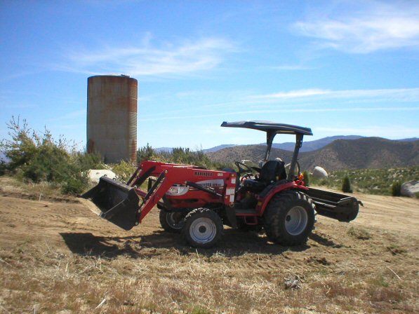

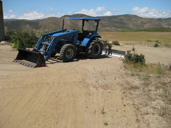

My first purchase, a 7520 4x4 back in Dec of 2004 and with my second purchase of a 3215HST in Dec of 2008, I have had Zero mechanical down time. Maybe I'm just lucky, but I sure am happy with my 2 Mahindras. :D
I'm guessing that you are still having problems? :confused:
