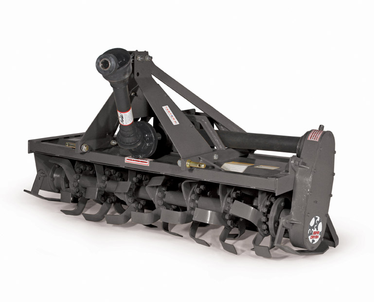

Does any one have a 6 foot tiller that they use with ther 4025? I would like a 6 foot wide model to cover the tractor tracks. Or should I go with say a 4 1/2 or 5 foot model that offsets. The soil is sandy lome with very little clay and a few moles. Just want to know if the 6 footer is pushing the limits of the tractor. Have priced several brands and does one stand out? I have pretty much decided to go with gear drive unless chain is acceptable with my soil type.I have no problem moving slowly and taking my time. Any help would be great.

We have the New 6 ft Tarter geardrive for $1795 + about $165 shipping to a business address or picked up at the truck terminal. We also have the New 6 ft Hawkline Geardrive for $1695 + same shipping. Both have the slip clutch and series 5 driveline with 6 blades per rotor. The Hawkline is approx 800 lbs and the Tarter is about 700 lbs. Ken Sweet

I am pretty sure that with your conditions, your tractor will handle a 6' tiller without problem. My 3215 handles a 58" tiller without any problems, at times I wish that I had gone with a 6 footer.
