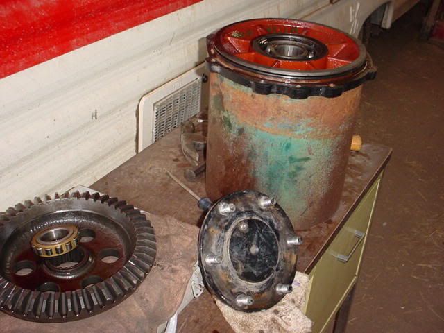

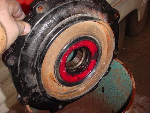

On my Jinma 354 there are grease fittings on the front and rear axle bearings somewhat similar to your 284. What I have found (on my 354) is that those bearings are immersed in the differential lubricant and those fittings do not need any grease at all. All the grease that gets pumped into those fittings just winds up mixing with the front and or rear differential fluid. To verify my statement is correct, take one of those fittings off, poke a wire into the grease "dam" that you created, and see if the differential / axle fluid starts coming out. I stopped greasing my axle bearing fittings years ago knowing these was no need to do so.
Here is my proof:
OK the red grease - Those Zerk's on the front and rear axle that everyone wonders where the grease goes? It's supposed to grease the front and rear wheel bearings. Not needed, I see absolutely no reason to grease those fittings, there is plenty of gear oil, in fact the bearings are swimming in gear oil so the grease does nothing except mix with the gear oil and eventually dissolve away into the gear oil.
Keep in mind this is a Jinma 354 so any other tractor may be different.
Larry
