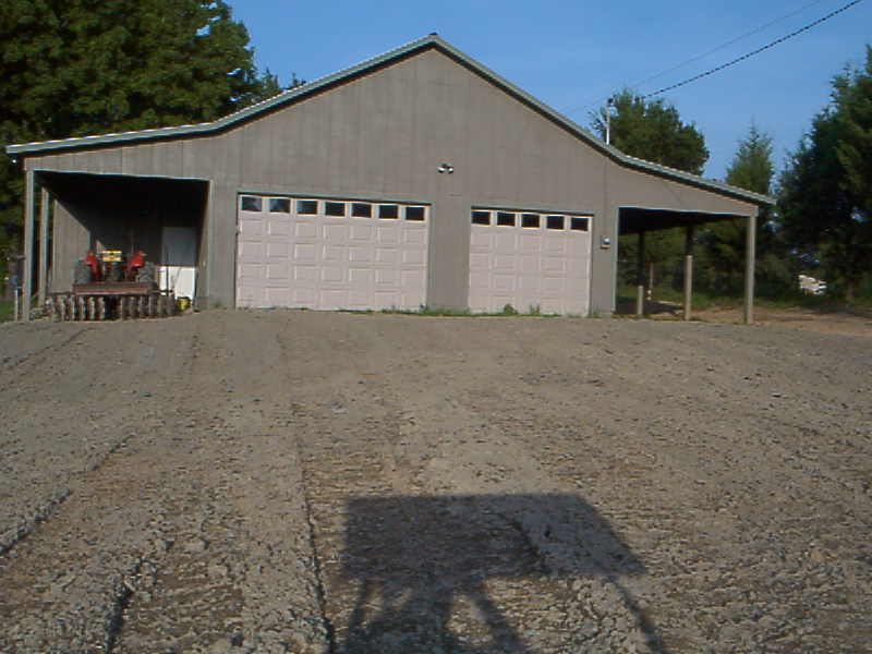

I did this one which has 30X 30 main shop with 8x10 bathroom on the left side, 12 foot wing walls on each side for $25,500 a couple of years ago. I built it prior to building my house so I could store my tractor and other stuff there and get out of the rented storage building business. It is completely insulated walls and ceiling, interior walls and ceiling is sealed with 3/8" plywood and has full 100 Amp electrical service, receptacles every 8 feet on every wall, lights (about 10 of them), insulated 16 foot and 10 foot roll up doors (16 foot has garage door opener. Price did not include hook up to sewers for the bathroom, nor the crushed slate for the driveways. . It has concrete slab everwhere except open sheds. Roof is 22 gauge galvalume steel and it is made of 2x4 construction walls 9 feet high with one course of CMU blocks around the perimeter to give me 9 feet 8" ceiling height. The middle portion of the attic is also floored for extra storage which provides a 12 x 30 attic space.
