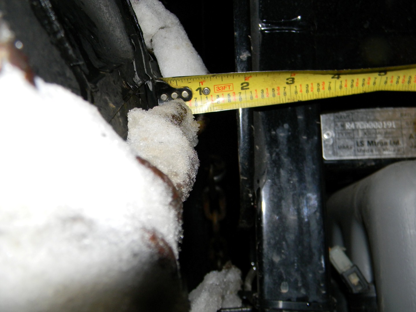

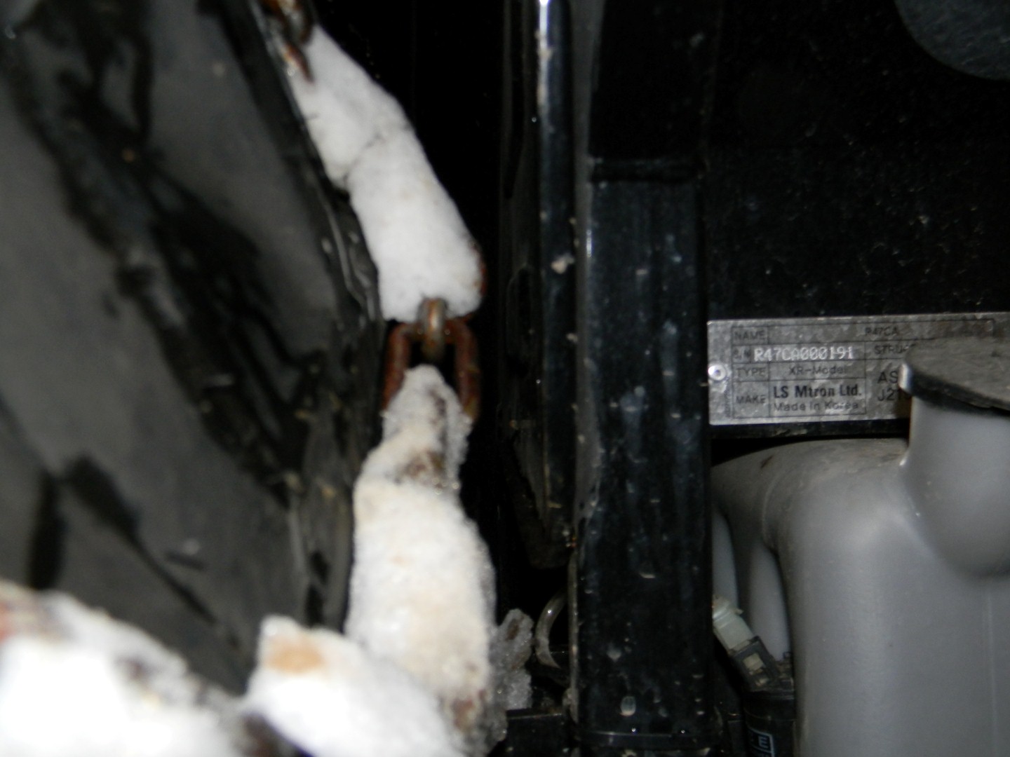

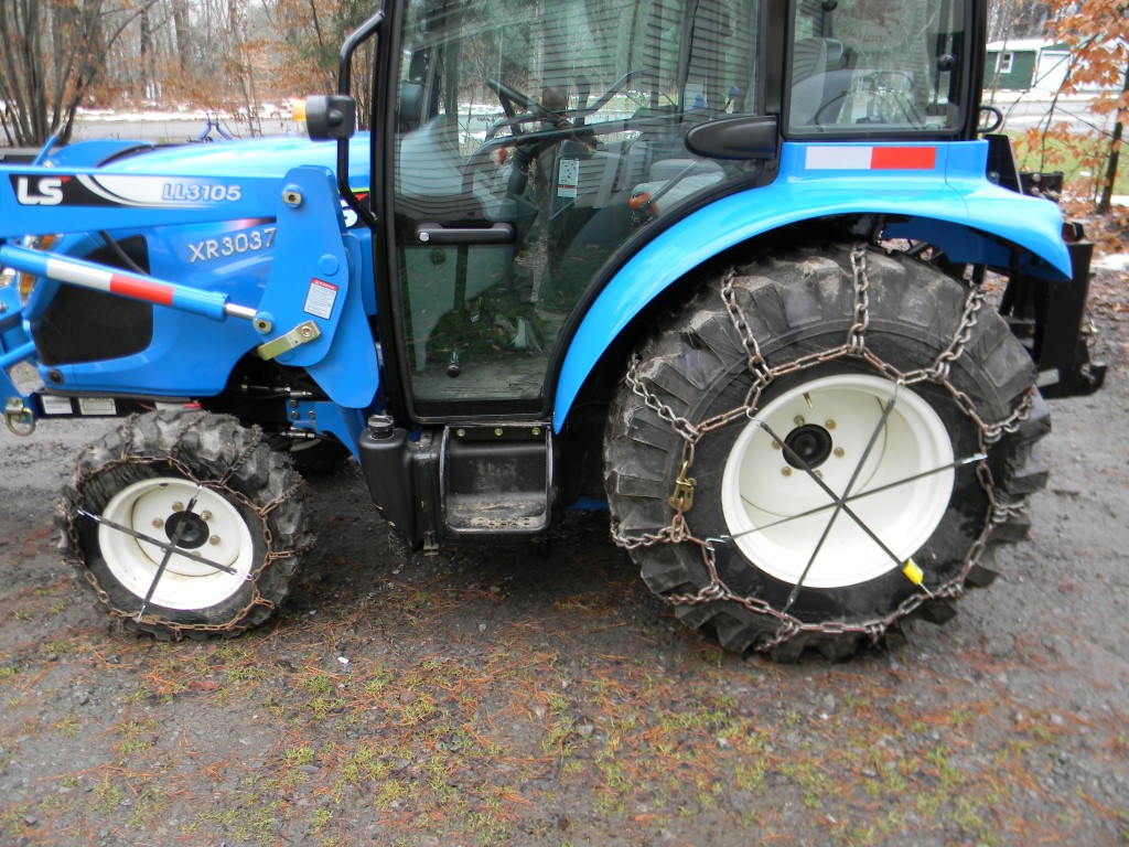

I have the same size rear tires. I've been running 4 link ladder chains all winter so far and have not had any problem but I keep the chains tight with bungees. I only have 2" between the frame and the tire, a little more on top. With the chains on I have about 3/4" between the chain and frame. I may get some 1" or 2" wheel spacers for next year. You have 1/4" more than I. I guess it will depend on the type of chain you use. I run V bar chains on the front.

I run 3 link ladder ice chains and can barely place my hand between fender and tire without scraping my knuckles.
While my top speed is in the 7-10 KM/hr I very rarely have a cross link make contact.
But then I have good tensioners installed.
